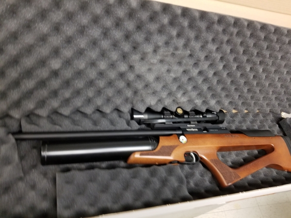

I bought the Brocock Bantam in .25 Cal and upon receipt it had an air leak, so back to AoA for repairs. I hadn't shot it at that point. The scope is at home and I'll get it remounted.

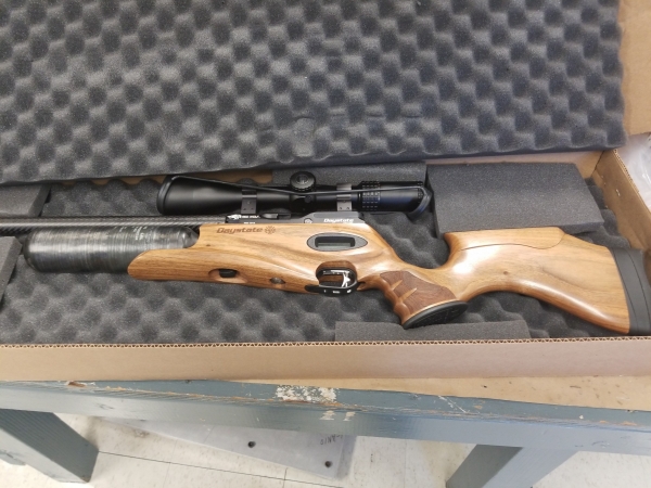

I also got a wild hair and bought a Daystate Red Wolf wood, .22 Cal HP, with a Hugget and Aztec Scope. It sure is pretty. Now to run some pellets through them, I'm sure they are very different from the Red Ryder I shot last.

The wood work is beautiful on the Red Wolf and the Bantam is very nice as well. Thinking about getting some Gold Testers Model paint and filling in the Daystate lasered areas as well as the ones on the Bantam.

I put the scope back on the Bantam, and set the eye relief. The Bantam really handles well, single handed hold in my shoulder. Moving it around it smooth, not to long in length. I'll be setting up a night scope using a Back Up Camera setup. Hopefully I can do some pest control at some of the local (less than 2 hour drive) farms. The rifle weighs more than my 30-06, which is a sub-moa rifle. I've held 5 shots in under 1" at 200 yards with it and 4 of the shots were less than 0.75".
The Red Wolf .22 HP is LONG, and has a heavier feel. Slower to shoulder and move around, definitely a bench or support shooting. Love the trigger, pulled it a few times without firing. The Cocking lever is super smooth. Need to set the eye relief and make some adjustments to make it more comfortable to shoot.

Here is the .25 Cal Bantam, I wish I could work with wood to make it so pretty.
And here is the Red Wolf in Wood.

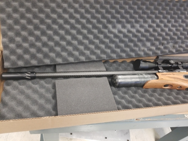

and the front end.

Yes, the Red Wolf, especially HP version, is a very long and heavy rifle - a bit unwieldy (comparatively speaking), but quite well-suited to the bench!
Your semi-bullpup Bantam, on the other hand, is great for mobility and maneuverability. Very versatile. It can shoot well from the bench also.
