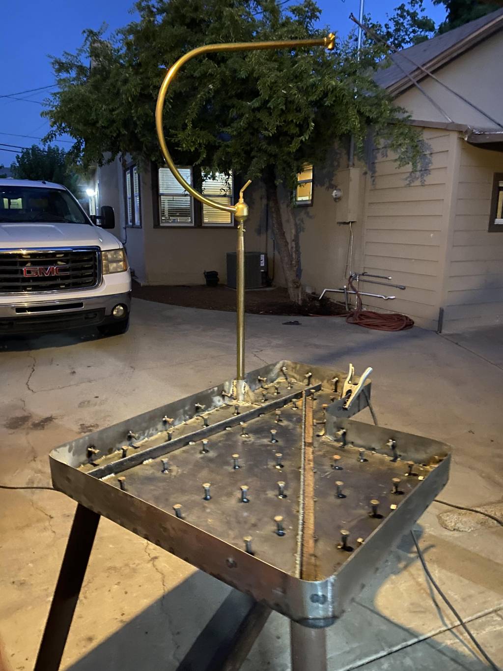

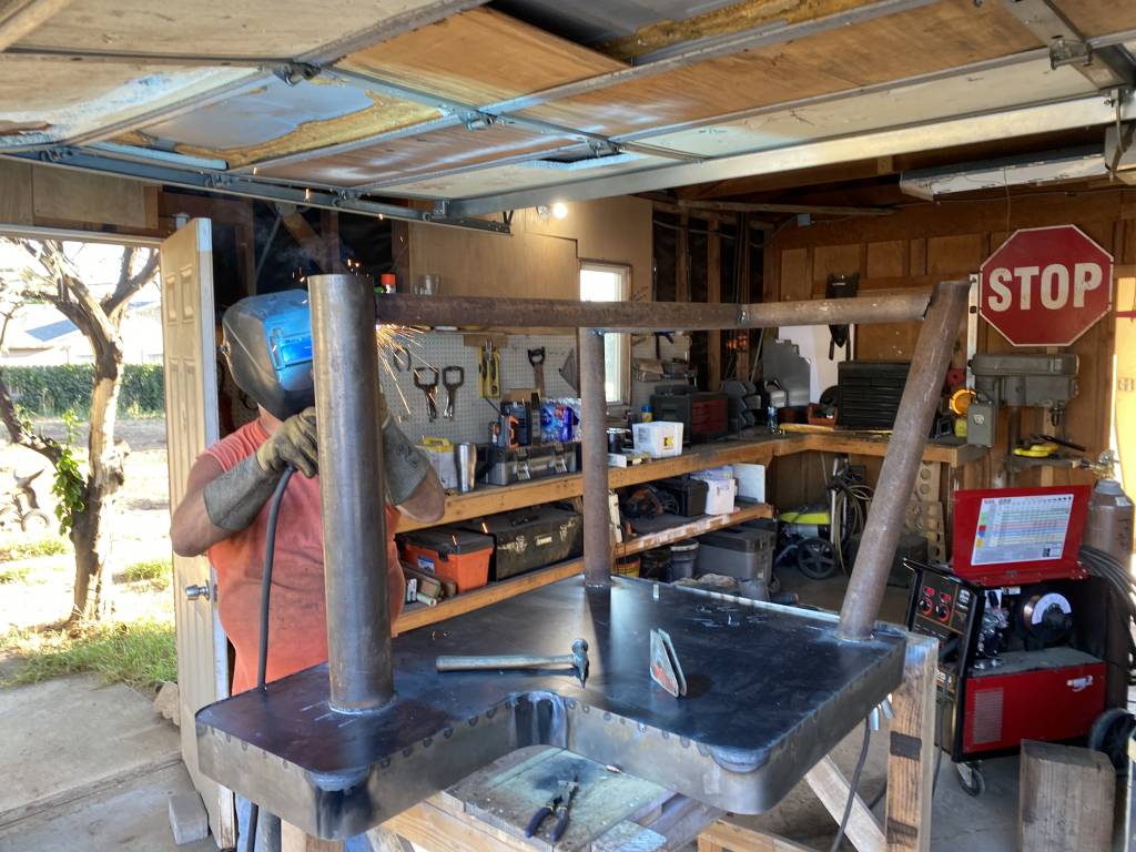

I won’t be able to blame missed shots on the bench. 4 inches of concrete wrapped in steel with 4 1/2” & 3” used oil pipe legs. And a tractor supply tractor shade.
I am a certified welder, machinist, blacksmith / blade smith, You did a great job! All you need is a swing out tray under table to hold stuff and a soft rubber or foam coated rack on the straight side to hold extra guns, The beauty of that design is you build the frame then put it in place then pour concrete in the base / form ,Thanks for sharing, A+ MM
Thank you! The swing-out tray is a great idea; I'll add that on the next one. I think 1/4" plate would be plenty sturdy by itself, but where I'm from, you could fry an egg on it most of the year, that's why I opted to fill it with concrete.
