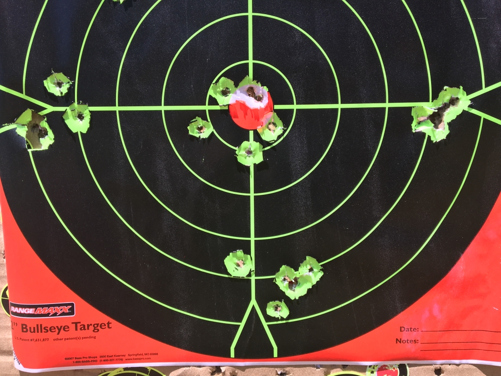

Bought a “BNIB” .25 Cricket pup on AGN Classifieds this past week. Intention is to power tune and do a run off with the .25 Heavy at approx 940 FPS against my .30 Bobcat at 880 FPS at 100 yards in the wind in preparation for EBR. So, after getting the gun USPS, and doing a quick barrel clean, I installed an Ernest power plenum, left the reg pressure as delivered, and reassembled the gun. Over the Chrony, Mk2 Heavy at 920 to 925 FPS, Kings at 1015 to 1020 FPS. Not yet where I want, but close and will only take a little valve transfer port shaping and tuning, maybe a small step up in reg pressure.
On to shot progression... Mount scope, sight in gun, shoot some groups. I’ve owned 4 Crickets in the past (all used) and everyone has been a laser beam
The seller told me he’d only shot ten shots and gun was otherwise new. I shot 25 or so shots the day I got it to check speed and then another 20 after I installed the plenum. So to this point 55 shots on the new barrel. Today, I shot about 6 or so sighting then gun in, then shot these groups. First middle, next bottom, then left (6 shots each). I actually got a little disgusted and shot about 3 magazines (36 shots) at some spinners 30 to 85 yards. Then back to the target, where I shot a full magazine (12 shots), the right group on the target. Much better!
Maybe it does take time and 100 or more shots to “lead in” a new barrel? All groups with Mk2s. This is the first time I’ve experienced such dramatic differences from a new barrel, but then I haven’t bought any “new” guns since my .22 Daystate Renegade three years ago. Anyone else have this experience?
Target at 50 yards. In chronological order: center, bottom, left, and then right. Light wind from over my left shoulder

Yep Mike it definitely looks like you had to dirty up the barrel before she would get accurate. Don't ever clean the barrel until your group start to look like the middle one again then just give it a very light cleaning. To me this is like seasoning cast iron skillets and yes it does take time
I agree with chuck, there's a fragile balance of clean and and perfect. I've seen where it takes over 300 pellets. To get perfection. I don't reclean the barrel until the group start's opening up.
I've got a Cricket .25 that always took at least 200 - 300 rounds to become accurate again, after a serious cleaning. Not a myth.
