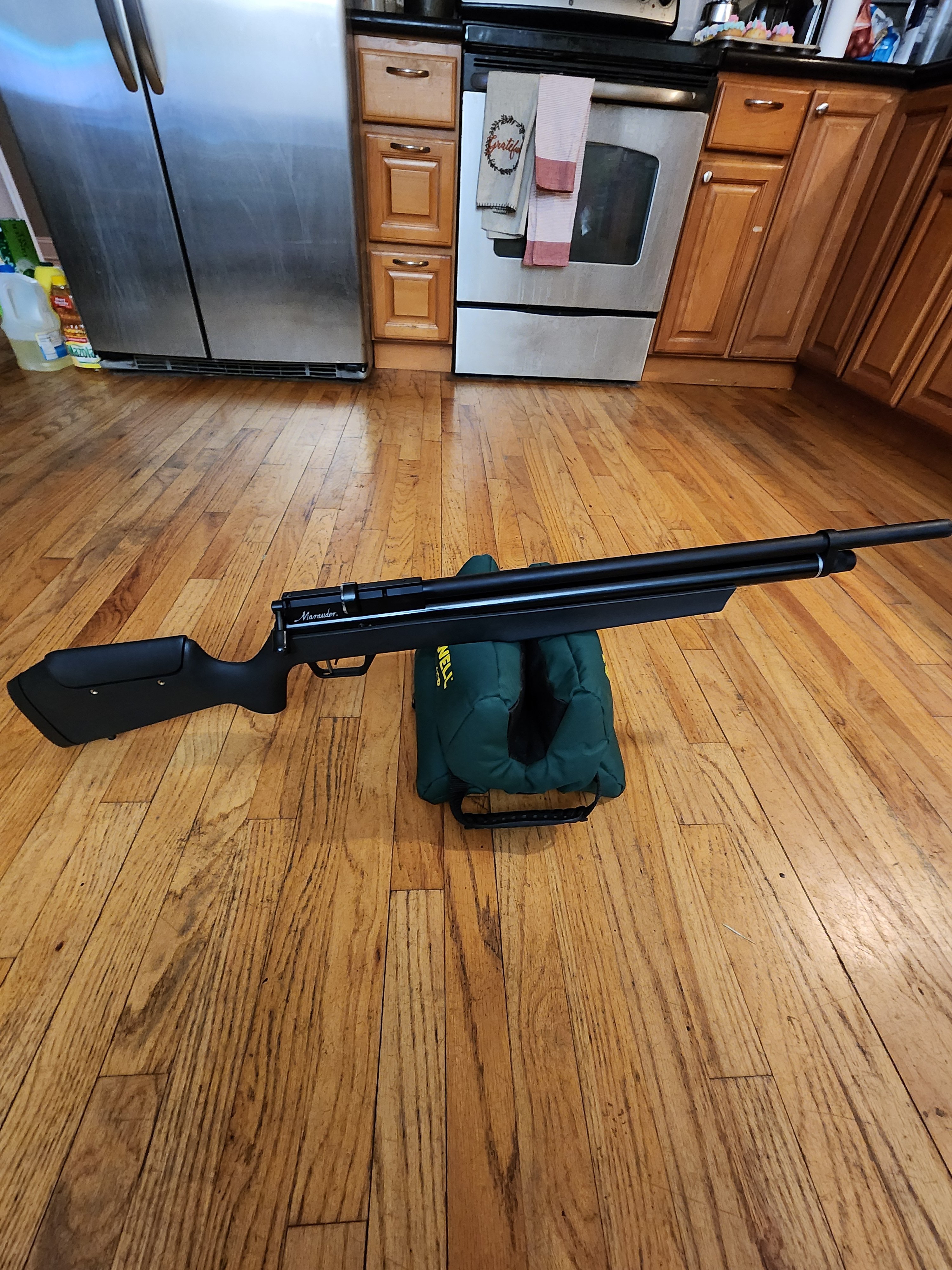

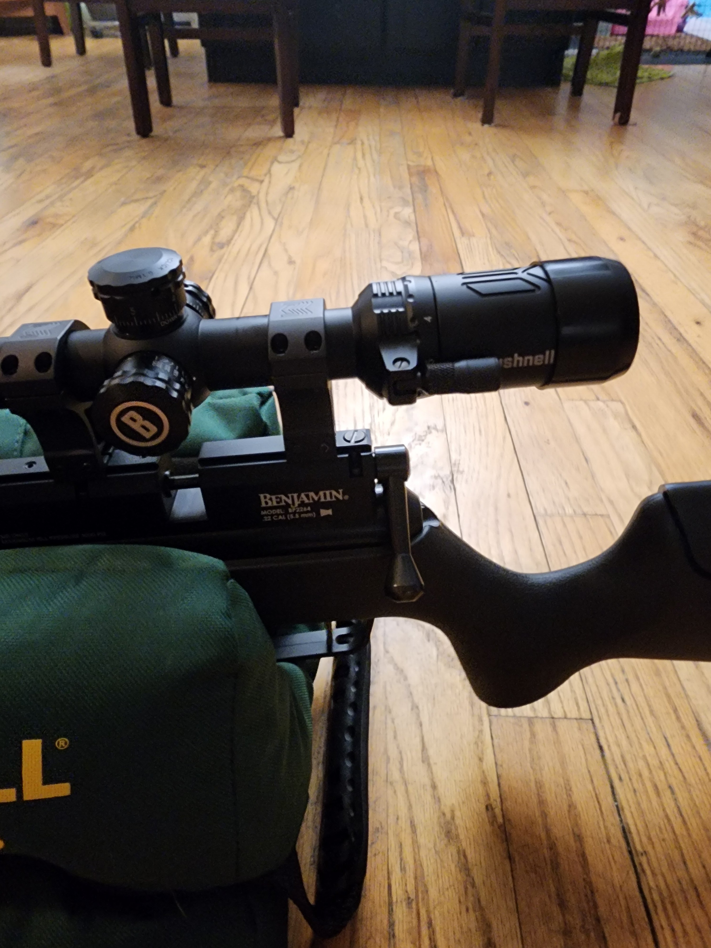

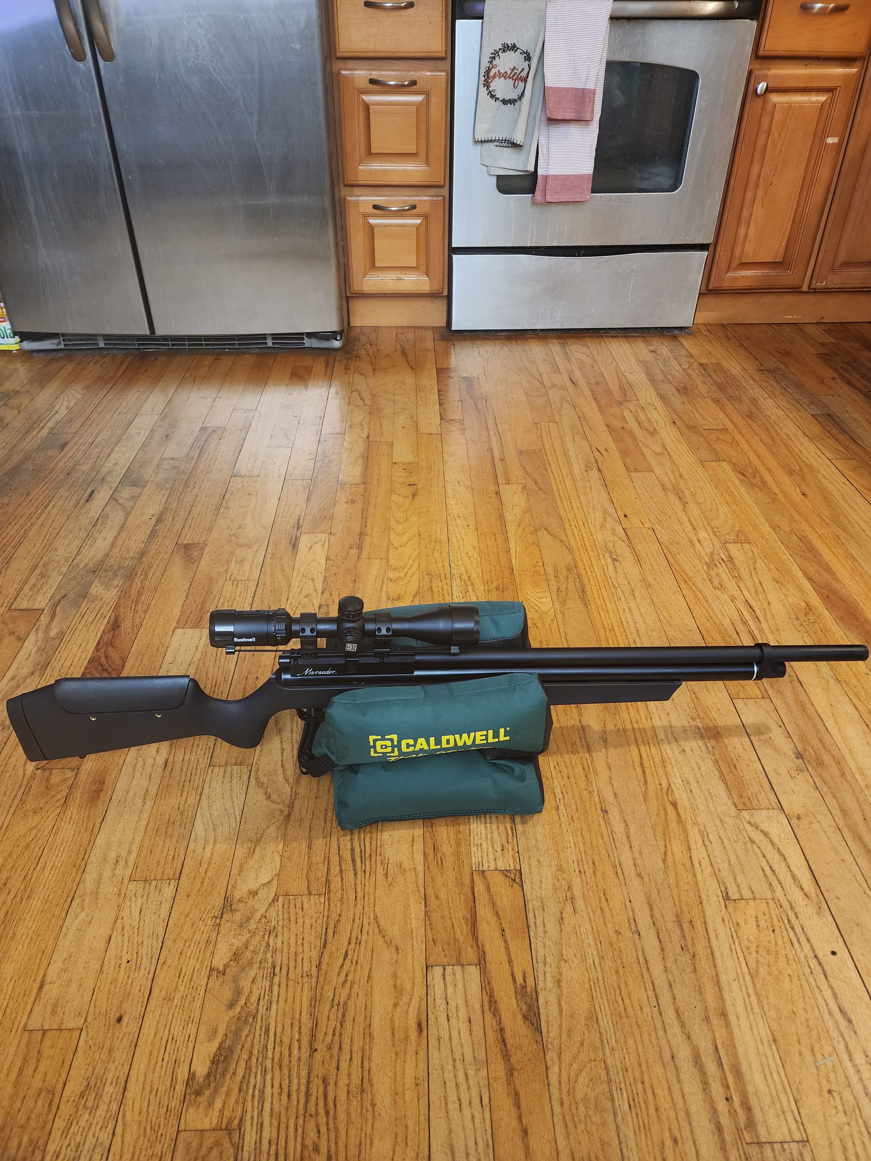

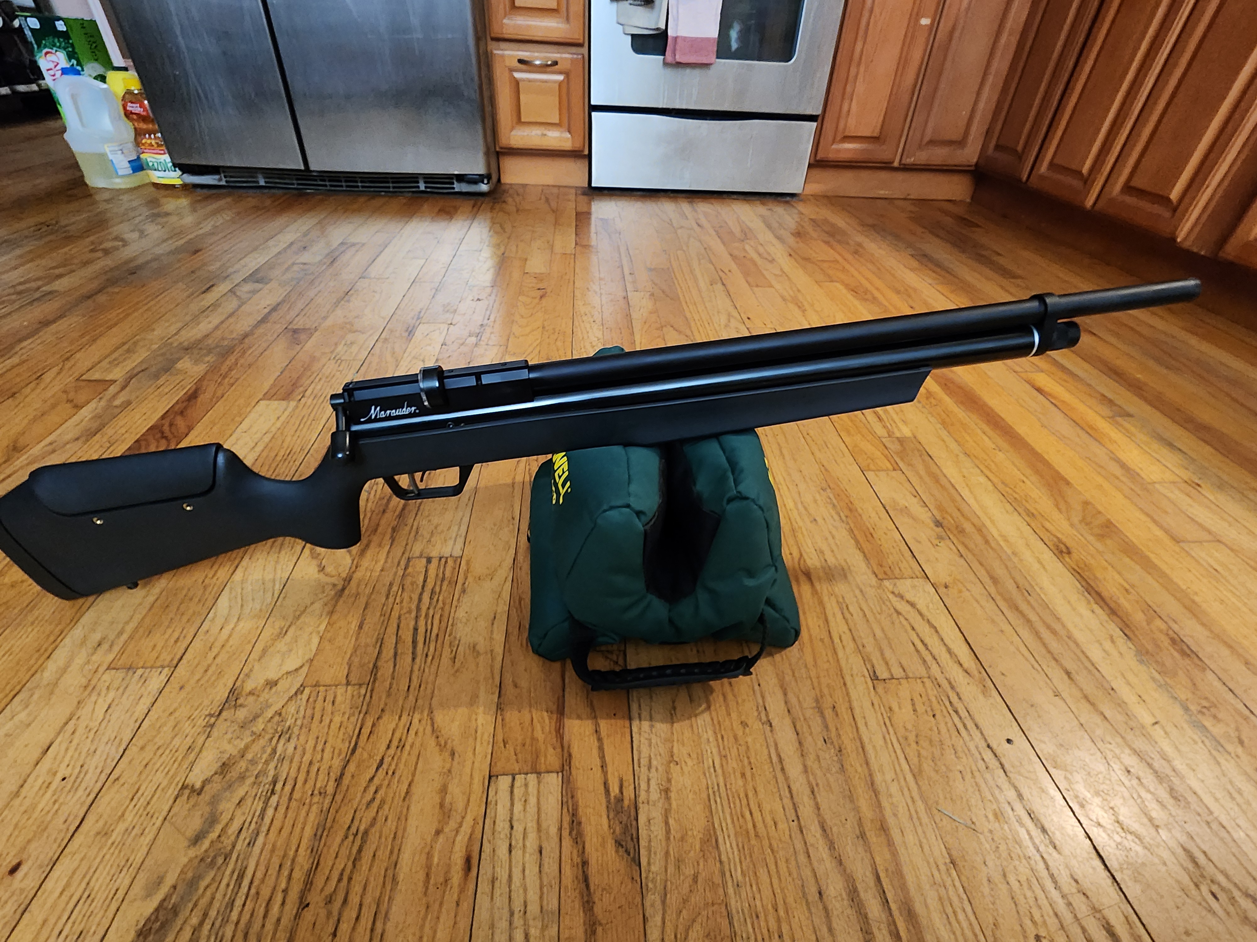

I have a new Marauder that I got just before Christmas. This is my first air gun so I don’t have knowledge of how other air rifles sound, but I can agree with others on here that the Marauder is very quiet. I think the gun is heavy however. At least as compared to my powder rifles. Mine is the walnut stock model so I don’t think it would meet the $500 max price limit.

im going to try the synthetic stock after reading that alot of people do prefer the synthetic stock on this model as they say the wood one is not very well made? plus is on my price range

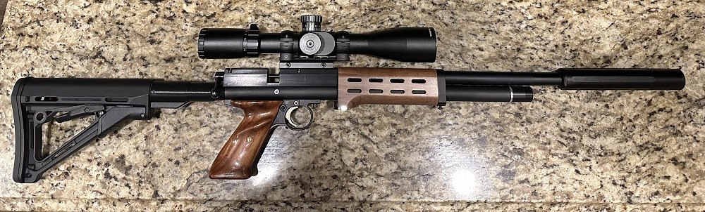

Yes, PCP rifles, just about all of them, need to go on a diet. I do have aluminum tubes on two Marauders and a hybrid aluminum/steel on another and the weight is below 5.5 pounds and with a cut down shroud under 39 inches. But, the OP is probably not ready to start modding before he starts shooting ;).

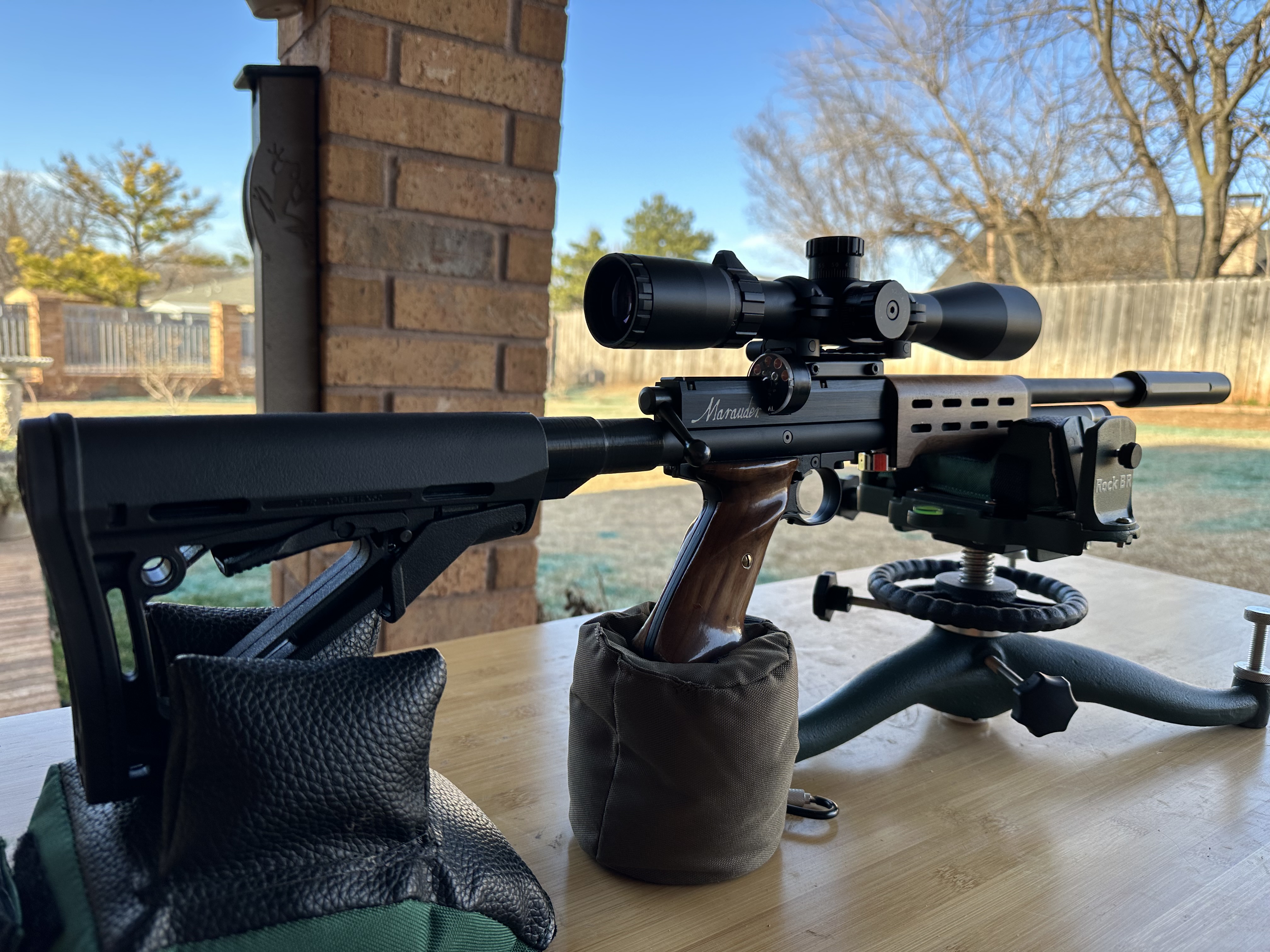

Really, the only basic improvment Crosman could make that would satisfy a bunch more shooters is to add a freaking side lever! But the bolt is fine and can be easily swapped side to side and unless you start putting in heavy power springs and going down the rabbit hole, the bolt is dandy. One of mine, JSAR aluminum tube, "special" tech valve, Houma reg., .196 porting, .25 cal, 60 fpe, standing on Blue Bird overwatch duty:
Looks just like yours :). But it ain't ;). Can be pinky cocked :cool: because the special valve requires little force to open and the FFH is lightweight Delrin type material. That is the beauty of the Marauder.
