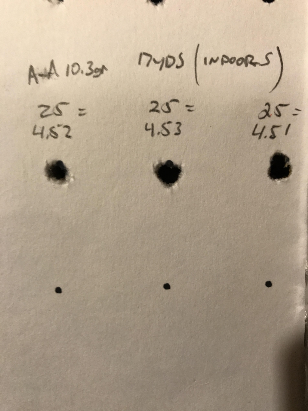

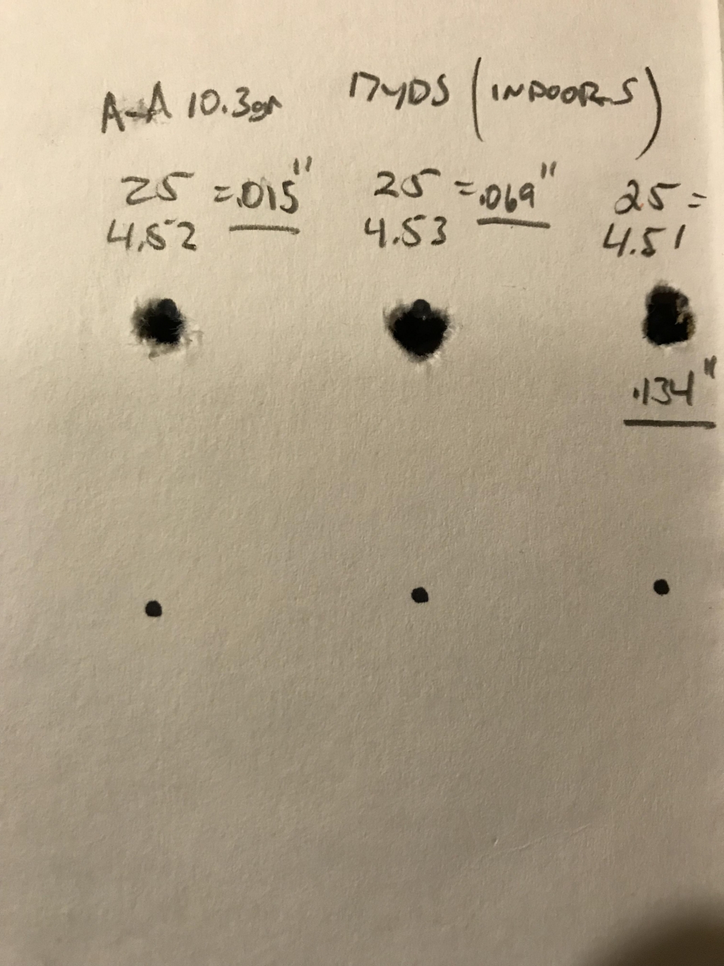

Actually STO, I was trying to point out just the opposite... ( these groups are not even close to being the same! ) even at 17yds the groups open up when you shoot pellets that the bore doesn’t like ie- 4.51 head dia. Will not group well out of this barrel but 4.52 dia. Does, but only with the AA 10.3’s, jsb’s 10.3’s seem to group with head dia. 4.53( now before you blast me that AA & JSB are the same! I know... but this is what I’ve found in this barrel?) I know @ 25m this barrel will not group acceptably for competition(with 4.51 dia. pellets) but this is different than a flyer, maybe my definition of a flyer is different than yours? And I’m fully aware of external environmental factors playing a pivotal role in grouping vs. flyer’s!, and the exponential impact of distance and time in flight these factors impose on any given projectile, including destabilization of projectile do to a to slow or to fast spin rate vs Weight/length fps of projectile especially at longer ranges! I try to remove as many variables as can when testing?, and I shoot ALOT to get a good representation of the capabilities of a specific rifle/barrel/ ammunition combination and this is quite honestly the only way to truly be able to distinguish a flyer from poor hold/bench technique,what the barrel prefers? clean or dirty pellet headsize,not reading conditions properly,etc.etc.etc!
