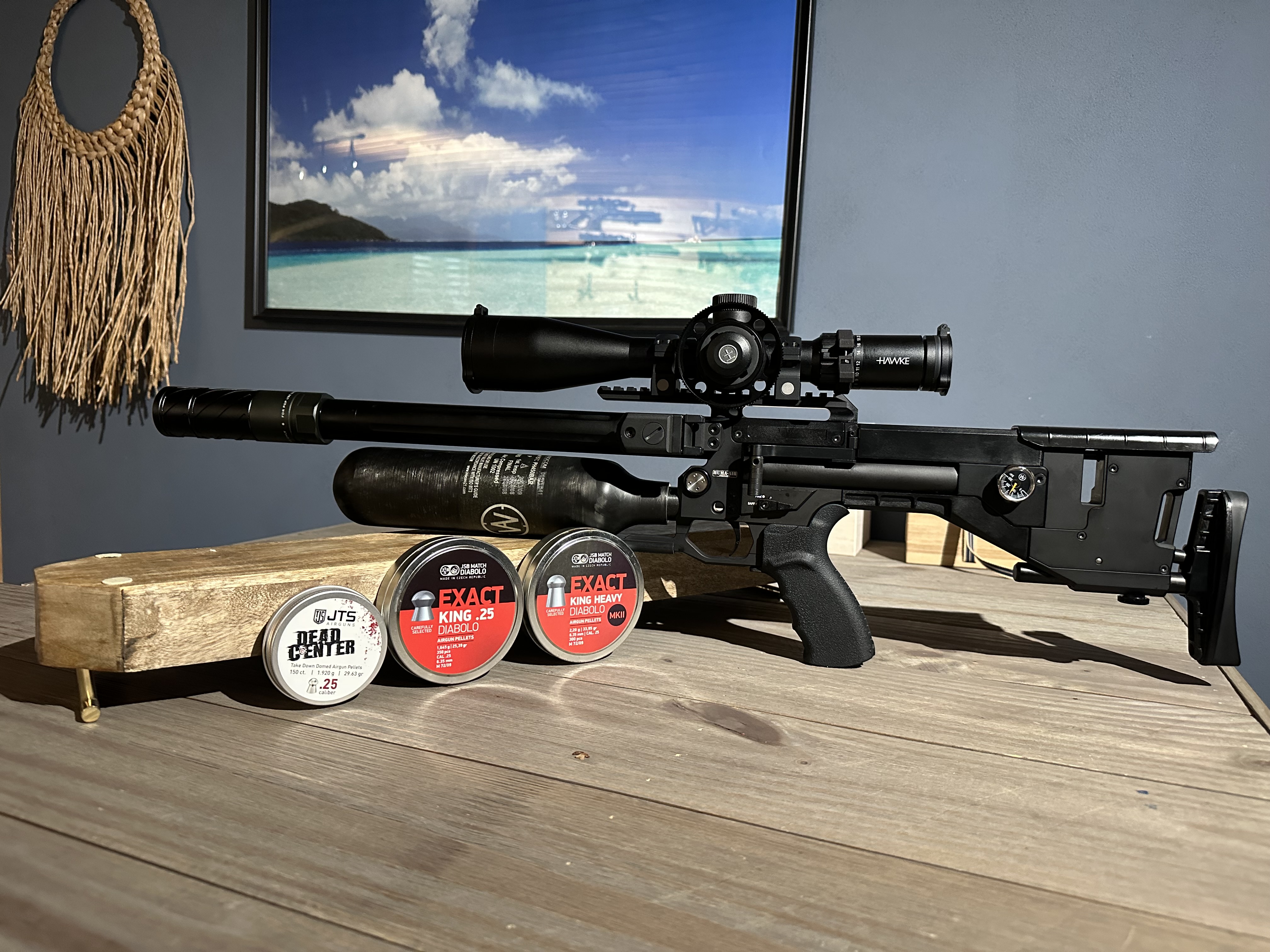

These new Krait with new regulator and redesigned magazines fixed a lot of issues of the past. So far, I am very pleased. And I own a lot of Airguns. I liked the gun when it first came out and I’m glad I waited for all the bugs to be fixed.
My two Kraits, .22 Compact and .25 L. Been waiting for my scope and moderator to come in to put everything together and that was today. Originally had the Impulse IA-1200 moderator but need more noise control and went with Donnyfl Yokozuna. Airmaks Krait shoots like a dream and very light weight for walking the woods. Thanks Airmaks! Continue making great Airguns.
Krait compact has won a slight edge over my Uragan 2 Compact.
Comparison:
Uragan 2 compact, 360mm barrel, 210cc tank & 2.7kg, 620mm overall length
Krait Compact, 400mm barrel, 300cc tank & 2.5kg with adjustable stock, side picatinny, 610mm overall length.

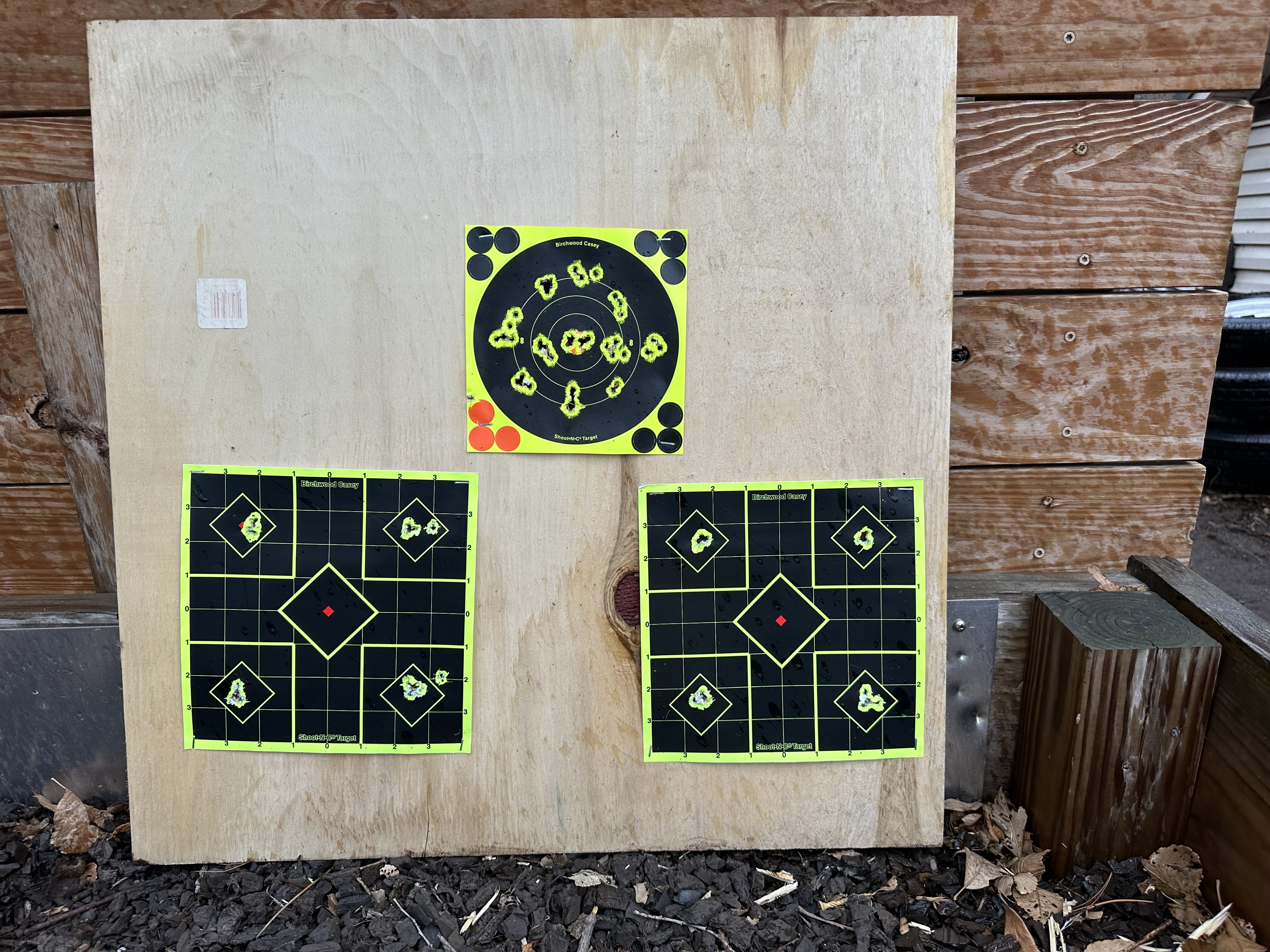

Pellet test at 30yds:
.22 Compact - 2 stacks removed, full Yokozuna
22.07gr JTS Domed. I really wanted the gun to like this pellet since my other compacts love them but did not group well.
18.13gr JSB Jumbo Heavy was the clear winner. (Forget to take pictures)
.25 L - 2 stacks removed, 2 Yokozuna stacks removed
25.39gr JSB King (top target) 3rd place. A few fliers .
33.95gr JSB King Heavy (bottom left target) 2nd place. A few too many fliers from the tin why I pushed it to 2nd place. Supposed I could pick the best pellets and I would avoid fliers .
29.63gr JTS Domed (bottom right target) 1st place. My pick. Out of the box, very few fliers, if any.
Comparison:

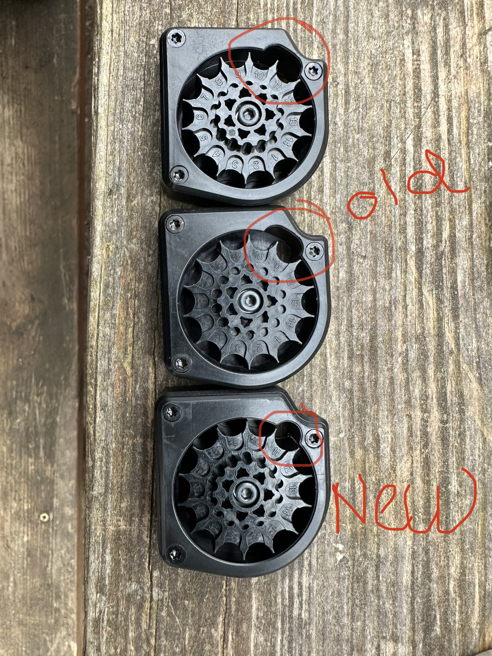

Love the gun but I still have an issue with the old magazines UA sent me. I ordered two extra aside from the one that came with the gun. The new magazine works flawless, cock smooth and effortless. The two old ones, UA sent new faceplates but they're still giving me problems (heavy resistance). Going to send it in this week.
You have an issues with your magazines?
If I may, what magazine problems ?
I bought a, .22 (compact) with a "second" design regulator, new from Utah Airguns.
I don't know what magazine that gives (new or original design) me, but I've had zero problems with feeding, pellets (only), in either magazine
Mike
I have the latest Krait with MK4 regulator. I have absolutely no problem with the new gun and new magazine design. It was the extra magazines I ordered. They’re the older magazines with the older faceplates. UA sent me new faceplates but it did not fix the problem. Problem I’m having with these magazines is great resistance when cocking the lever and forcing pellets into the chamber. I have two useless magazines now. I’m glad yours is working flawless
