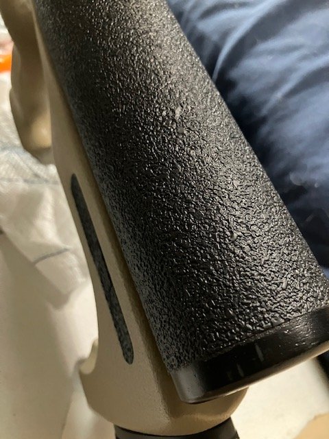

I just put grip tape on the bottle of my Talon P
