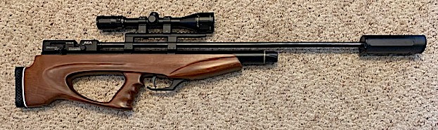

So I bought my 32" barreled .30 Challenger specifically to de-tune to more sane power levels and find a bell-curve power-band; rather than shooting over 1200 FPS in stock form, and each shot being lower velocity than the previous (that drives me nuts).
My Challenger now shoots with any airgun at any price. Here are the details-

Having found the bell-curve power-band at my desired power level came at only 120 BAR fill pressure, and the factory recommended charge pressure for the gun being 250-300 BAR, once my Huma regulator arrives (next week) I expect to get at least 25-30 regulated-consistency shots from a 250-300 BAR fill.
