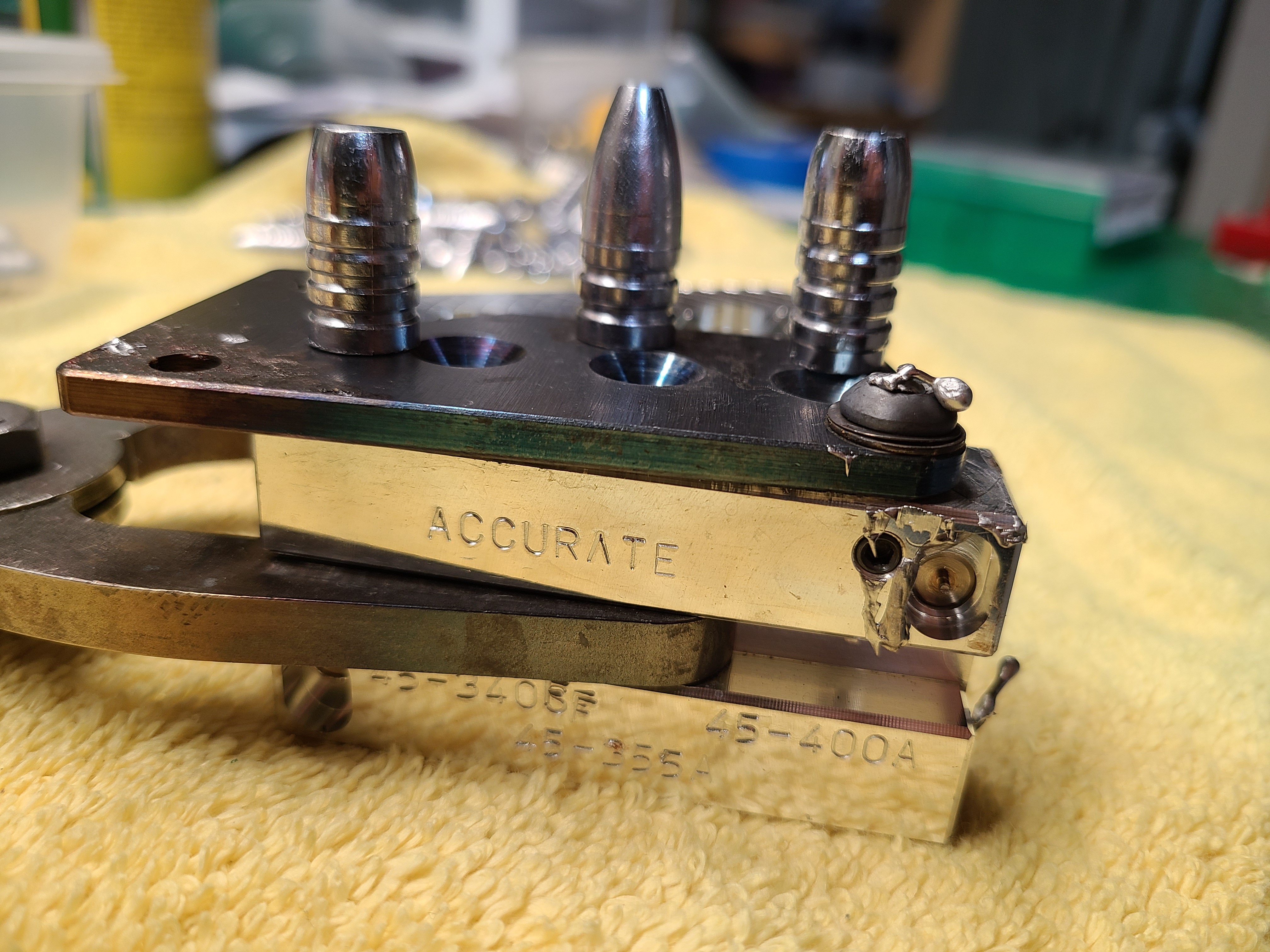

Just received a new mold from Tom at Accurate Molds. 3 cavity, 350, 370 and 400 grain bullets from the same mold.
Just experimenting with my Bushbuck Carbine. I will have some results on Friday.
