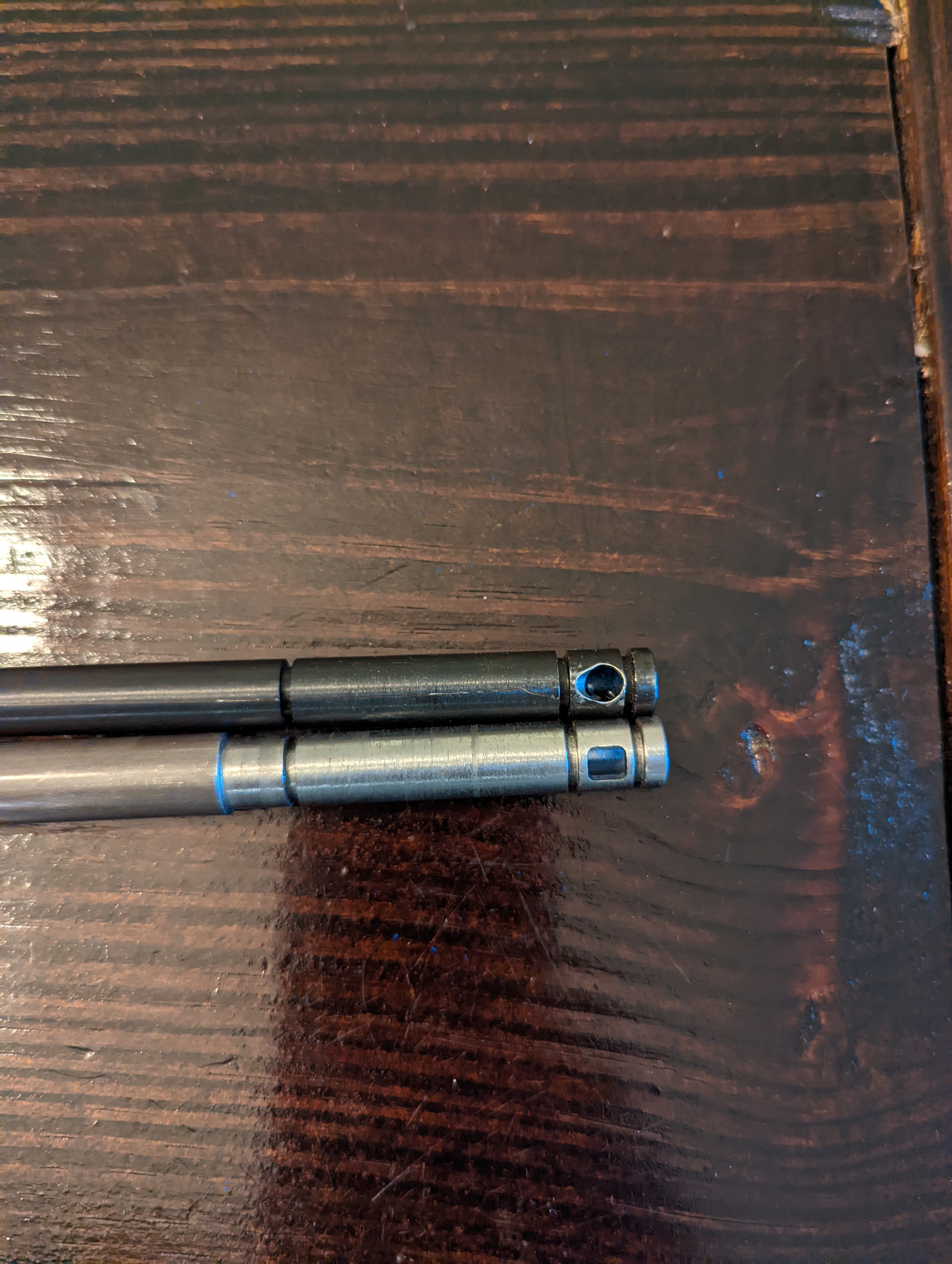

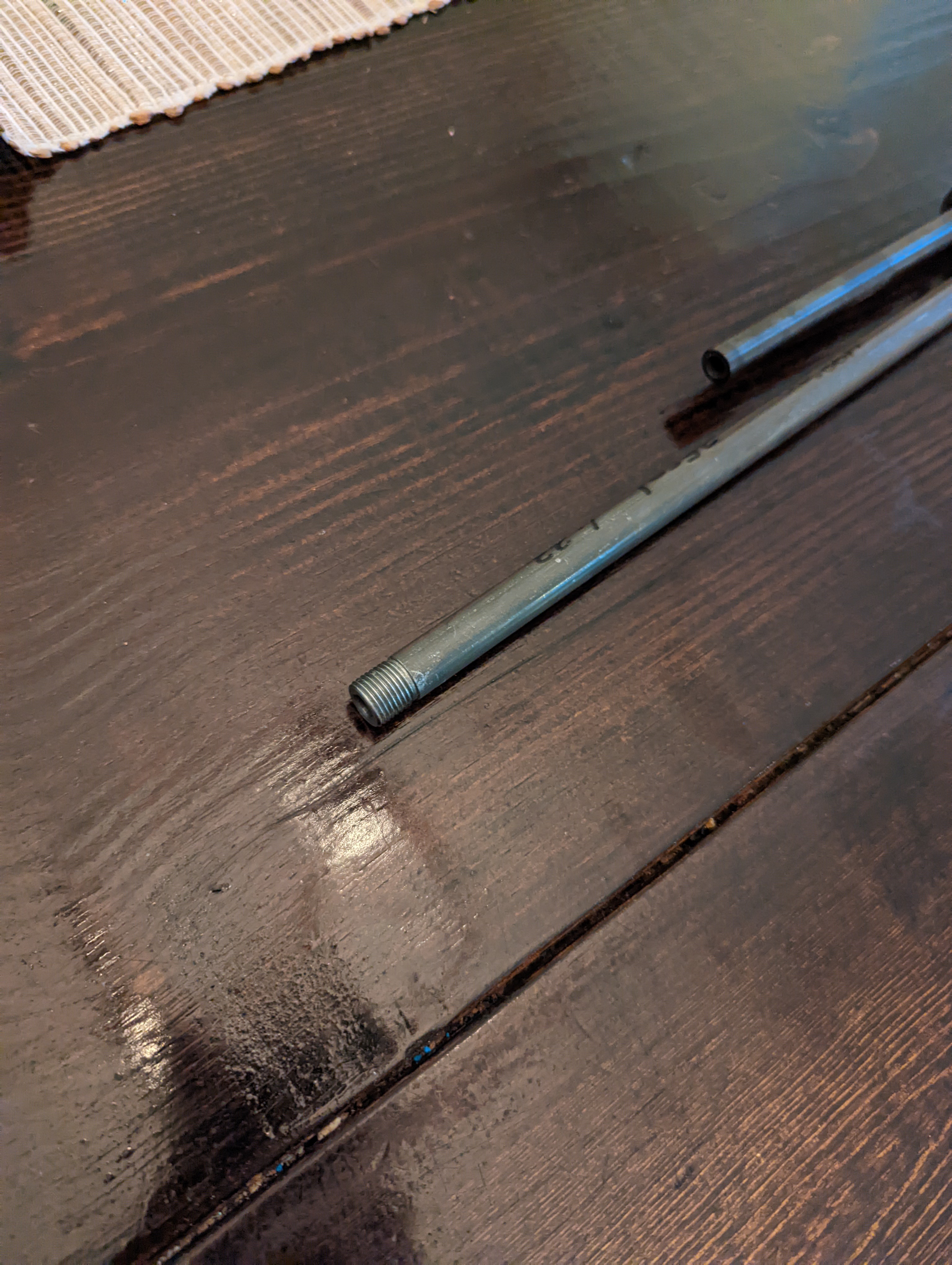

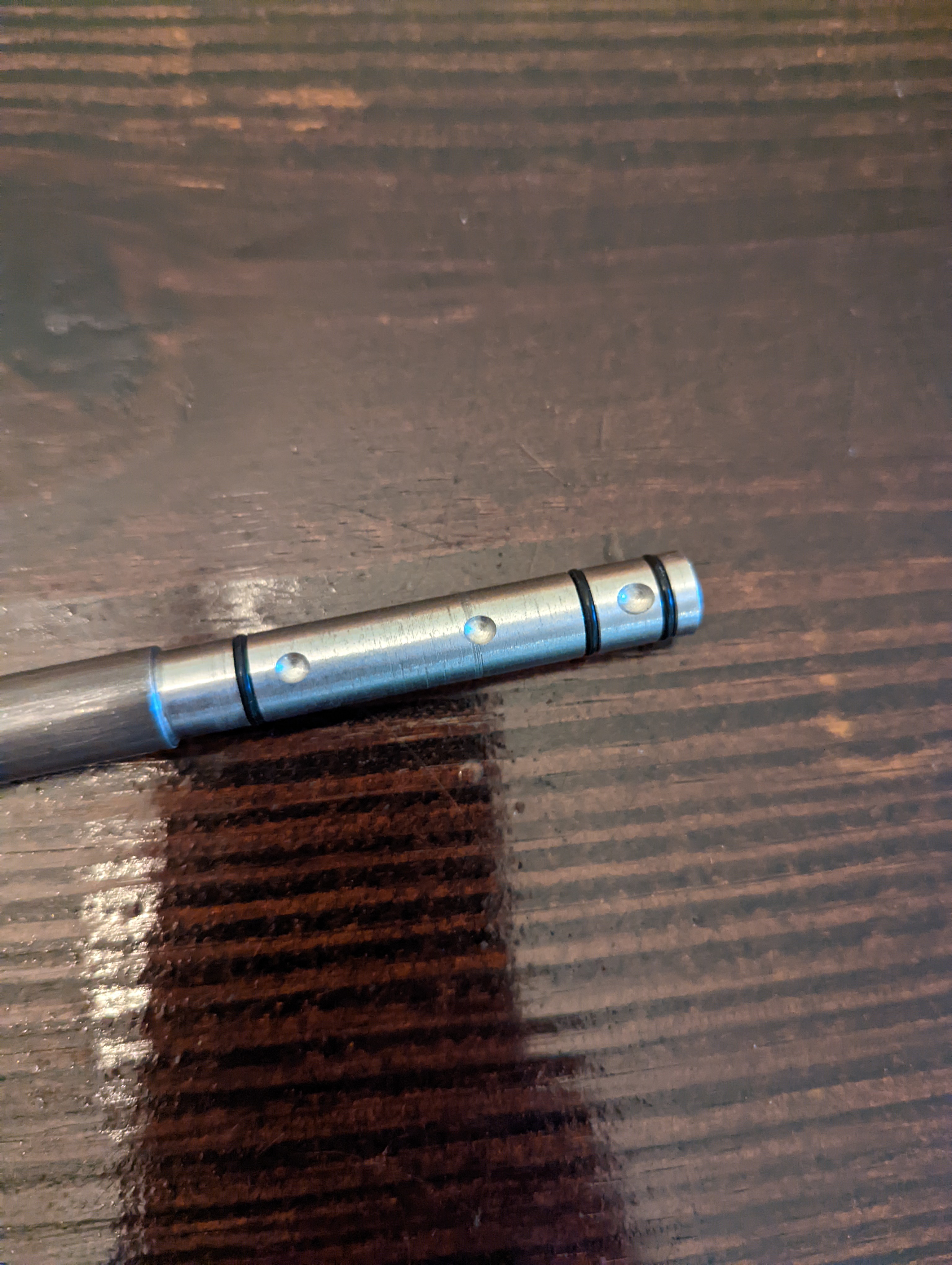

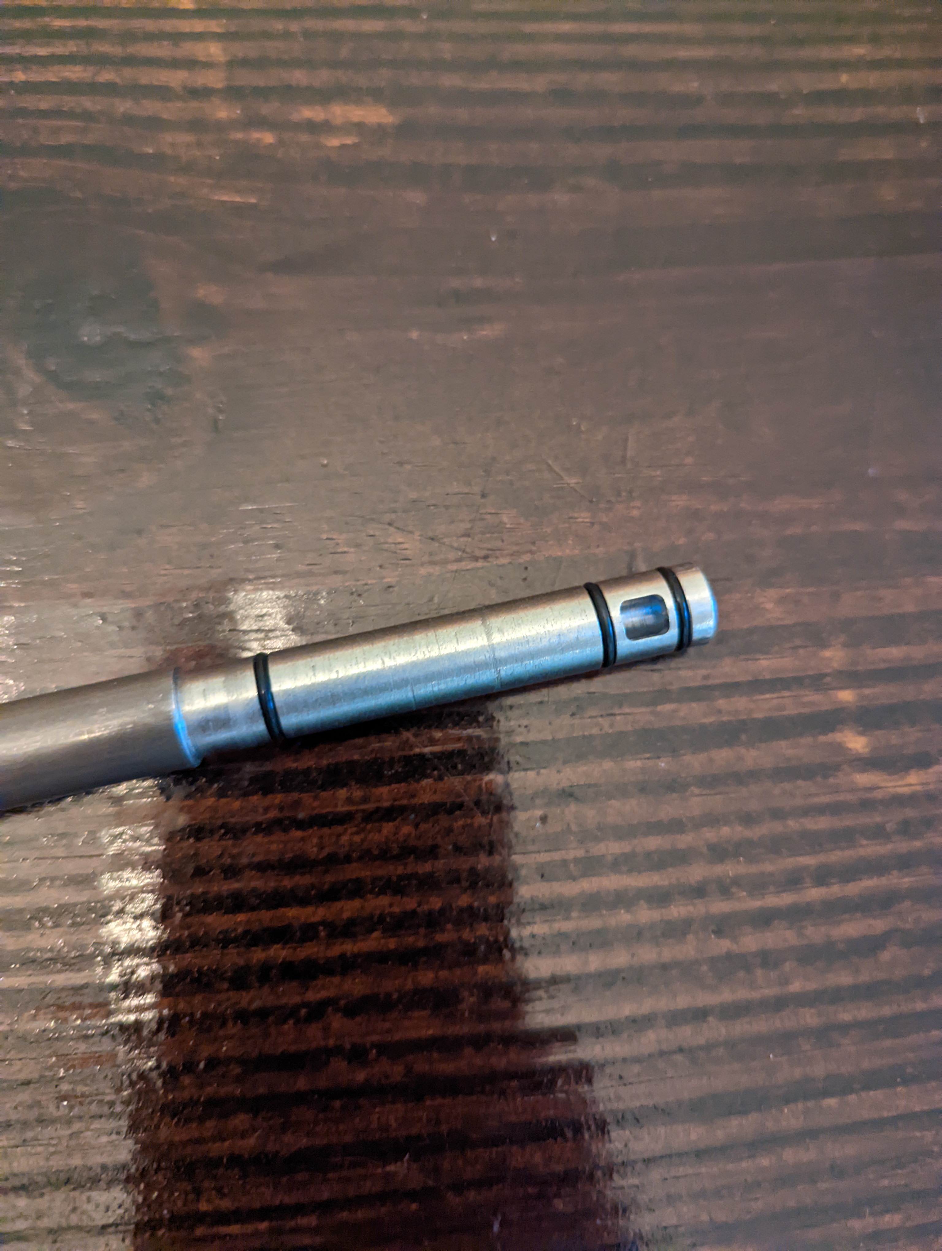

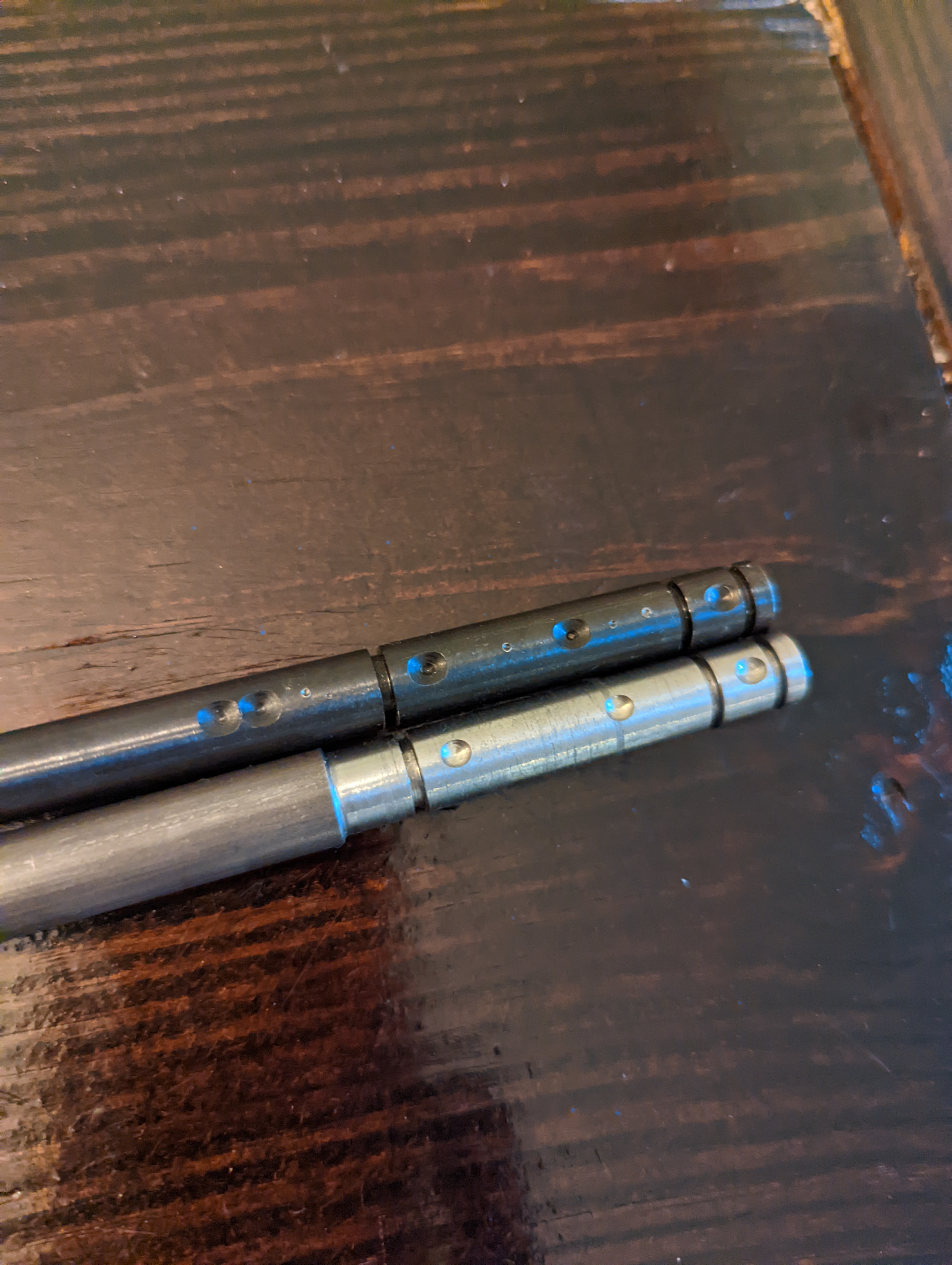

Dropped my TJ barrel off last Friday to a machine shop and just got it back today. I think he did a great job at a good price. Looking forward to trying it out.
Was this done by a gunsmith or regular machine shop?
What are your plans for a shroud?

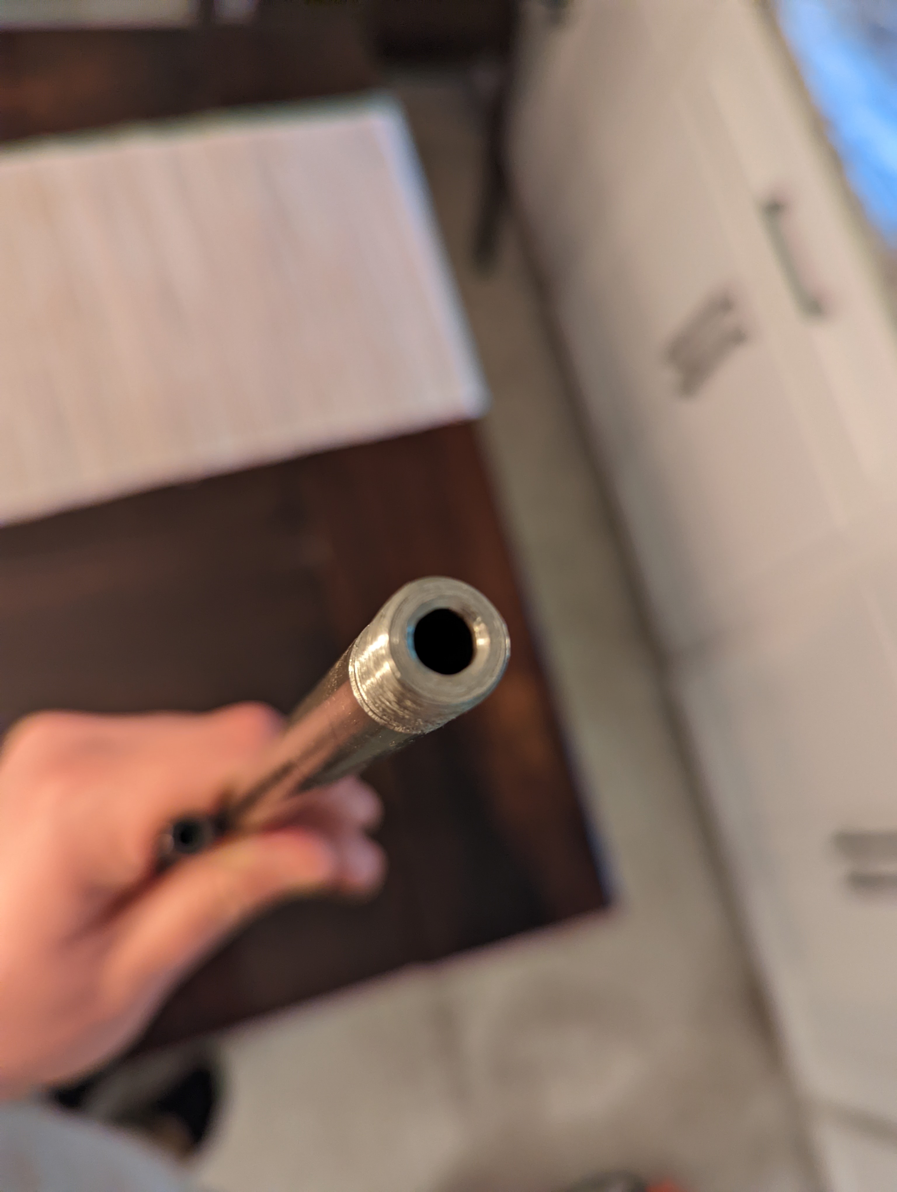

Done by a 72 year old machinist who makes a lot of barrels for other platforms. So I guess he isn't a gunsmith but just more of a machinist. As far as the shroud I am going "shroud less". So the stock shroud is 25mm in diameter. The barrel is 1/2" OD. So I am going to epoxy successively larger tubes of carbon fiber together over the barrel to the 25mm mark so I can still use my barrel band.. that is why I had him thread the actual barrel for a moderator instead of using the Donny FL adapter that I have. There will basically be 11mm of carbon fiber/epoxy encompassing the barrel for ridiculous rigidity. It will essentially be a carbon fiber bull barrel, haha. Yes I know this is excessive and ridiculous for a $300 gun but it's fun. Maybe I will find something in the process.

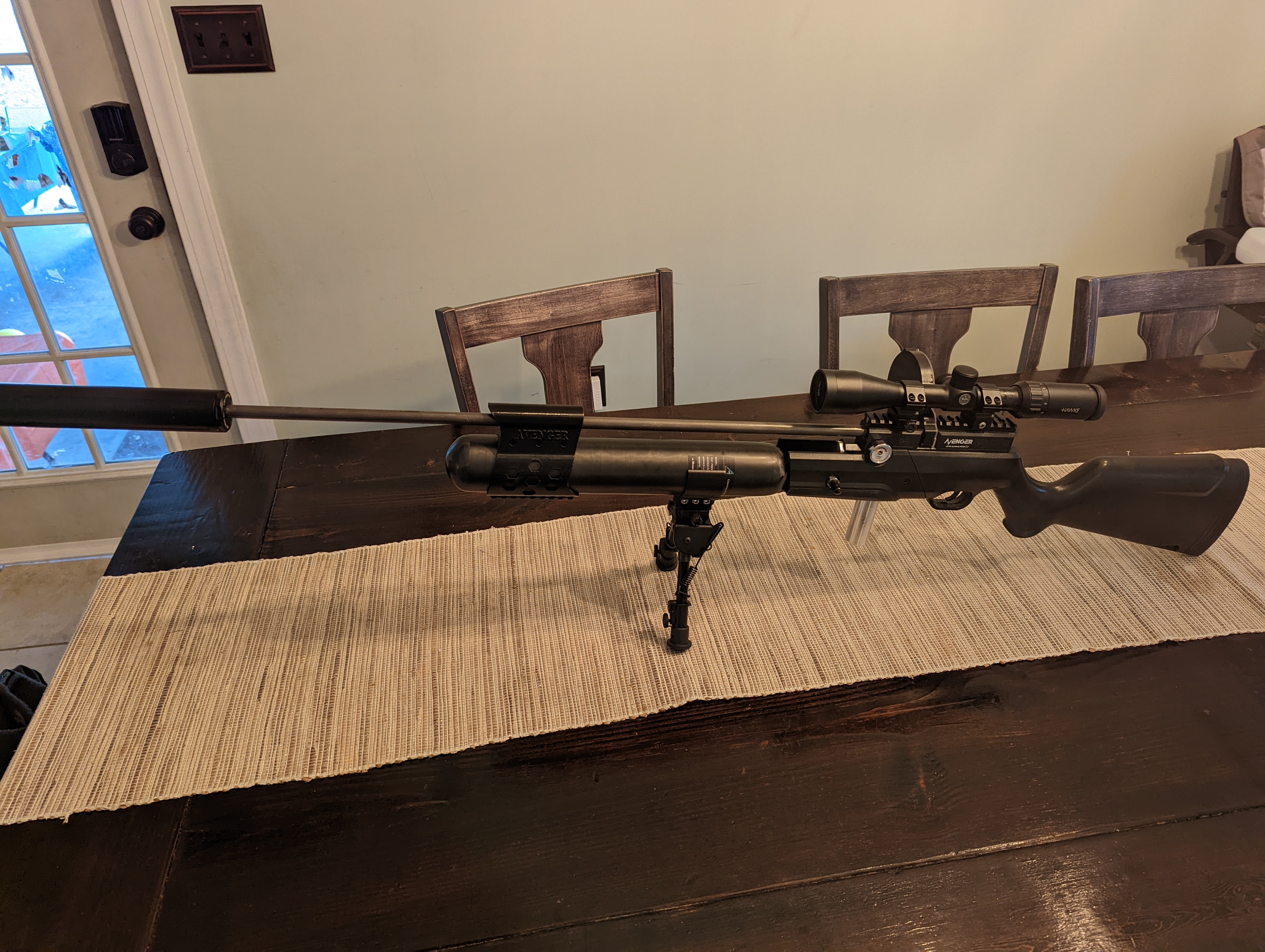

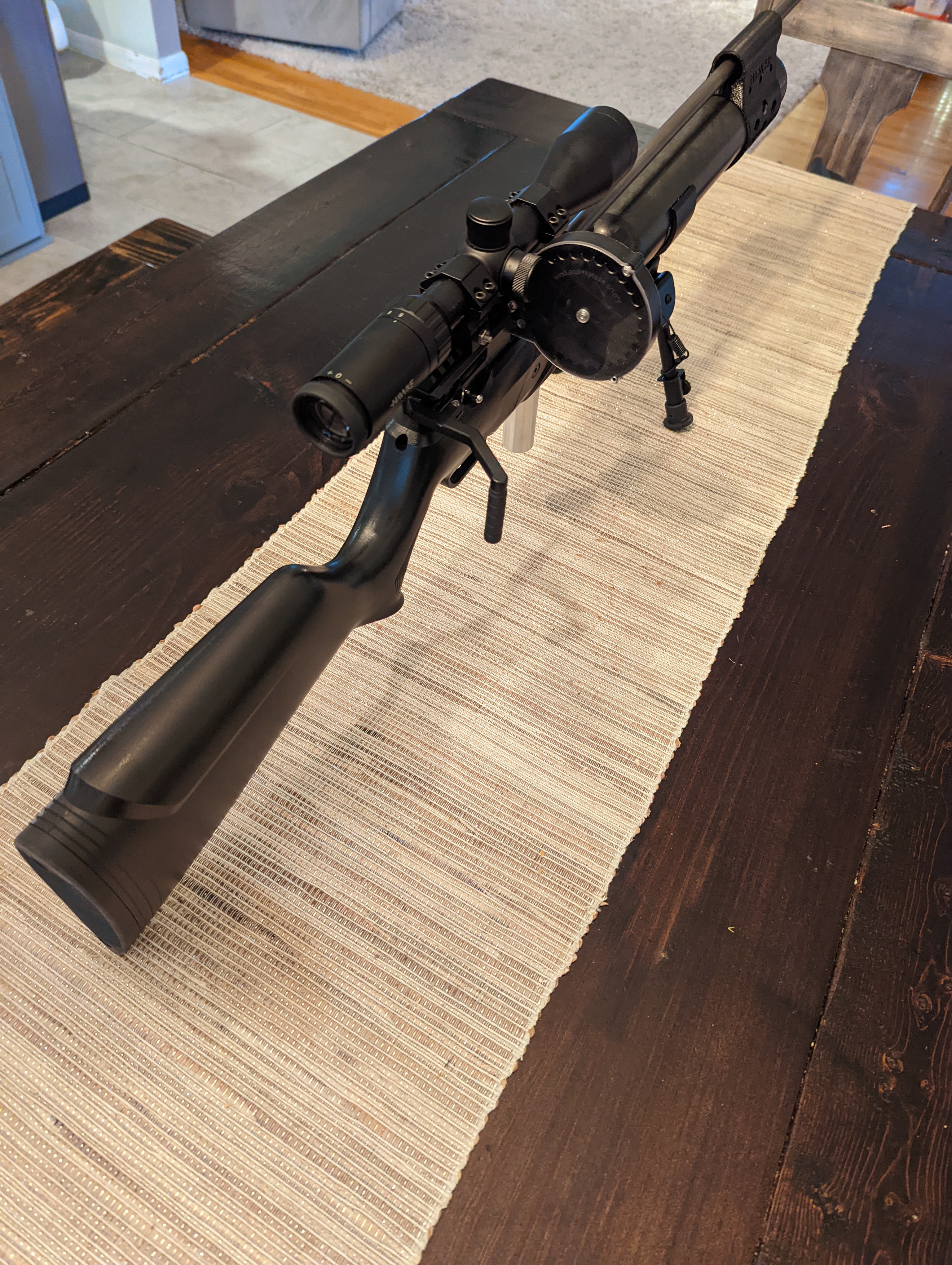

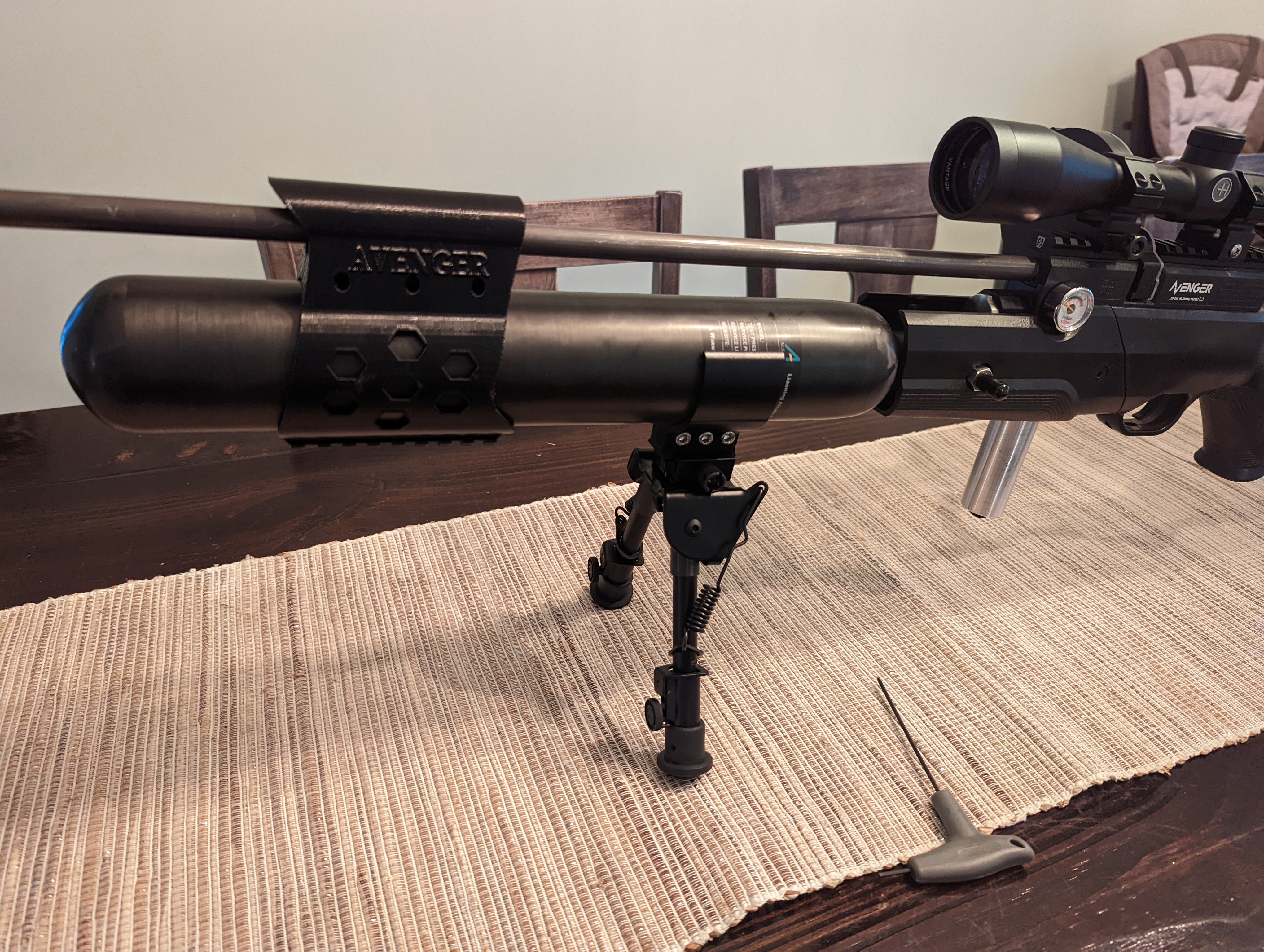

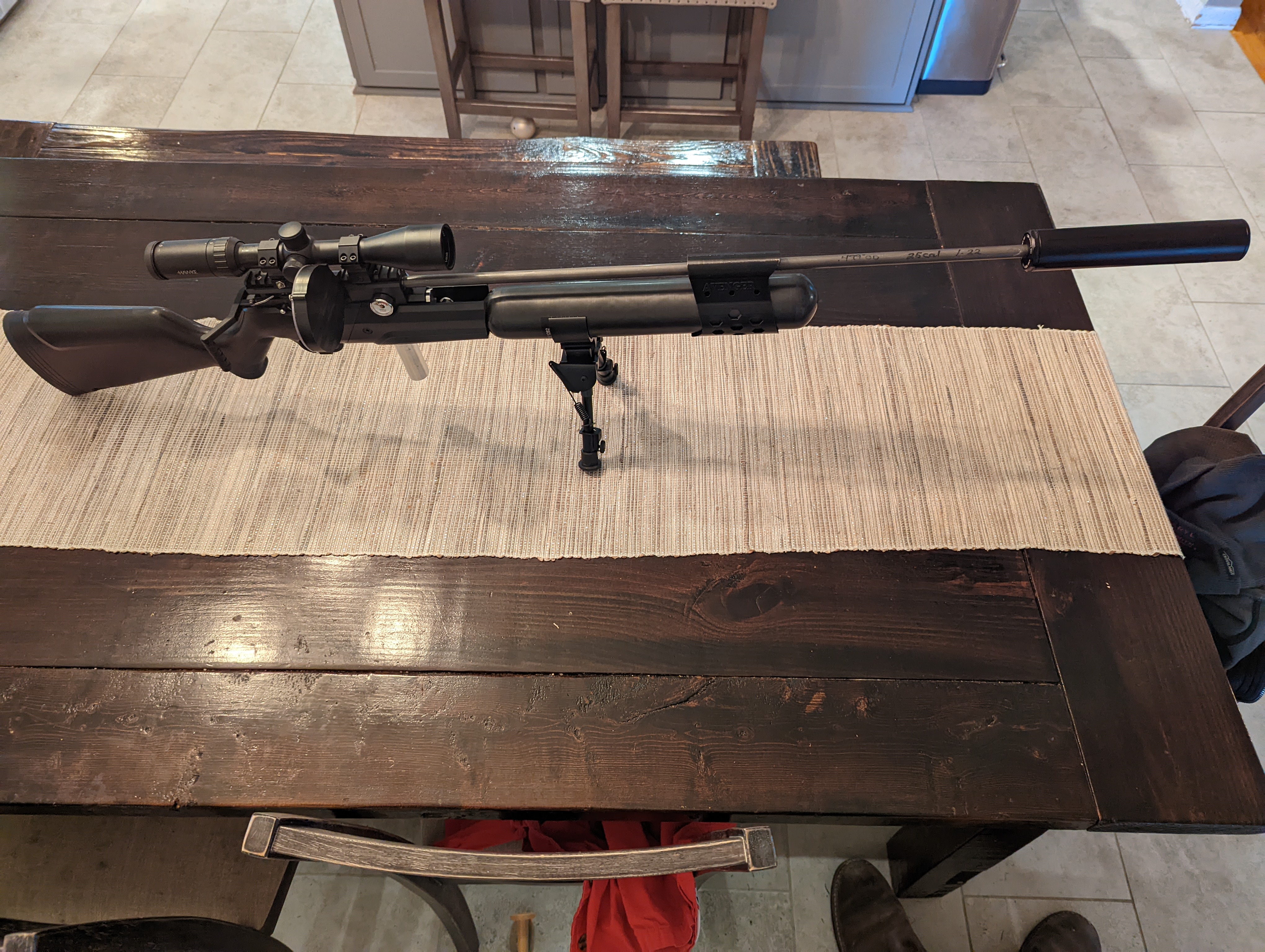

Well here are a few photo assemblies. Barrel band is just on for effect until I have all my carbon fiber tubes put on. Also I will probably use my Huma mod 40 with one of the sections out to shorten it a touch. I think it's gonna look good all done. Also don't mind the one scope mount... I broke the dang bolt and had to put a machine screw through it for time being.
It has also occurred to me that perhaps I may come up with something to tension the barrel lightly. I may take some 1/2" x 1" (roughly 25mm OD) stainless washers and epoxy those to the ends of my carbon fiber tube assembly. In doing so I could have a finished and yet hard surface to possibly use the moderator to tension the whole system just a little bit.

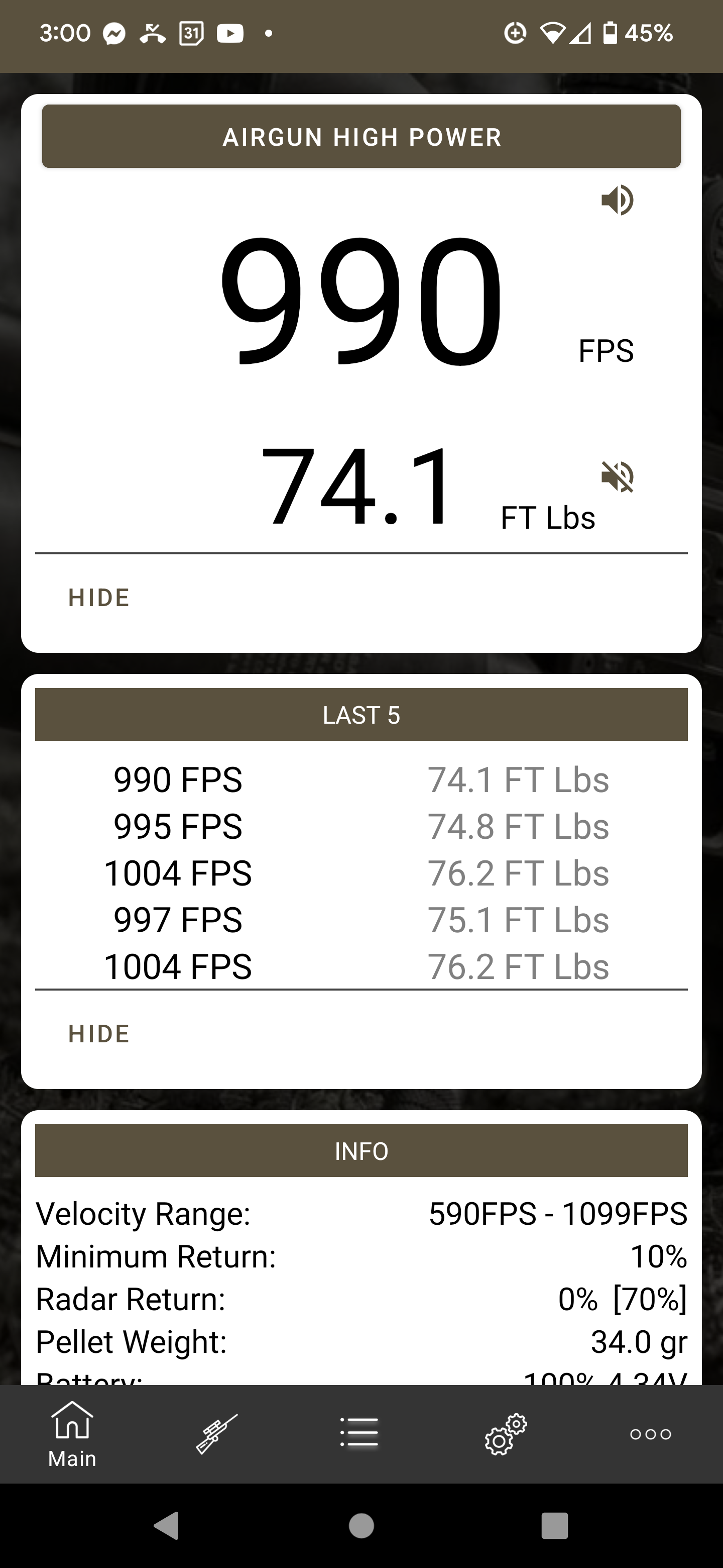

193-200 bar. Have you tried a stronger hammer spring or adding a little hammer weight?
I have. From my experience taking gun apart it will suck to get to and nobody makes parts for it. The stock spring is actually really stout. Not sure on the actual hammer weight though. The easiest way to adjust more power from the valve is by using a lighter valve return spring. I do have a lighter one in there and I have a couple lighter ones as well. I did have one that was pretty light at one point but the gun seemed more inconsistent so I put a slightly heavier spring in which made overall less power but was much more consistent. I think now I am at the point where I would have to make custom parts for it to keep gaining power. But the point of the barrel was really to shoot slugs so hopefully I can get some time to shoot slugs soon.. but right now the jsb heavies at 1000 fps are nearly one hole at 30 yards. Impressive so far.
