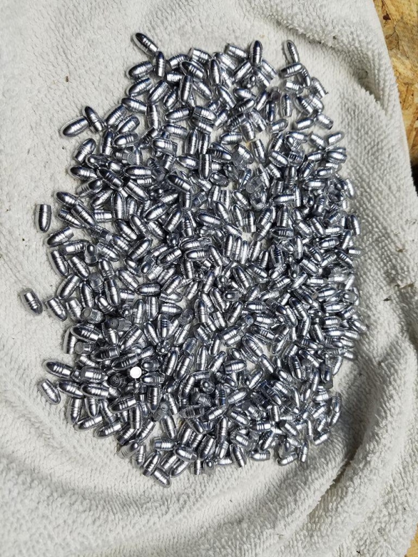

I suspect you're right about the mold not being hot enough. It's a Lee production pot, and wasn't very full, so I couldn't get the mold to touch the melted let to warm it up properly. I was trying to do this quickly, which never leads to good results.
From what I can tell, air cooled wheel weights should be around the 12-18 range you mentioned, but I'm not sure if this is really what I'd call high power. FX testing was done with NSA slugs, and what we've been told is that they're 0.217" diameter, and almost certainly pure lead since they're swaged. I'm wondering if the softer lead is needed to make the odd FX rifling work better, so I'll give that a try next week when I get some soft lead.

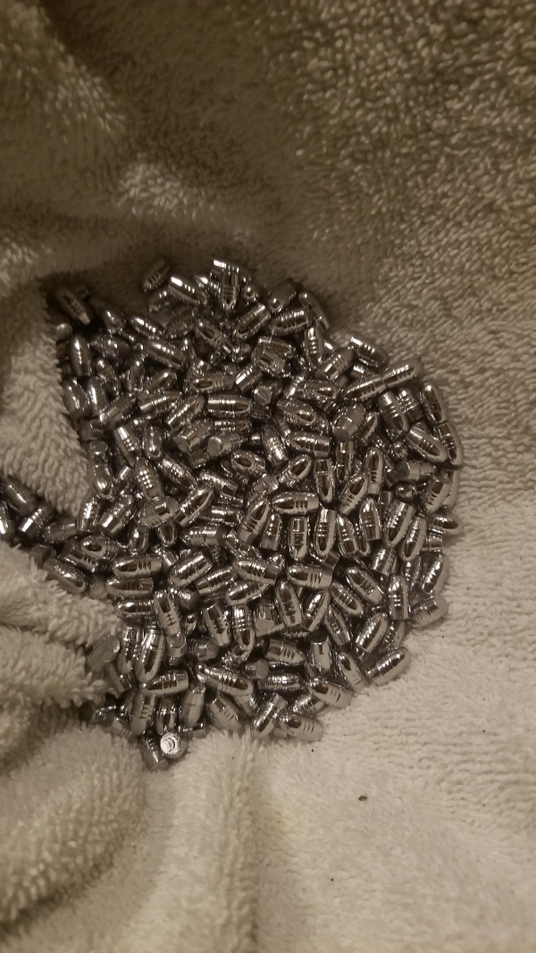

Cool. What do the 5.55 slugs measure after casting? My soft lead showed up yesterday, so I'll be casting some 5.52 in pure lead to see if that makes a difference. I also cut some custom shapes in a mold, but I'm still working on my technique, so they will be somewhat flawed I fear. I'm also working on some ideas for swaging tests.
Rusty
