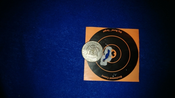

OK well I have been shooting these slugs today and here is a group from My Taipan Veteran STD , The pellet tune was 900fps with JSB !8 gr I had to bump it up for these well they chamber fine no resizing needed ,So far I shot in Airforce , Taipan , Evanix AR6 and they shot well in all of them . so I found they can shoot accurately from 650 to 1100 fps and you can get them from 36 to 30 grains . here is picture of 10 shots 100 yard groups , the conditions were , 28 degrees , wind None . snowing lightly

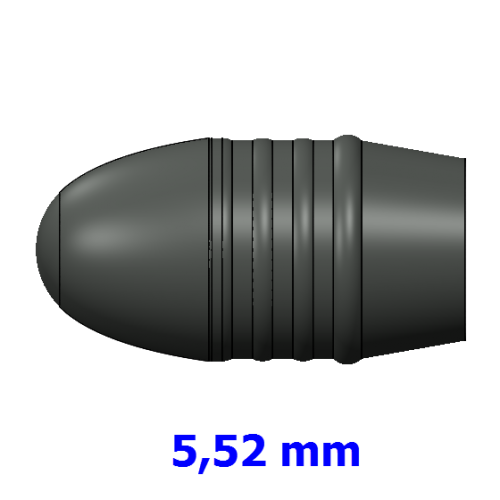

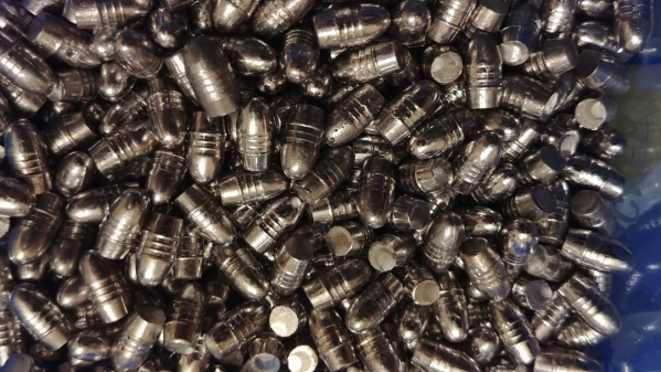

OK if you look close at these you will look and say ohh it has a lube ring and it looks like a 22 long rifle bullet , well you would be wrong if you look very close you will see the 2 rigs are different size and the front ring is like size of a JSB head of pellet and the rear is like the skirt , o in essence less drag , and it seals like piston rings in a car engine and here is another good thing . due to this , these will shoot in Most Choked barrel fine unlike regular slugs which too much friction in choke messes up accuracy . I will do more testing the BC is like 4.1 x higher then a JSB so long range is accuracy superb , and wind just does not throw off POI like pellets do ,
Glem which gun in 22 do you own ? if it is lower powered it may be better to not use pure lead , as pure lead is softer but also heavier meaning it wi go slower and it you go a bit harder it is ok as friction is minimal due to only the piston ring , I found this during playing with the 25 caliber mold
BYW for the heck of it some may ask this , The slug will shoot down to say 28 grains . but any more will ruin mold of you plan on planing it , also It can be made into hollow point and retain its accuracy and it will drop about 1.2 grains on hollow point ,
