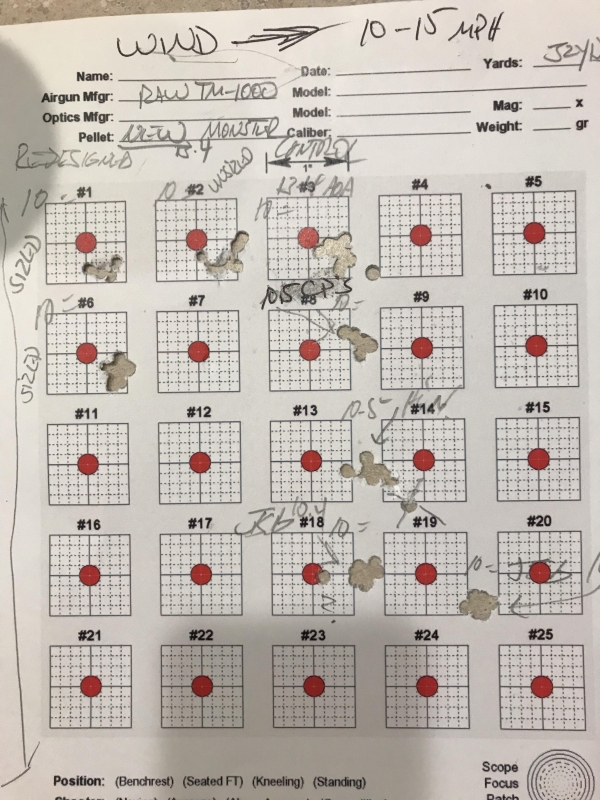

I bought a tin of the newly designed JSB .177 monsters. They have the same shape as the newly designed .22 monsters and .25 heavies.
I shot them out of my TM 1000 at around 800 fps. They didn't perform so well. I was shooting benchrest cards and got at least one flyer on each card that was off enough too drop a point (9 ring). None of any of the other lots of older type monsters throw those fliers in this rifle. Oh well...
Just offering this up for information on this new pellet.

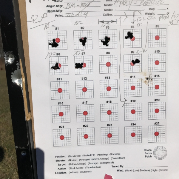

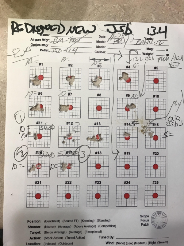

Just got my redesigned monsters also!,shot them yesterday in my BM-1000, w/polly barrel- initial observations = 1- Much larger skirt dia. 2- thicker skirt sidewalls 3- weighed two tins- less variation in weight,pellet to pellet 4- straight from tin my poly barrel DID NOT LIKE THEM!, which Puzzled me alittle bit?, because I expected the polly barrels would?, then I sized some “BINGO” they improved dramatically!, just for reference I used a .1815. Die, It Did not size the head, only the skirt!( I really expected the poly to like the thicker skirt sidewall?) Now mind you this very preliminary testing & results, but for now I am sticking with the OLD monsters in my poly barrels until I can test further! Have not shot them in my 12 groove standard, that will happen today!
Also wanted to add, I thought these might be more consistent because of less damage during shipping ( because of shape & thickness of skirt) plus thought this would lead to more consistency from lot to lot because of a seemingly less complex die mold? Time will tell?, lots of ideas running through my head! Also mind you, I’m in no way an expert in pellet design!, I’m only relaying my own thoughts & impressions, please do your own testing there are many shooters on this forum with far more experience than I.
Shot 11-29-17 from poly barrel
Just in from testing Redesigned jsb monsters in my TM-1000, shot both sized (.1815 Die) & straight from tin, sized shoot better than from tin, but neither any better than old monsters!, actually shot some control groups w/ jsb 10.4 heavy’s, ( that have always shot very consistently small groups!) 10.6 HN Baracuda, and some trusty 10.5 gr C’p’s all shot well, the sized redesigned monsters shot good but not significantly better!, also must add the wind was a factor today!, groups were not great with any of the pellets used, but I am confident the the jsb heavy’s will outshoot the redesigned monster @ the yardage I shot today
