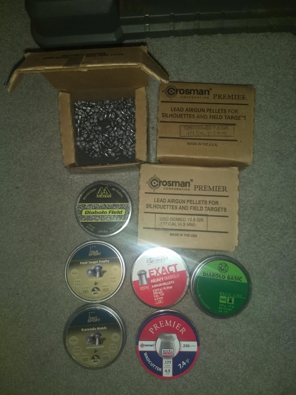

I can create a sample pack for you out of these pellets. Let me know which ones you are interested in.
Crosman premier 7.9 grain
Crosman premier 10.5 grain
Crosman wad-cutters 7.4 grains
Air Arms 8.4 grains
JSP Havy 10.34 grains
H&N bracuda match 10.65 grains
H&N Field target trophy 8.64 grains
RWS diabolo basic 7 grains
