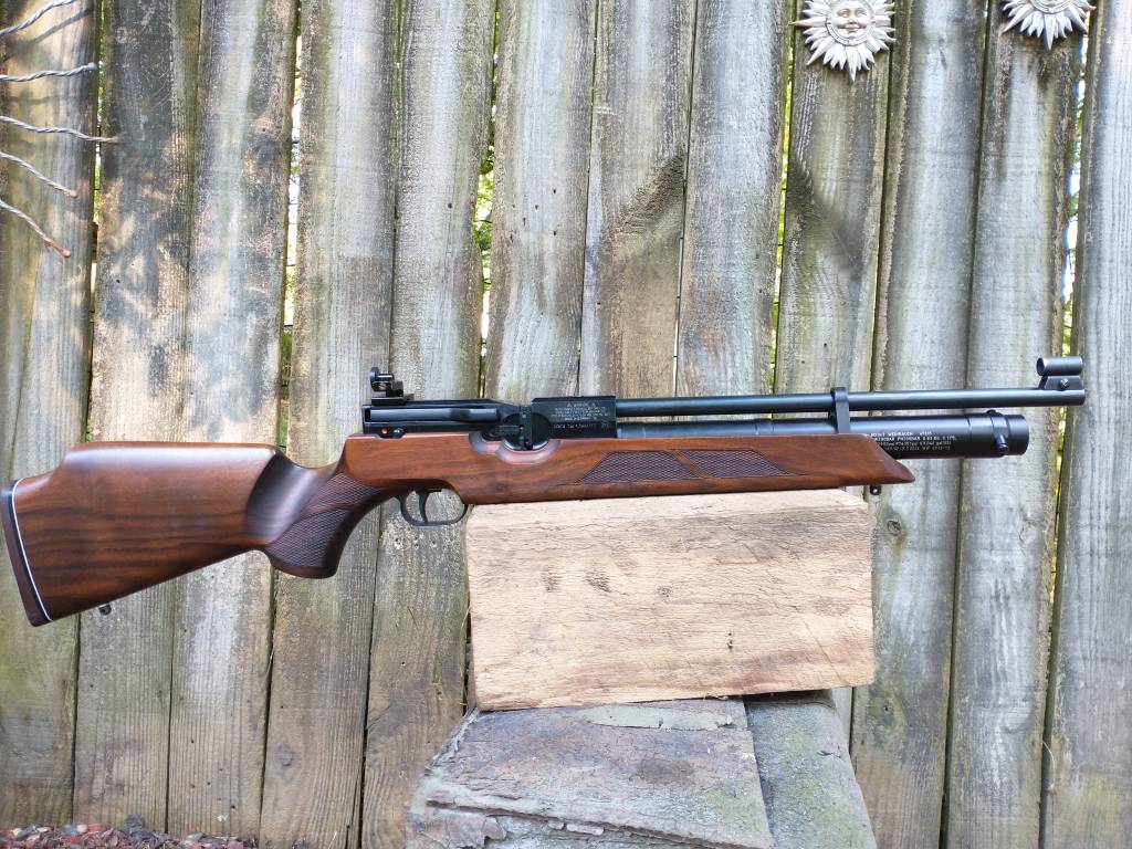

You need a "Rifle" length gun, with a 410mm barrel fitted. That's the barrel length from a "non-FAC" RIFLE, or an "FAC" rated CARBINE.
There are two stocks depending on what airtube they come with. You can fit a rifle cylinder onto a carbine stock, if you swap the ends on the cylinder around and then install the tube backwards.
The Ratworks fill valve on their cylinders are garbage. If you use one of their tubes, install the factory HW ends onto it. The straight profile of these tubes will fit in any stock.

There are two cylinders sizes from Weihrauch the 105 and the 175. The K versions with the 310 mm non shrouded barrels will come with the 105cc. All other models come with the 175cc tube . Now to complicate things the FSB ( shrouded) models come with either the 310mm , 410 mm or 560mm barrels. The shortest is of course the non shrouded 310mm barrel K model . Next is the TKFSB models with the 175cc. The later will take the 390mm Ratworks cylinder which is about 215cc .

I'm confused. The cylinder on my carbine measures 12.5", or 317.5 mm. The distance to the point at which it would touch the silencer is about another half inch, which means the maximum length to clear, is about 330 mm. The pictures and descriptions on both the AOA and Weihrauch sites are very misleading. Maybe there are versions for the home market, 12 fpe guns, that are being included in the print data, and which are not even offered here. ??
