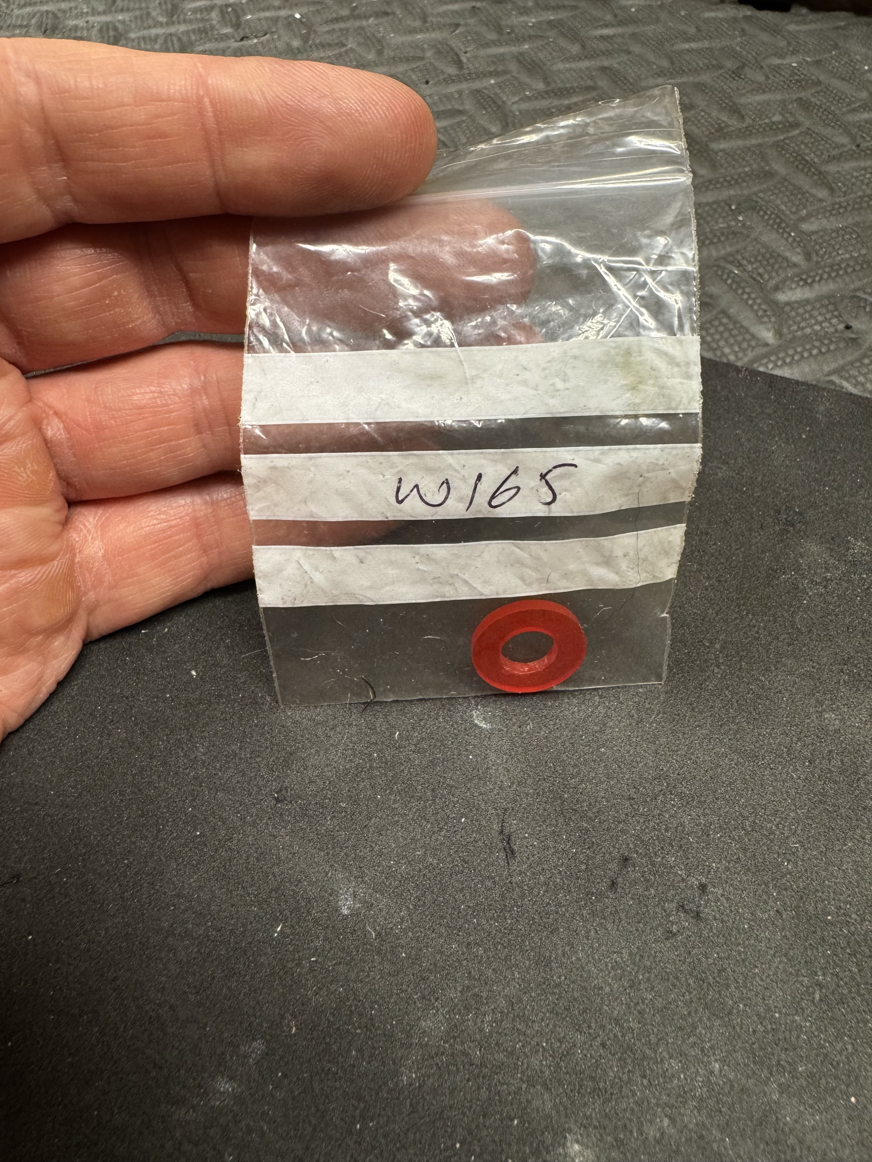

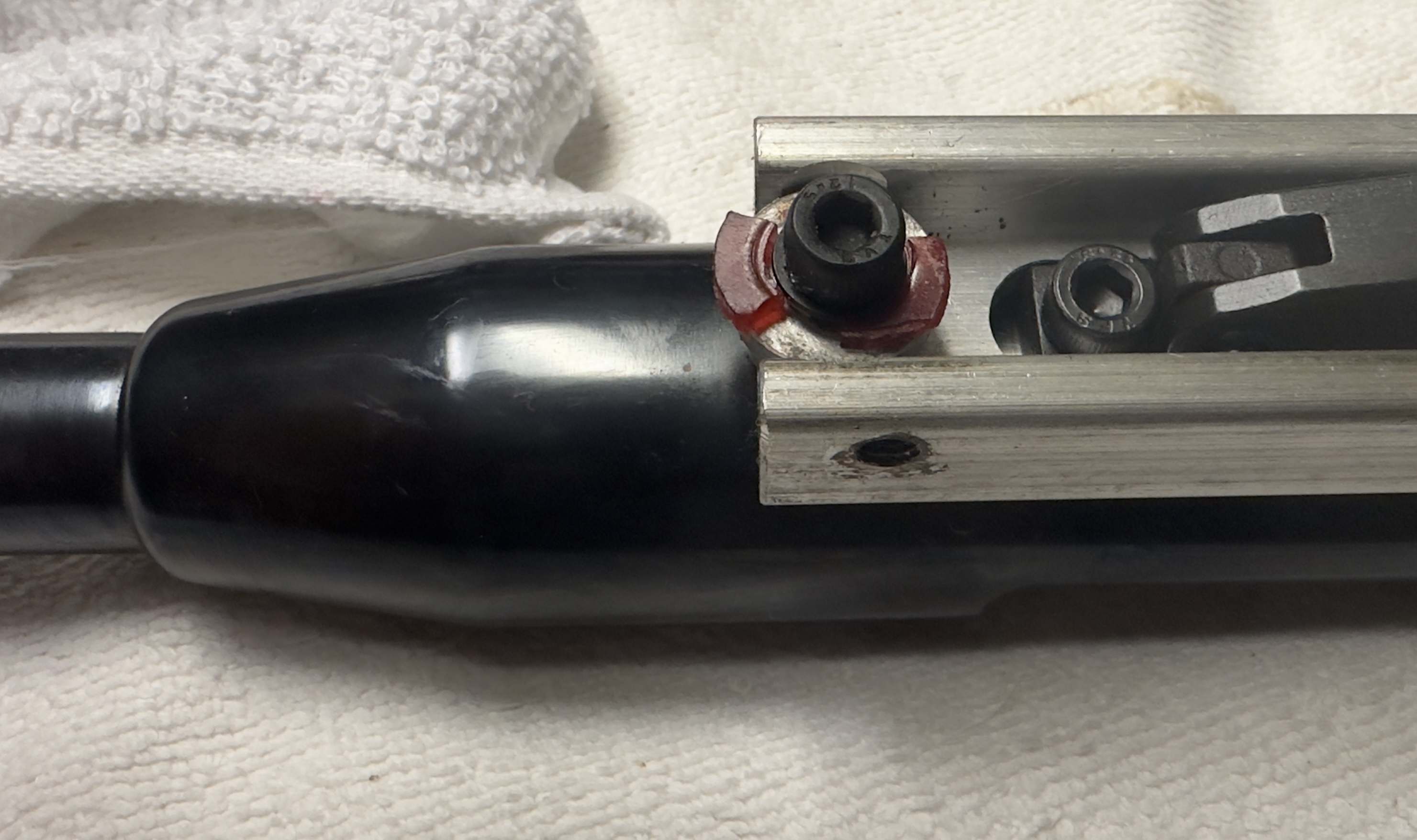

Need the pictured "washer" in red for a Pro Sport. The parts listing calls it a "Cocking Lever Buffer" part #PS417. Pyramyd Air does not list it. Anyone know where to source this, or what the exact size is? Thanks for any help.
Or maybe I just bought the rifle and it was already broken, but thank you. Not to mention that it was broken into quite a few pieces, most of which are missing.I would say you need to get some measurements! Thickness, outside and inside diameter and head to Ace hardware. Find a nylon or delrin washer that's close as possible to those measurements. It's only there to prevent damage to the cocking arm when returning to battery position. Maybe been slamming it home a little to hard is what broke it.
