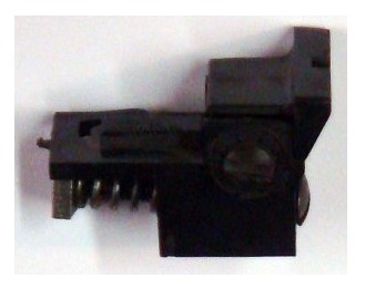

Daisy Need rear sight for Daisy 717
Hi, does anyone know where I can get a complete rear sight for the Daisy 717.
I've tried most gunsmiths and none have them. I may also be interested in one that is defective.
Thanks
Arvid
Reactions: MrGrey
