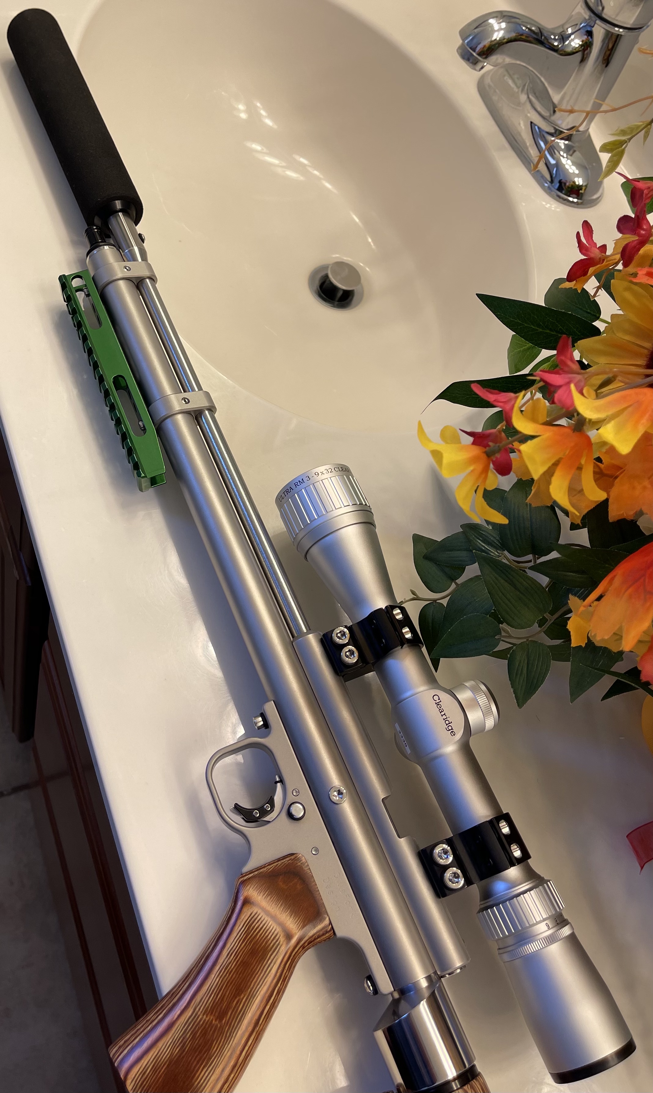

I've got a Center Point 6x32 AO scope on my Maximus.
I'd like to get something better but understand, I paid $150 for the Maximus brand new.
I varmint hun 25 t0 50 yards max.
Any suggestion?
I can't say for sure, but I thing somethings wrong with the Centerpoint. It will hold zero all today, but next day I need to adjust l/r and up down 4 or 5 clicks.

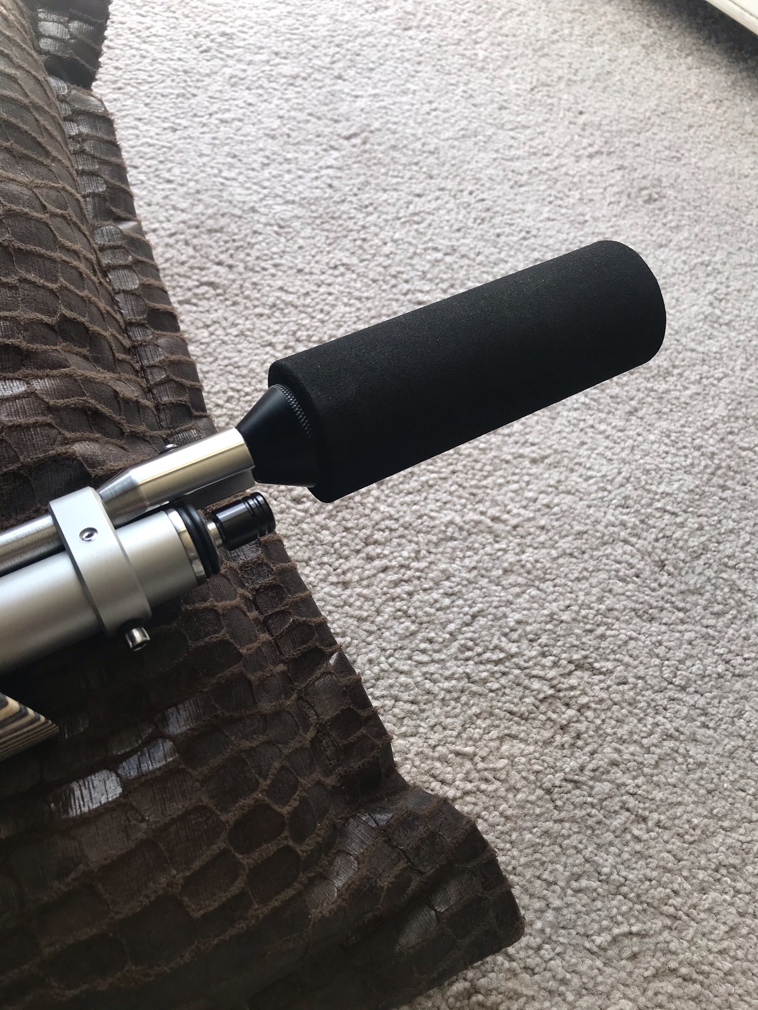

I have the TDK Suppressor on the barrel and I've often thought that the barrel being unshielded with the added length of the TDK could be causing inaccuracy.
I just read something about using shims from a piece of pop can helps, but I like the idea of an extra barrel band.
