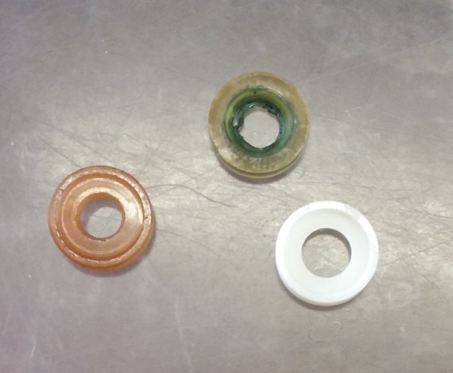

My 600 failed to hold air recently so I spent several hours making the seal on the left, trying it, taking it back apart to modify, etc.The original is in the center. I made that left one from a sheet of 80 D polyurethane. Apparently that is too soft or really needs that depression you can see on the other 2. It would hold air but barely spit the pellets out. I ended up ordering the white one (factory replacement) and I'm happy to say it spits them out with authority now. Haven't chrono'd but makes clean holes in the paper and not a lot of holdover for 30 yds, so good enough for me.
They are pretty easy to replace, so don't hesitate to take it on.
