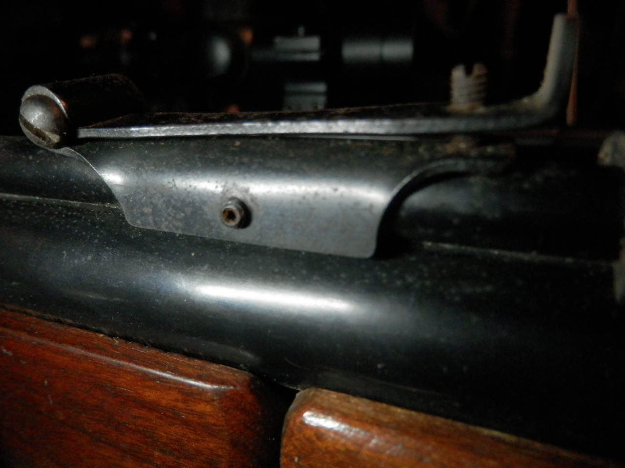

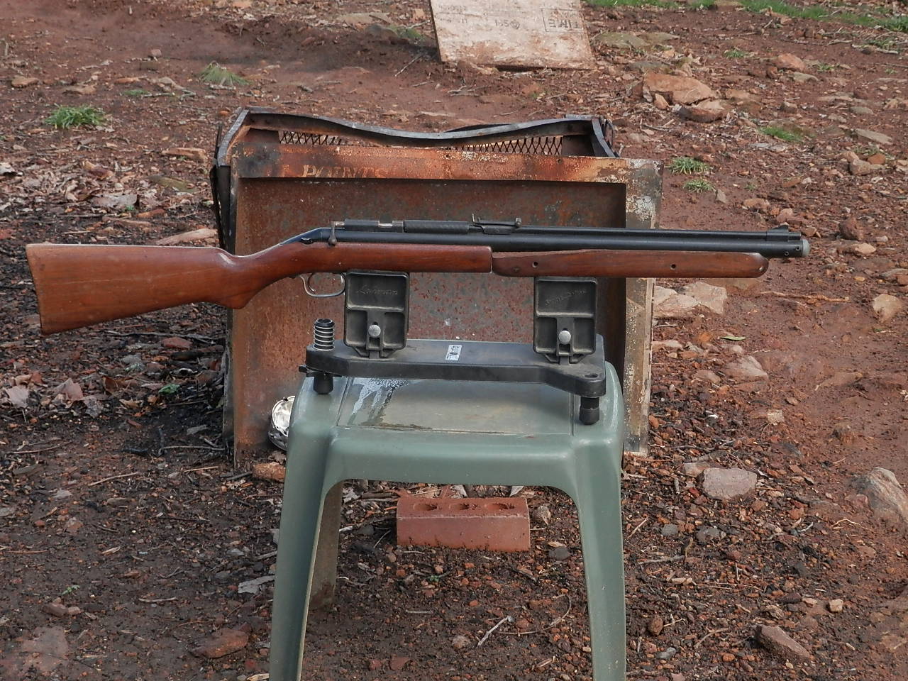

If you look at the vertical part of the left side of the receiver next to the loading port, there may be a tiny number and letter. If it's there it will be the year (in reverse) and month of manufacture. But they didn't start that for a few years and then discontinued it a few years after. If there are little screws holding the rear sight on, it's an early model. If there are wedges instead, it's a little later in manufacture. Here's a pic or two of mine. It's a bit of a beater, but it shoots very well.

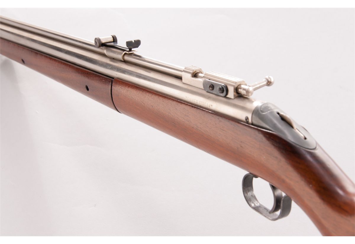

Edit - Here's a pic of an early one. Does yours look like it?
