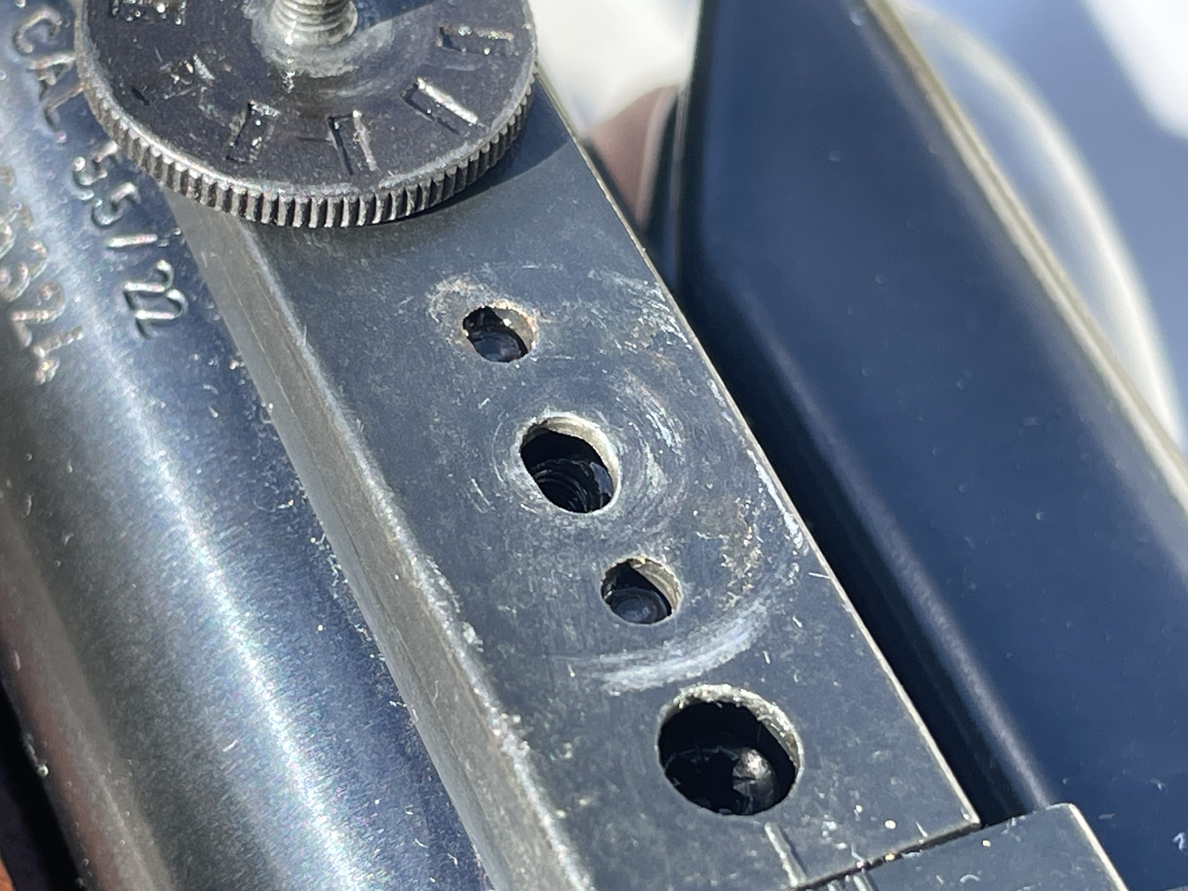

Diana Need help with 54 rear sight parts
What parts are holding the front sight adjustment screw in place?
I have the parts schematic but it is not showing this. I assume two tiny springs and ball bearings.
Anyone know where to get replacements or have fabricated them? Mine disappeared long ago.

i will call it the clicker, it was made up of a holder a spring and a ball and they were a unit and yes i spring of some sort has to have upward pressure to make it work

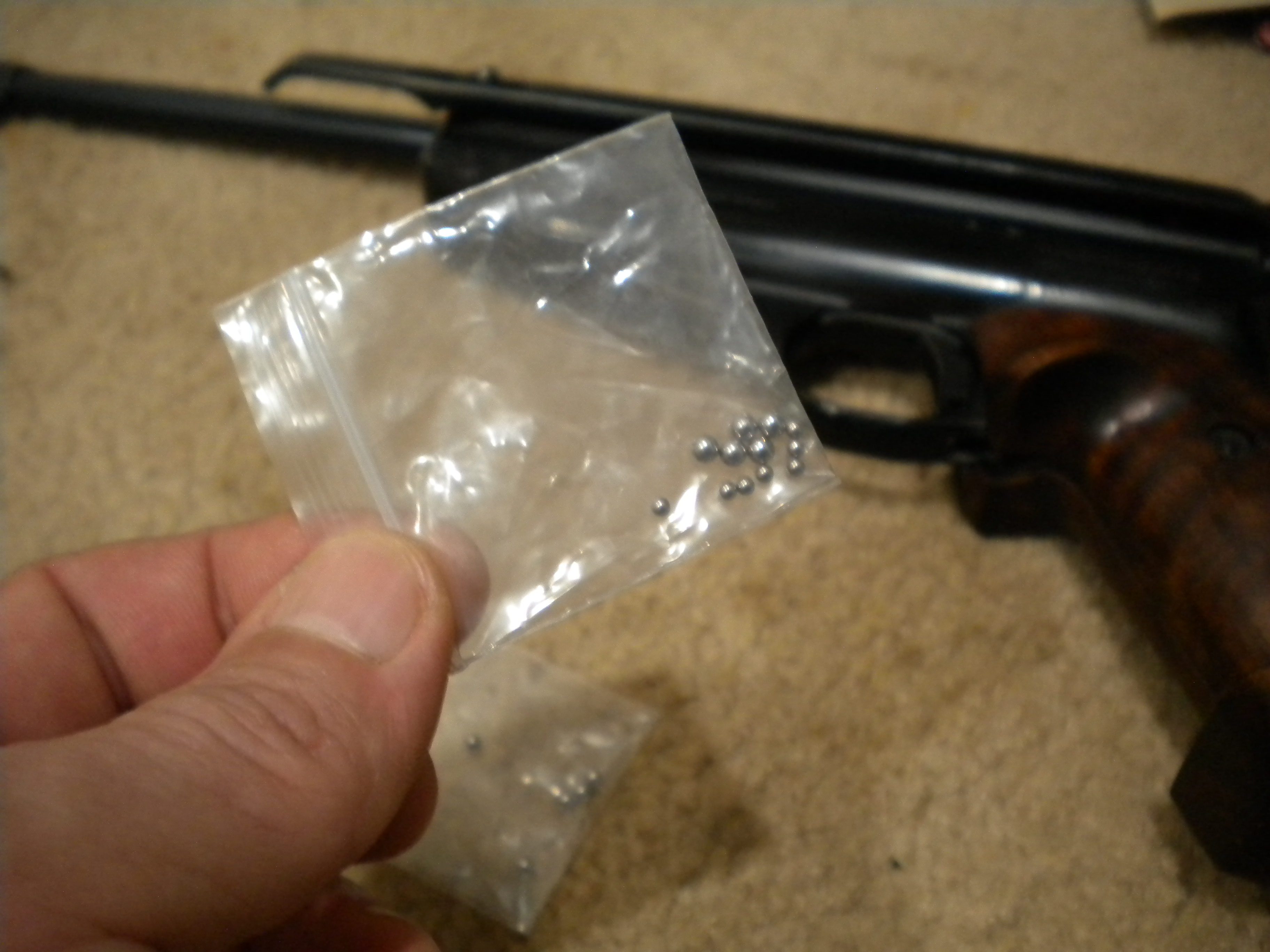

2 balls 2.5-3mm on ebay from China (10 pieces minimum for sale). Do not need springs for balls. You need 1 large spring under sight,I don’t remember the size, I have no desire to take my sight apart. I had same problem with my M54.
I seem to remember that now. The spring I can probably find in one of my junk parts bins. The ball bearings I can also get on Amazon. I'll order 2.5 and 3mm just in case.
Thanks
Reactions: Ievgen721
The smaller the balls, the more accurately the rear sight adjustments will work. I used 2.5mm balls.

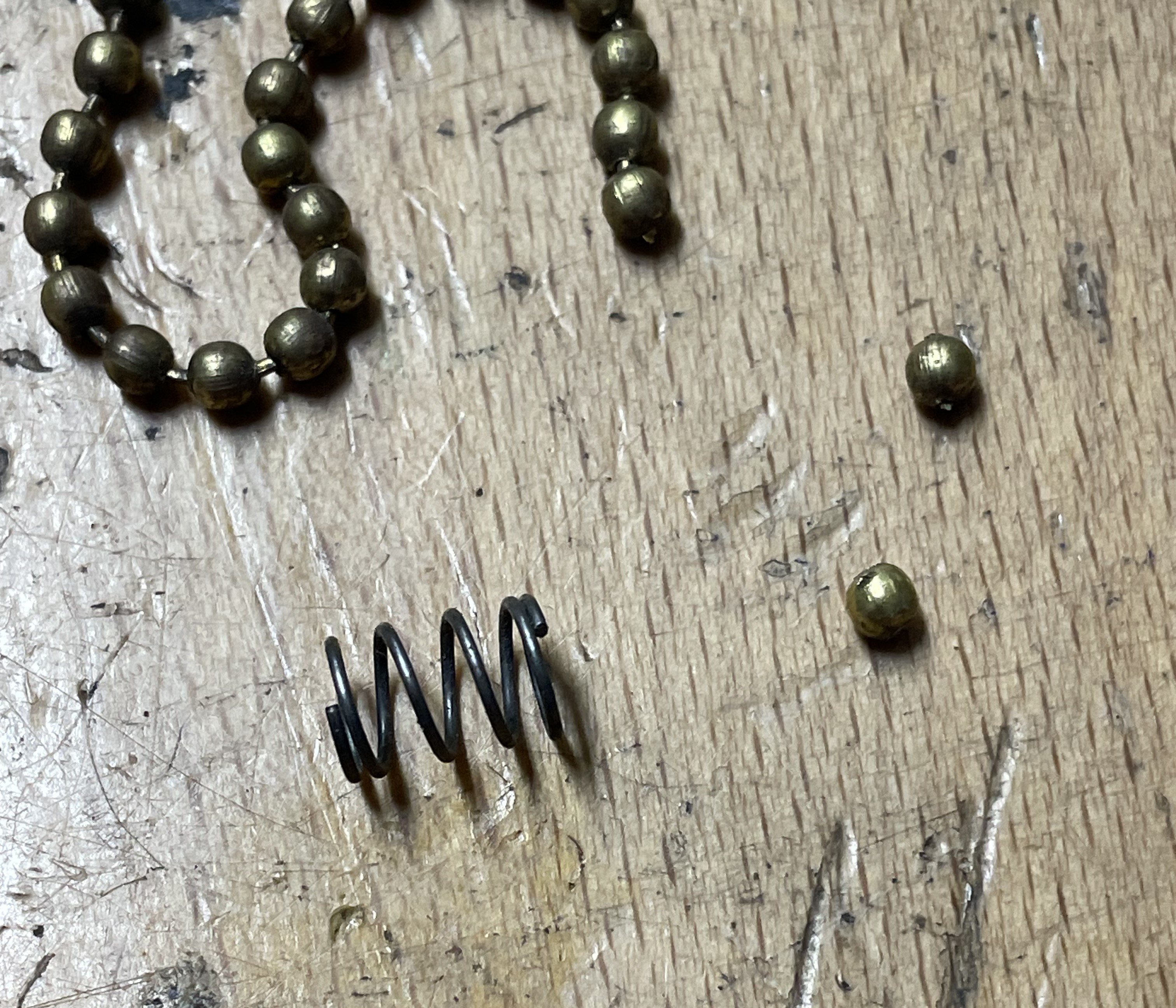

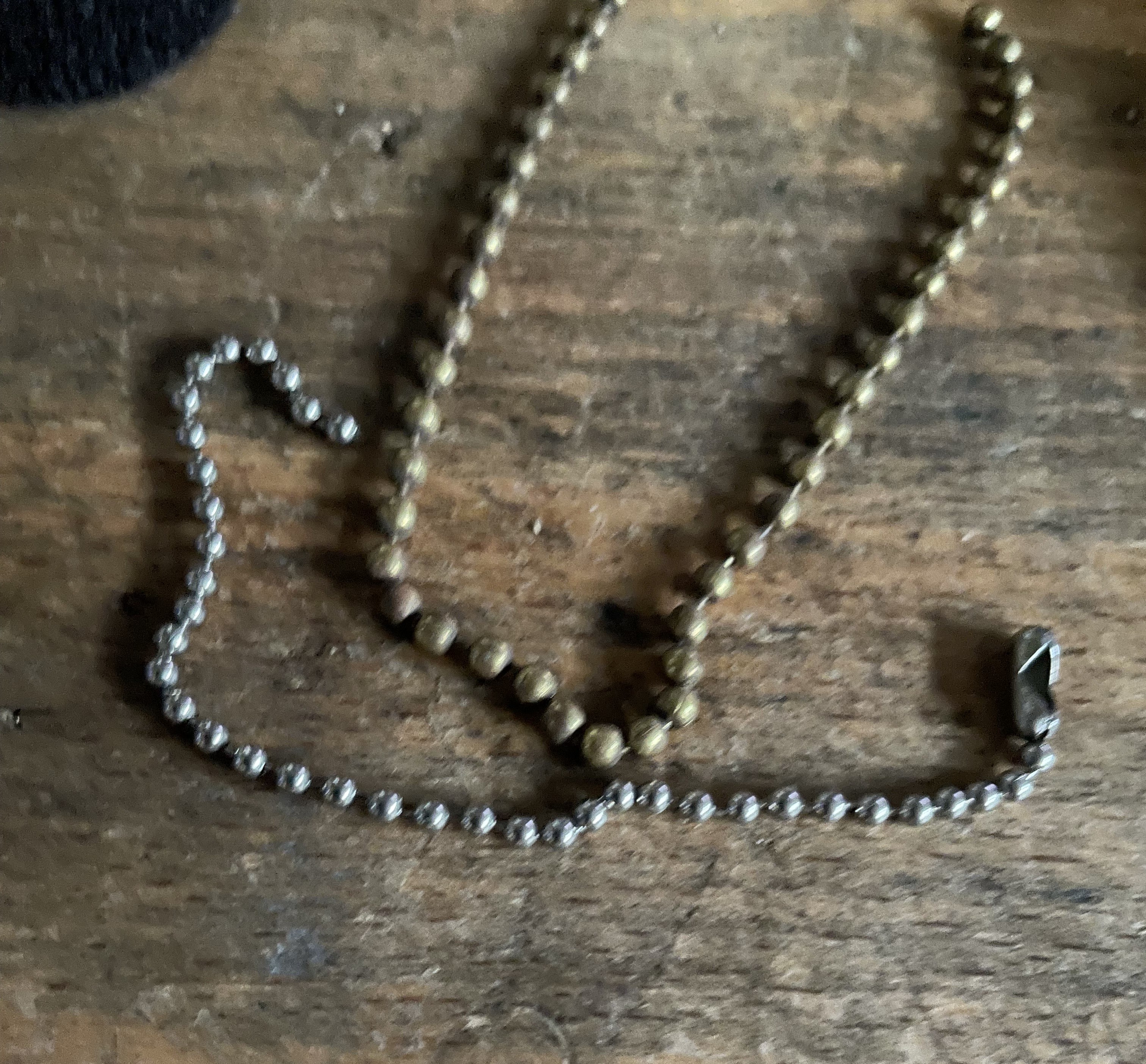

I was turning on the light over my workbench and realized the pull string was a bunch of tiny ball bearings. They actually measured 3mm in diameter. I tried them and they seemed a little too large for the hole. I ended up using a smaller pull chain I found which measured 2.3mm. Those fit completely in the hole. They work for now but maybe slightly undersize. I also found a spring that fit over the upper and lower posts under the sight.
