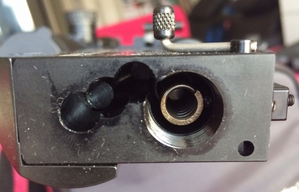

I have bought an used FX Wildcat .25 which has not the powered I was expected.
As you can see on this picture, the hammerspring ajuster has no action, as the spring is not long enough to reach the thread :

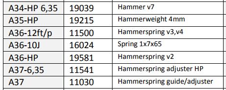

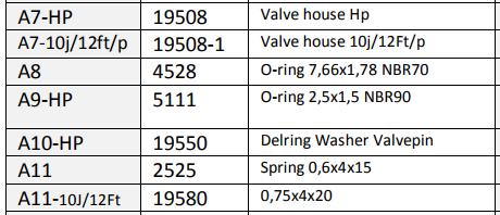

I've first imagined to change the hammer spring, but while reviewing the parts list available in the exploded view to identify its reference, I realized that there are 3 different models:
- HP
- 12 ft/lbs
- 10 joules
Would you please help me how identify which is my model so that I can order the needed parts ?
Hi Jibeji, the hammer spring doesn't have to be that long, in fact as its right now is perfect. Remember fx guns have free floated hammers so the spring and hammer are never under tension while the gun is not cocked. If the spring was flush with the action, the hammer spring tension adjuster would compress the spring and hammer towards the valve.
What kind of power are you getting?
