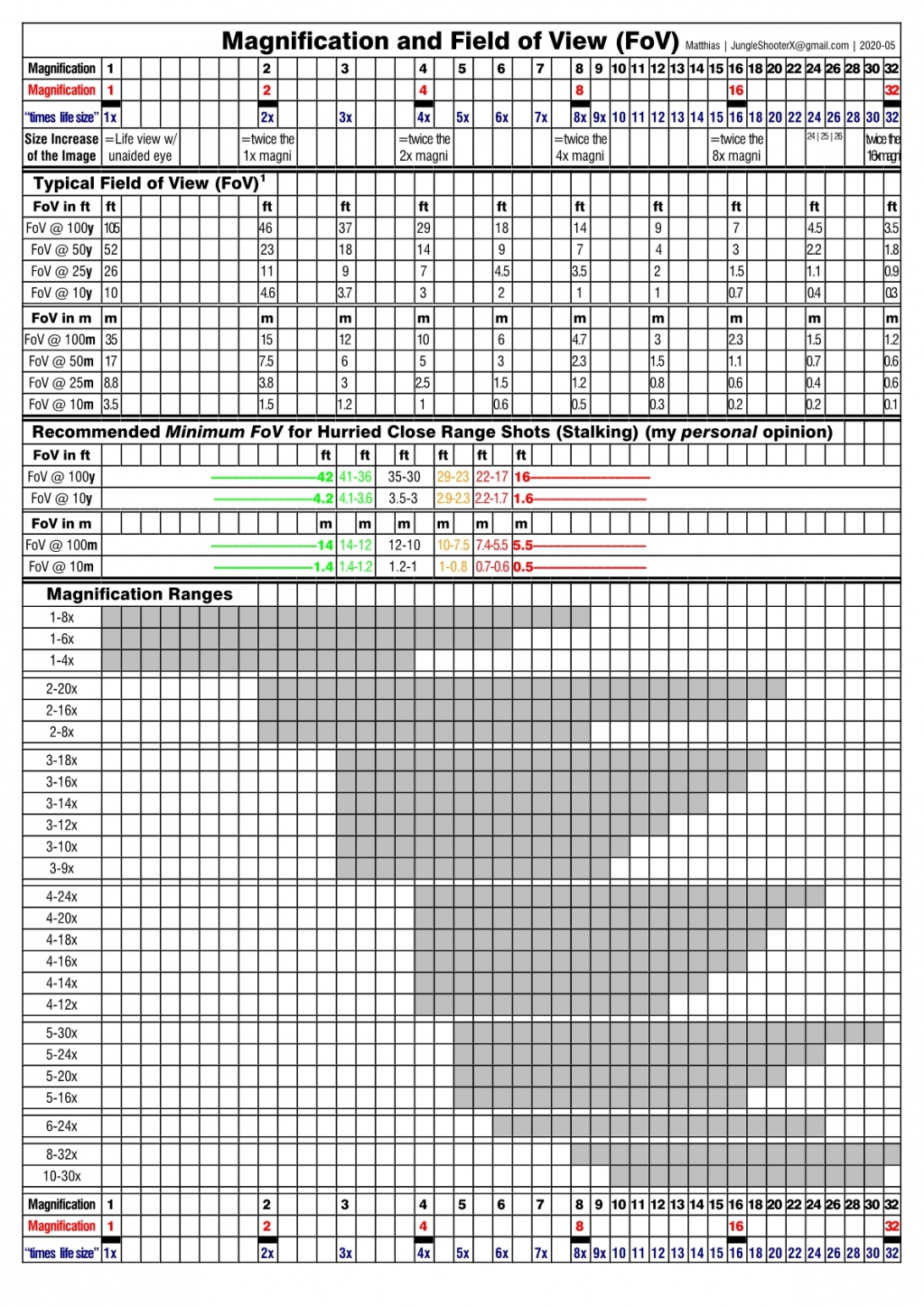

I'll attach a diagram showing different magnification ranges, to compare both FoV and magnification.
And I'll attach a Scope Specs Table for 6-20x and higher — with FoV, FFPs, holdoff reticles, and 10y side parallax.

❌ Magnification and Field of View

Thank you so much for that chart, really helpful! To answer your questions.
A1) My closest shots would be at 25 (shooting paper targets at the range) and approx. 50 yards when hunting
B1) On the extreme ends of the scale, I want to see paper targets down to 25y and my quarry at 100y if possible. Anything less than 25y or past 100 yards is not a priority for me
B2) My eyes are still quite good, no glasses yet!
C) My budget is max $800USD but I haven't really gotten down to picking a brand/model yet. I spent a lot of time learning about FFP / SFP, Reticles ect and once I narrow down the magnification level that will best suite my use case, i'd definitely welcome advice/suggestions on specific brands/models

Was going through the chart and PDF you supplied and still trying to figure out how to read it correctly but in the meanwhile in the pdf (abbreviations in the table section) you mention the colour coding but in the chart I don't see any colour coding or colour abbreviations, it's all black and white, am missing something?

Thanks for the updates Matthias, they are extremely helpful! One thing i'm still noticing is that the pdf references colour coding but the entire document is black and white. Is there an error when converting it to a PDF or is it something on my end?

thanks for checking. 👍🏼 So, there are NO color at all in the pdf?
The loss if color must be on your end, it seems. My comp + phone show the colors in the pdf....
Maybe the phone or comp is using a funny app/ program to view the pdf...?
I'd make sure to Right-click — Open-with Adobe Acrobat Reader....
Can anyone else report if they DO or DON'T see any colors? 😊
