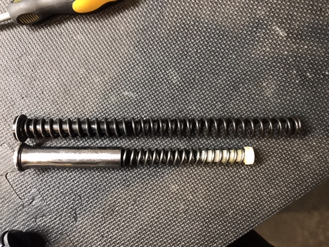

I purchased a new Vortek PG3 sub 12 ft lb kit to install in it to tame it. Once installed properly, I think it will be super accurate, easier to cock, and not nearly as hard on scopes. The Vortek kit came with two thick shim washers. My goal was to get the rifle to as close to 12 ft lb of output as possible, shooting the 8.4s at somewhere around 800 fps. Everything went back together perfectly, except when I try to cock it, it won't lock all of the way back into battery,. I thought maybe the shim washers were causing the problem, took them out, still the same thing. I used dummy pins, but thought maybe I screwed up the safety spring and that was the issue, checked it, it seems to be ok. I have had it apart now at least a half dozen times, and don't know what to try next. There is about 1 1/"2 of preload on the spring compressor, so I don't understand why this issue exists.

Does it feel like it is cocking all the way back and just not latching or does it feel like it’s bottoming out early.
Sounds like you checked the safety. That one trips people up sometimes.
If you open it up again I would measure the spring and count coils and compare to the factory one.
I’ve had good luck Vortek kits. Might not hurt to drop them a line.
Thanks, guys. The good news is that it wasn’t me. After 6 hours of sleep, I decided the next step was to put the original spring back in and see if the rifle would cock. As you can see in the photo above, the new Vortek spring is considerably shorter than the the original factory spring. It felt like the cocking cycle was bottoming out with the new spring.
Once the original spring was re-installed, with al of the other cleaning, polishing, and lube work I had done, the cocking cycle is now smooth, quiet, and perfectly complete.

Great service received from Tom at Vortek. He called this morning, responding to an e-mail I had sent Saturday am.
He figured out over the phone that the top hat stem was too long. Told me how to diagnosis and trim it.
I followed his advice and am now headed down the right path. I will post the final tune results in a separate post.
