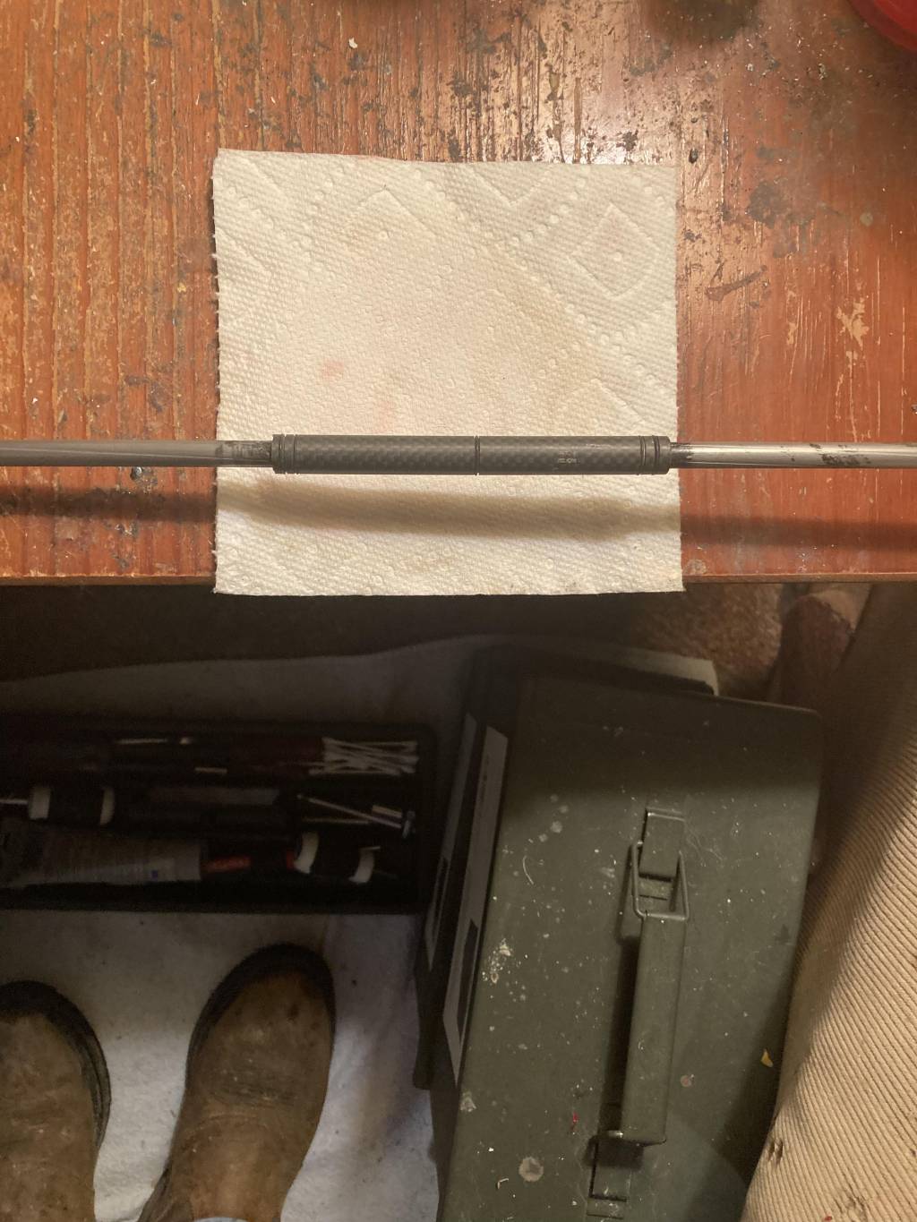

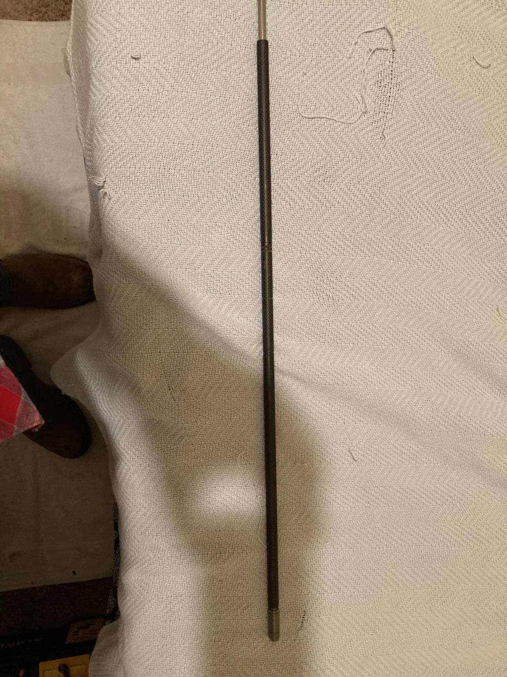

I went to put my carbon fiber sleeve on today and when I pulled the barrel out there was a piece of carbon fiber 4 and 3/4 of inch long glued in the middle of the barrel how do I remove it heat cut it off preferably some way of not damaging the barrel any help would be greatly appreciated thank you James kiser

At this point you are probably better off cutting 2 more sections and glue them on the ends after cleaning up the barrel at the joints. With glue I expect there wouldn't be enough flex at the joint to make a difference.
As others have pointed out carbon is nasty stuff to be grinding or sanding and there is a good chance of making a bigger mess.
If cheap epoxy was used you might be able to heat it in order to pull the sleeve off. Got an outdoor oven - it will stink and smoke.
