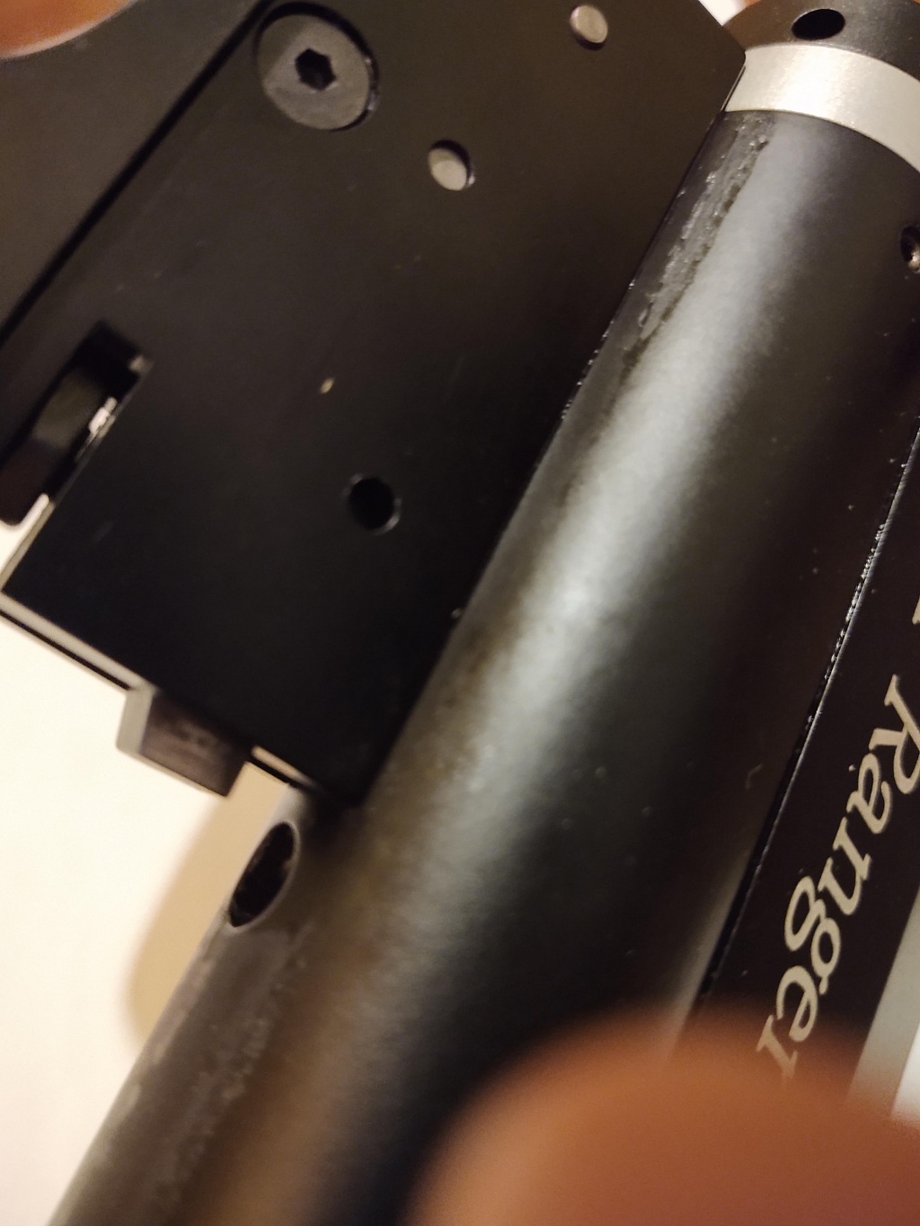

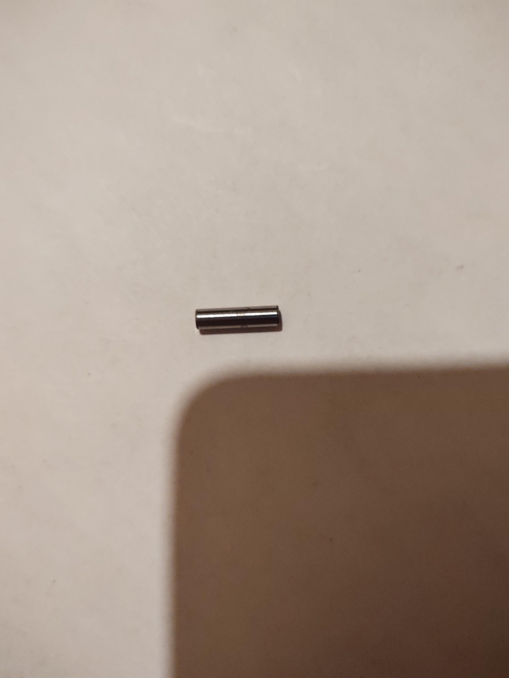

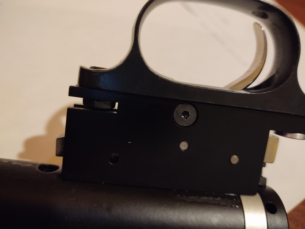

My Air Ranger had an small leak in the charging port and with the limitations of the pandemic I decided to try to fix it myself.
I cleaned the filling port, put all pieces in place and refilled the gun. The leak apparently was gone.
But the rifle can not be cocked. The bolt comes back without preparing the shot. So it does not shoot anymore.
What should I do to make the rifle able to be cocked again?
I will appreciate your feed back.

Does it index the mag at all, or does the bolt come back to the rear with no clicks or anything?
Have you tried pulling the bolt to the rear and trying a little more oomph on it at the end of its travel?
The travel of the bolt is continous and not clicks nor any other feeling that efort. It returns inmediately.
The piece that moves the magazine moves bach and forward normally.

For reals though, when you pull the bolt back, do you feel any resistance of the bolt contacting the hammer and overcoming the hammer spring or is it just a smooth pull back with no resistance?
