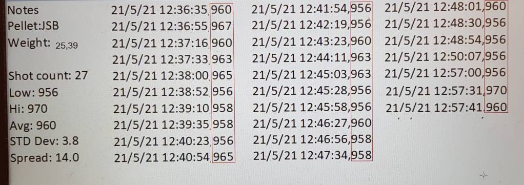

Great results with the superior standar 600mm barrel and the JSB redesigned 25.39g!
Reg 140 bares, trigger 17 mm, FV 7 mm
std dev: 3.8
