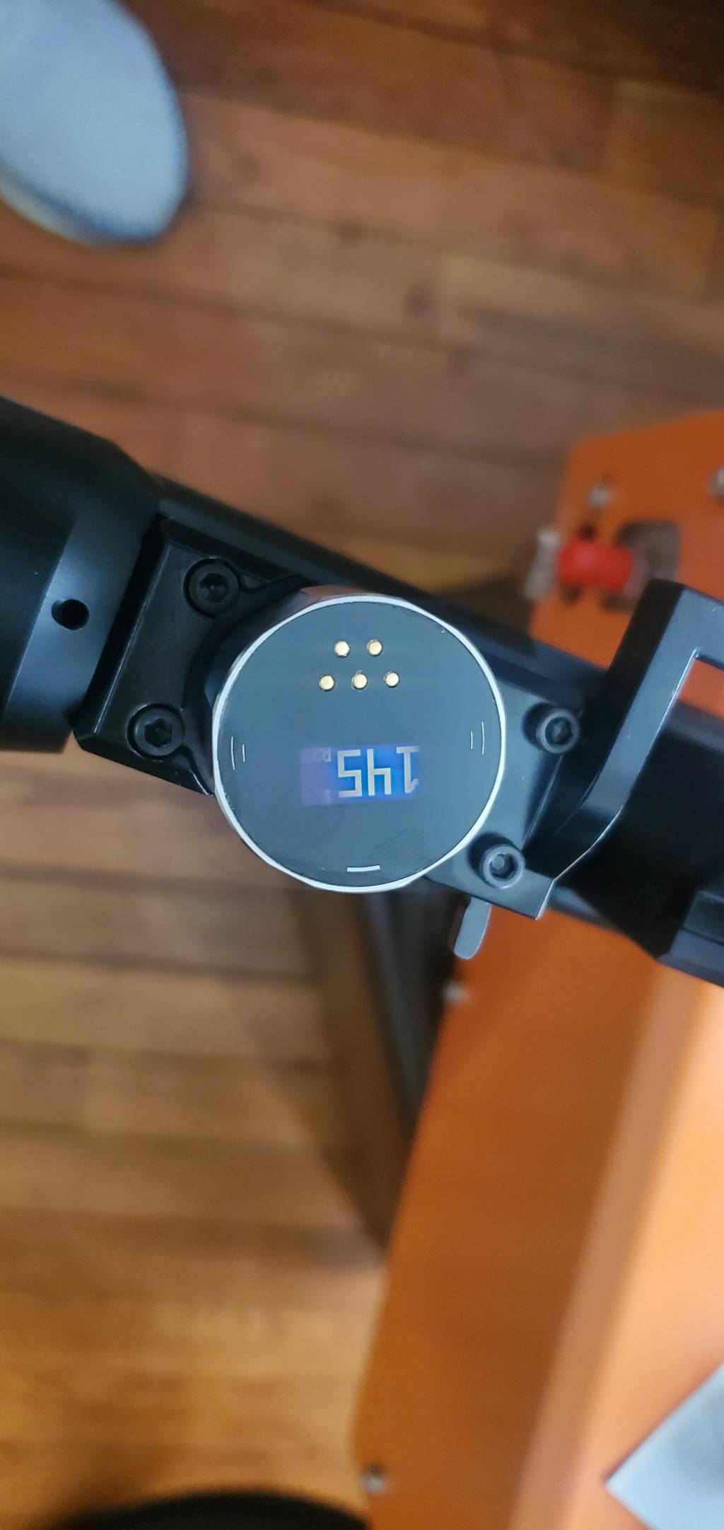

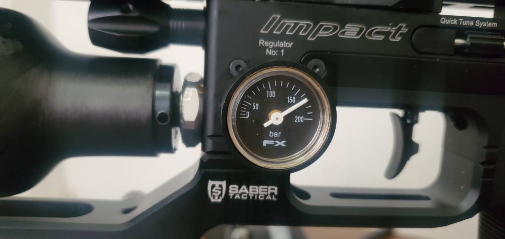

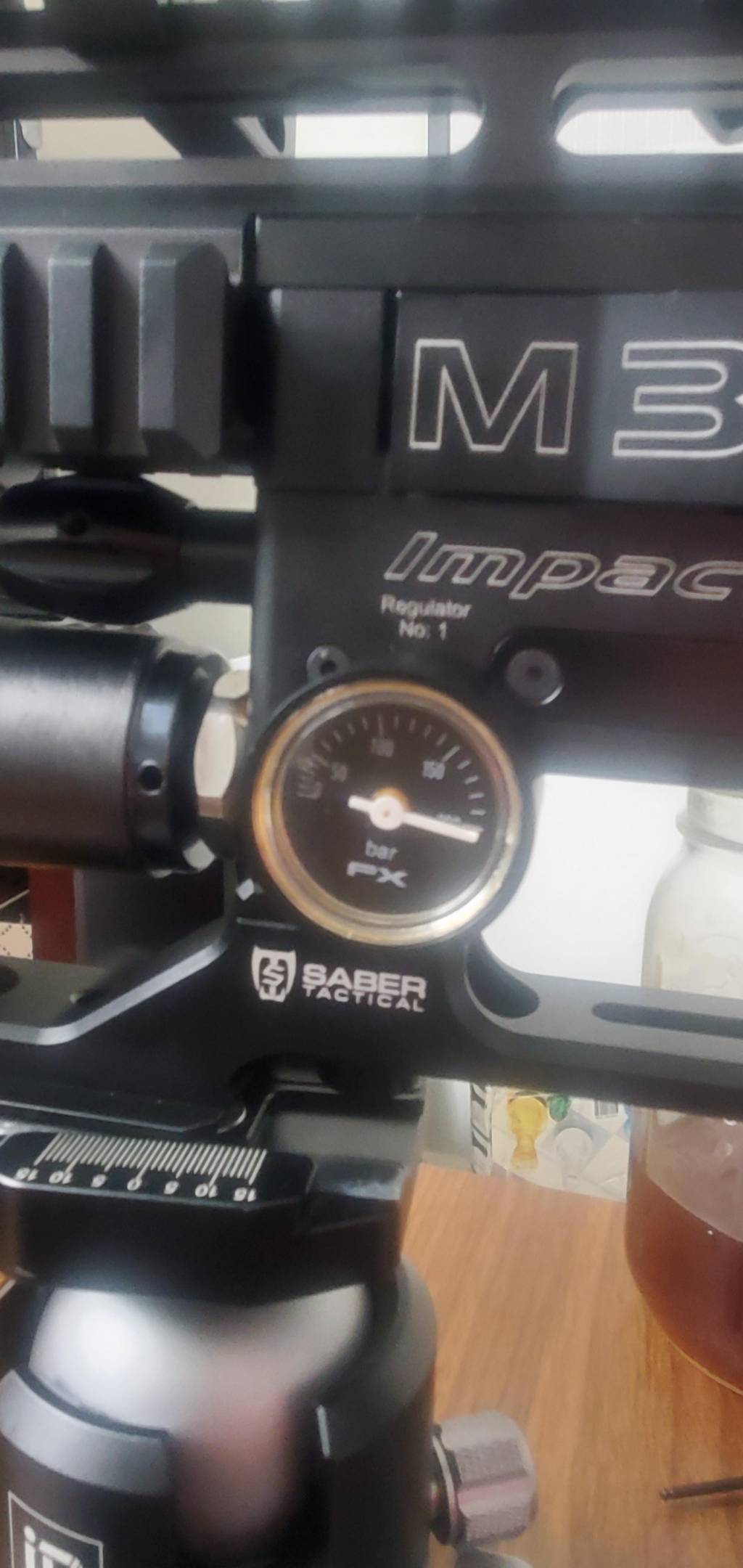

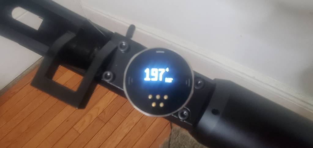

OK so this is my 1st PCP, I bought the Impact M3. It obviously came factory tuned. The only thing I changed was I put on the Ernest Rowe transfer port.
Then I tuned it to:
- 1st reg - 170
- 2nd Reg - 145 (I bought the Sekhmet gauge and it was settling on exactly 145/146)
- Hammer spring is currently on 12 (But I Haven't shot it much, I live in NYC so I have to find someplace outside the city before I can really shoot it)
- Bottle is filled to 250bar
So the problem is the pressure is constantly changing on it's own. So Saturday, the bottle was full at 250 bar, and I had the regs at 170 and 145. I shot it maybe 5-6x and the next day the bottle has already dropped to 210, the 1st reg is now at 200 and the 2nd reg now is at 197. I will attach pictures just so you can see I am not crazy.
