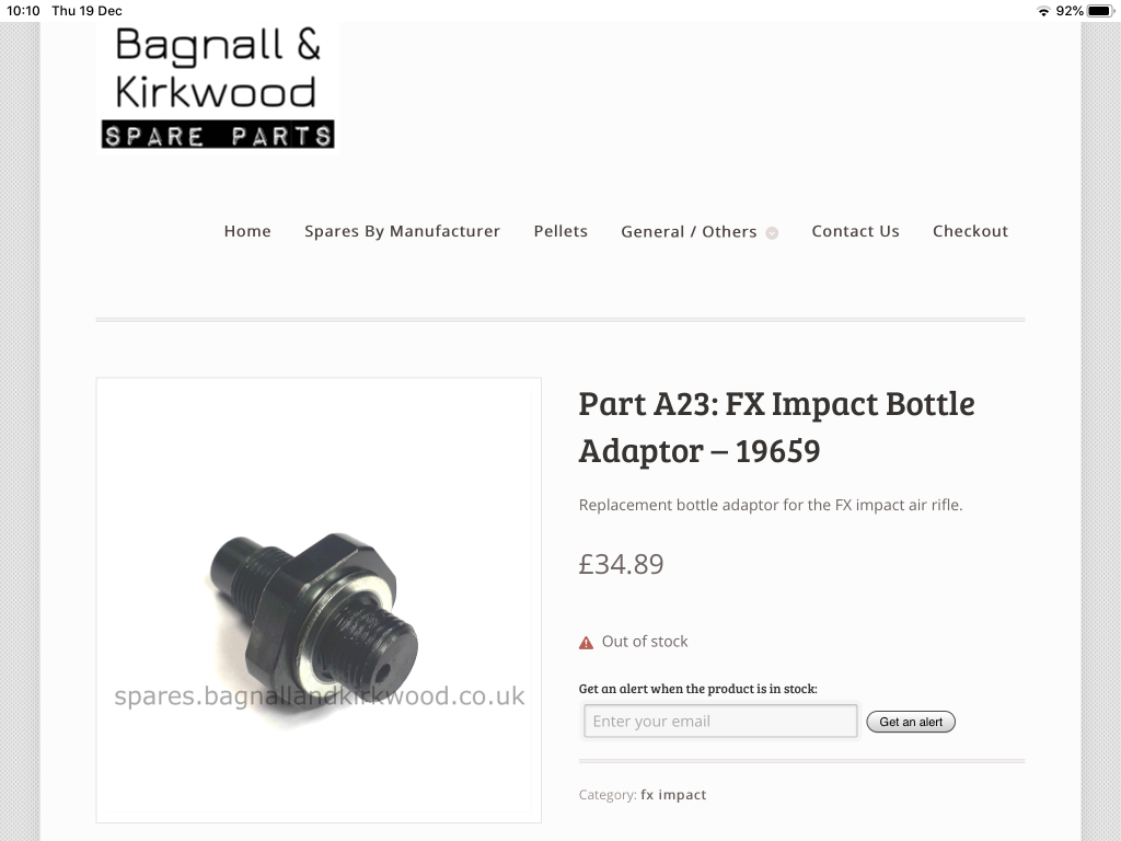

Can someone point me to a source for an adapter to fill FX buddy bottles directly? To be clear, I need to fill my bottles when they are NOT mounted to the rifle
I’ve searched for hours and can’t find anything. Seems like it should be available somewhere (I have the fitting that allows me to fill my Theoben bottles this way). A US based source would be best, but I’ll order from anyone at this point.

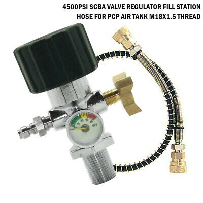

This might work: https://www.ebay.com/itm/M18x1-5-Thread-4500Psi-SCBA-Valve-Regulator-Fill-Station-Hose-For-PCP-Air-Tank-/372694051407

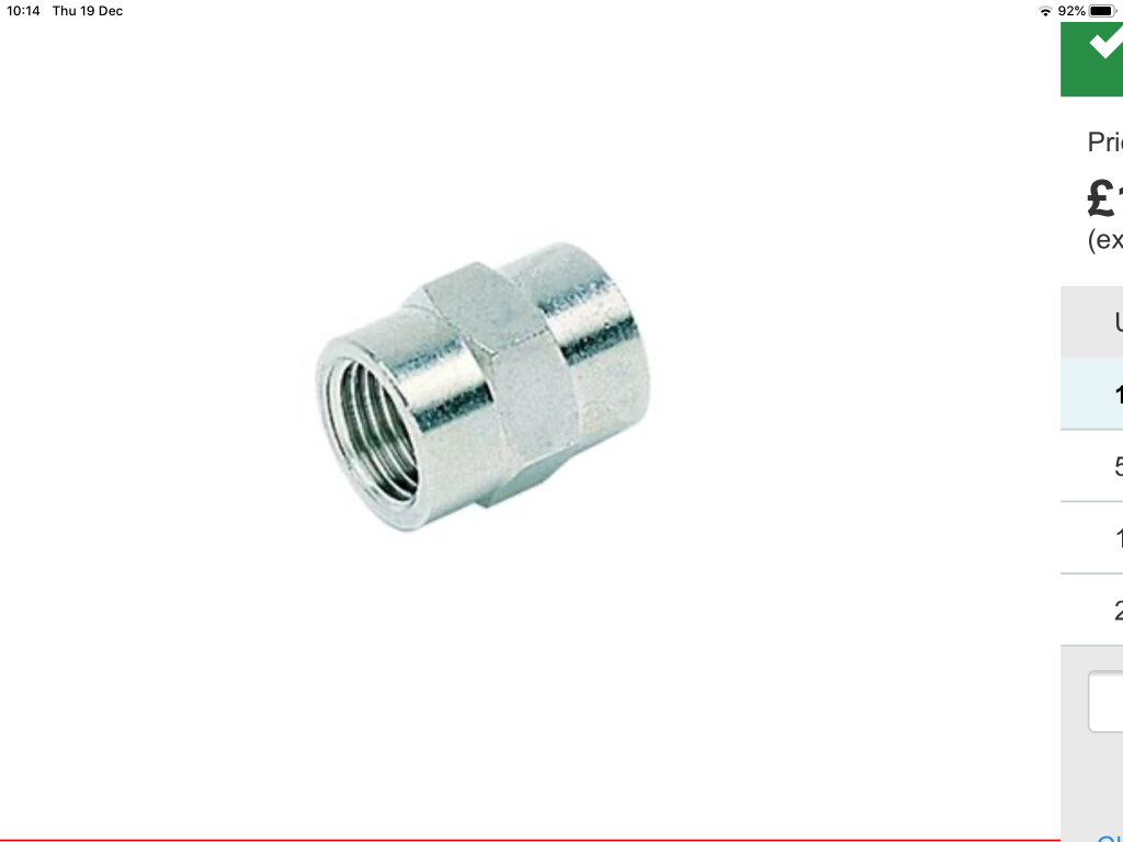

I havnt been able to find a double female m18x1.5 union to save my life.

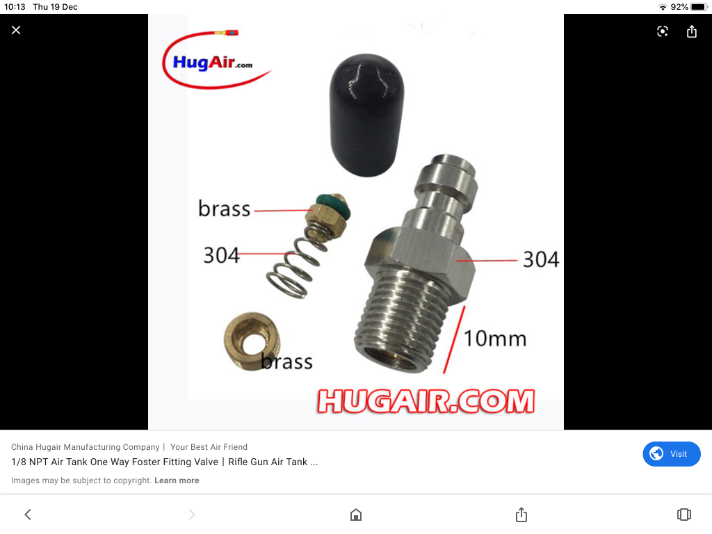

The q/f will likely be 1/4bsp, I don’t know what size thread the fx bottle adapter is (I know the thread in the bottle is M18) but I am sure that if you get the parts any hydraulic parts supplier will be able to sort you out a fitting to join the two together.

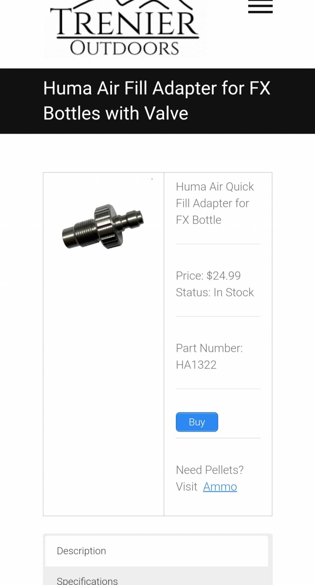

the other way is get a fitting that goes directly from the charging tank to the fx bottle adapter.
screw this
into this

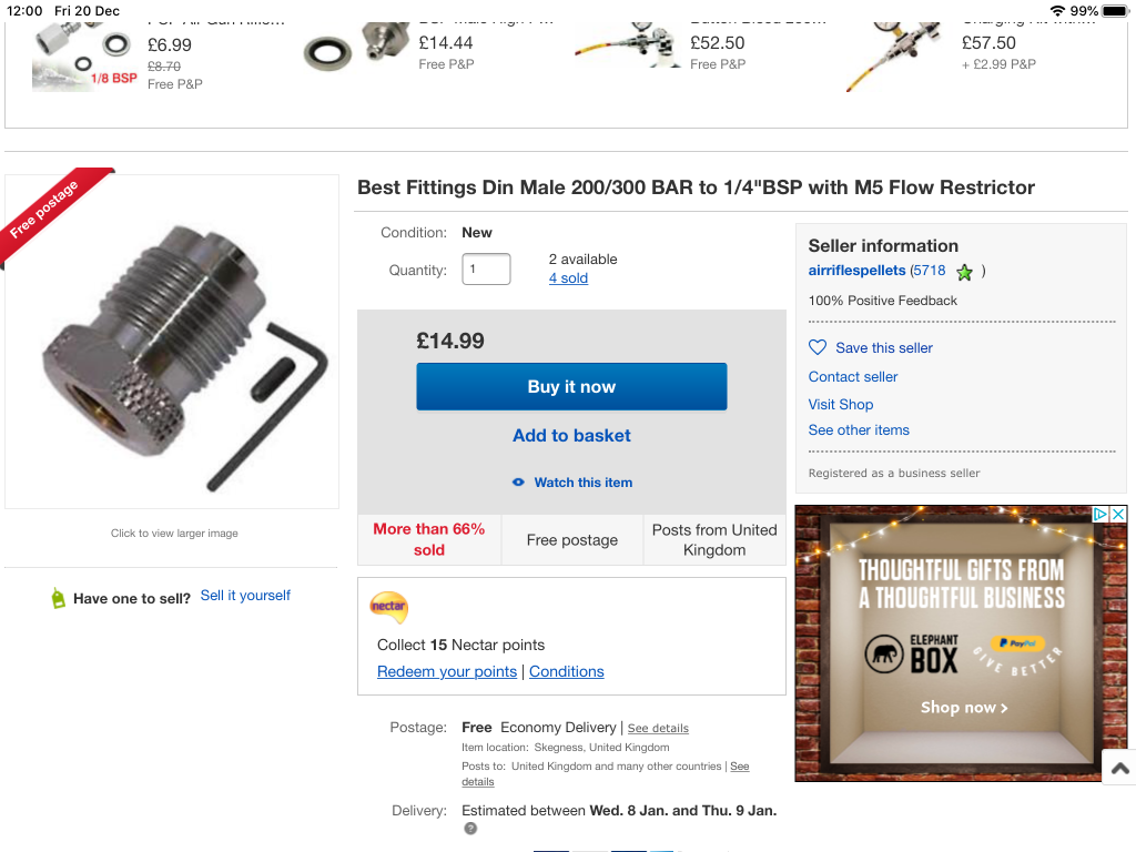

1576843371_15893642785dfcb86b3b97c8.45613804_5E992341-ED2F-41AF-8E6A-56BEE9A821E7.png
