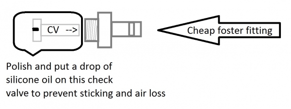

Remove the cheap foster fitting, pull the check valve, polish it a little and put a drop of silicon oil on it or rub a little silicone grease on it and reassemble to stop your air leak.
https://imgur.com/6WKdckD
Cheap foster fittings don't have a spring loaded check valve and this causes them to stick sometimes. The cheap check valve will look like a slotted machine screw with no threads.

My gauntlet was doing this randomly and I can only assume the line bleeder wasn't letting the pressure out fast enough for the unsprung check valve to close. If I released the female foster it would pop and blow the o-ring out of it then the male would seal. After cleaning up the inferior Chinese check valve my problem was solved.

Sorry about the late reply to everyone trying to help me. Jwrabbit123 understood my situation I would try the fixes provided by rodeo and heavy-impact cause im almost sure the problem lies in the foster check valve or near it. Bluecup yeah It would be better to leave this problem to a pro, but there its no authorized shop in my country. So the options are fix it or buy a new pump and pray the problem wasnt in other place.
