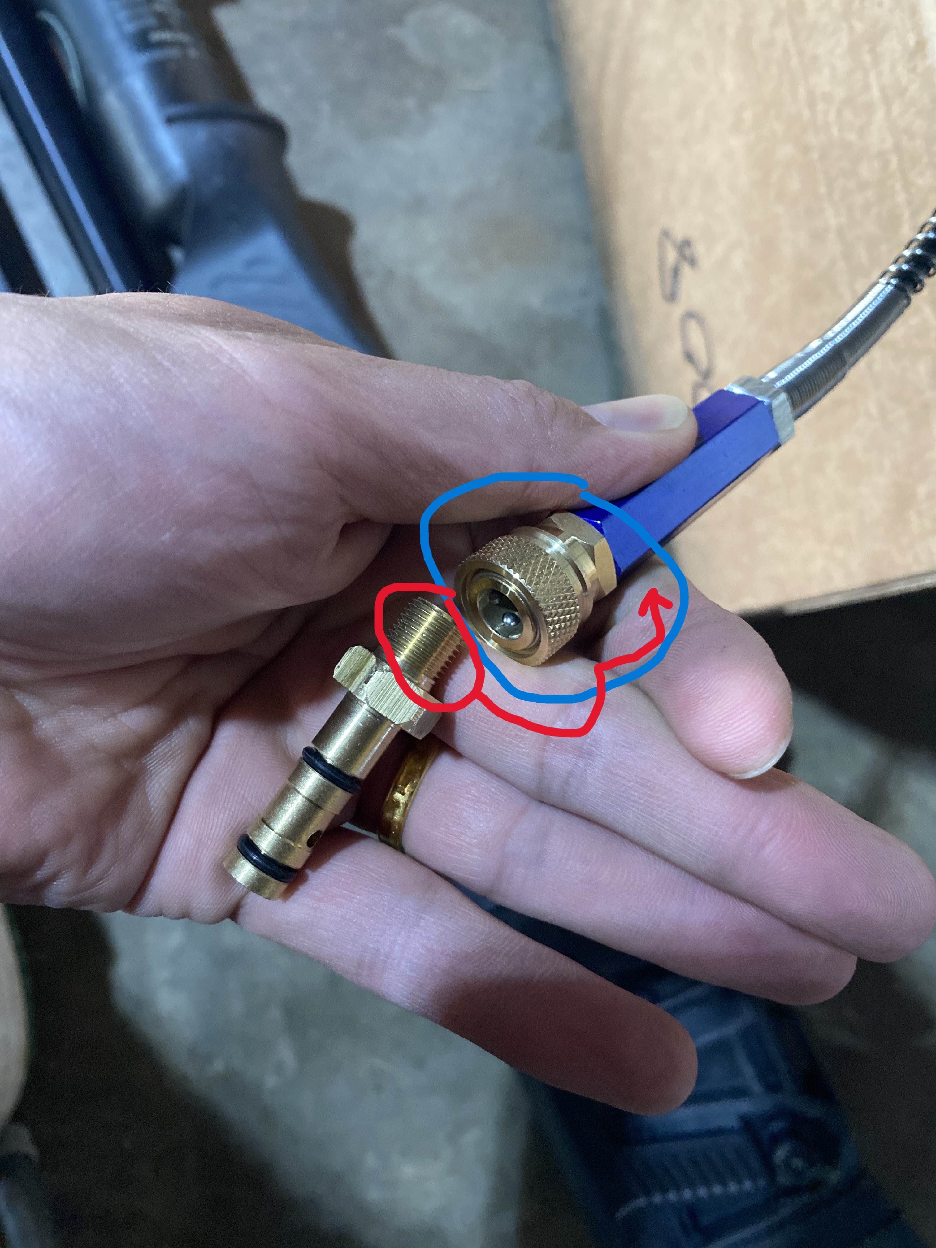

无法连接,是否需要适配器,在哪里可以买到?刚收到新枪,压力表显示为零,这正常吗?(没有要求商家放气)

Yes its normal to ship pcp with near empty tank. Unscrew the quick disconnect from the blue filter housing and compare the threads of the fill probe. If they are the same then screw on the fill probe to the blue housing.View attachment 361059ll
It is better to buy the female foster adapter. That will allow you to keep the probe in a place protected from air and dust and therefore o'rings will last you working the longer.
