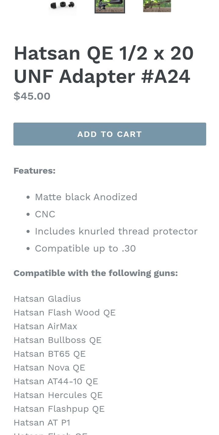

Not to mention you can get one of these for it.
https://donnyfl.com/products/hatsan-qe-1-2-x-20-unf-adapter
Now we are talking!
