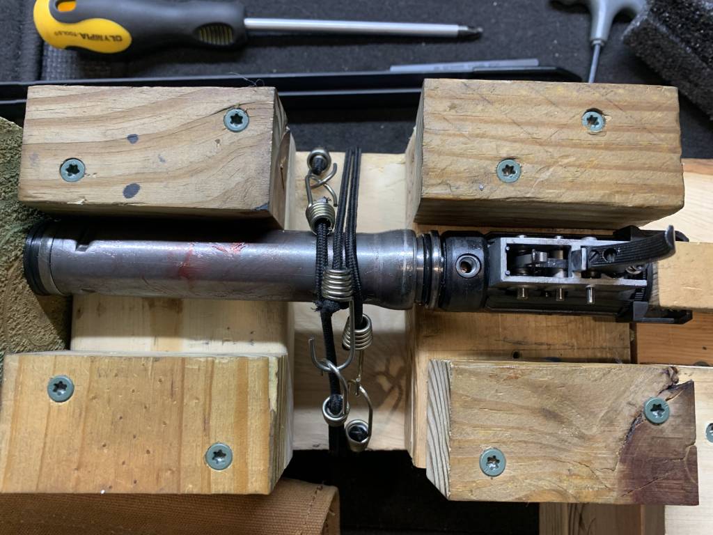

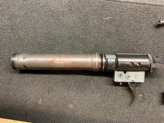

I was able to get the breech block out but as you can see below, it came out with the HO spring still fully compressed, not something I am really excited about. For safer purposes, I put this assembly into my home made compressor until I can figure out how to release it.

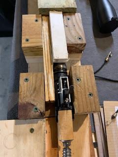

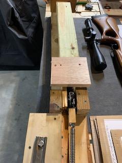

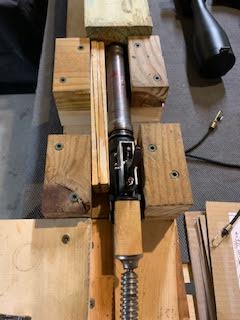

Update - thought about this situation much of the night. Decided to encase it hardwood and shim it tight - see photos. It is a good thing that I did. Once I was certain the piston was secure, I started pulling trigger pins. After pulling the last one, I reached in and touched what I assumed was the sear catch, and all hell broke lose. The breech block jumped the press block and flew about 10 yards down range and bounced off of my concrete vault wall. The trigger was damaged in the process. Going to sell the stock and remaining components on the classifieds. Someone can purchase a trigger and put in it , or use the stocks and parts on a 54 or 56. I am done with messing with it.
