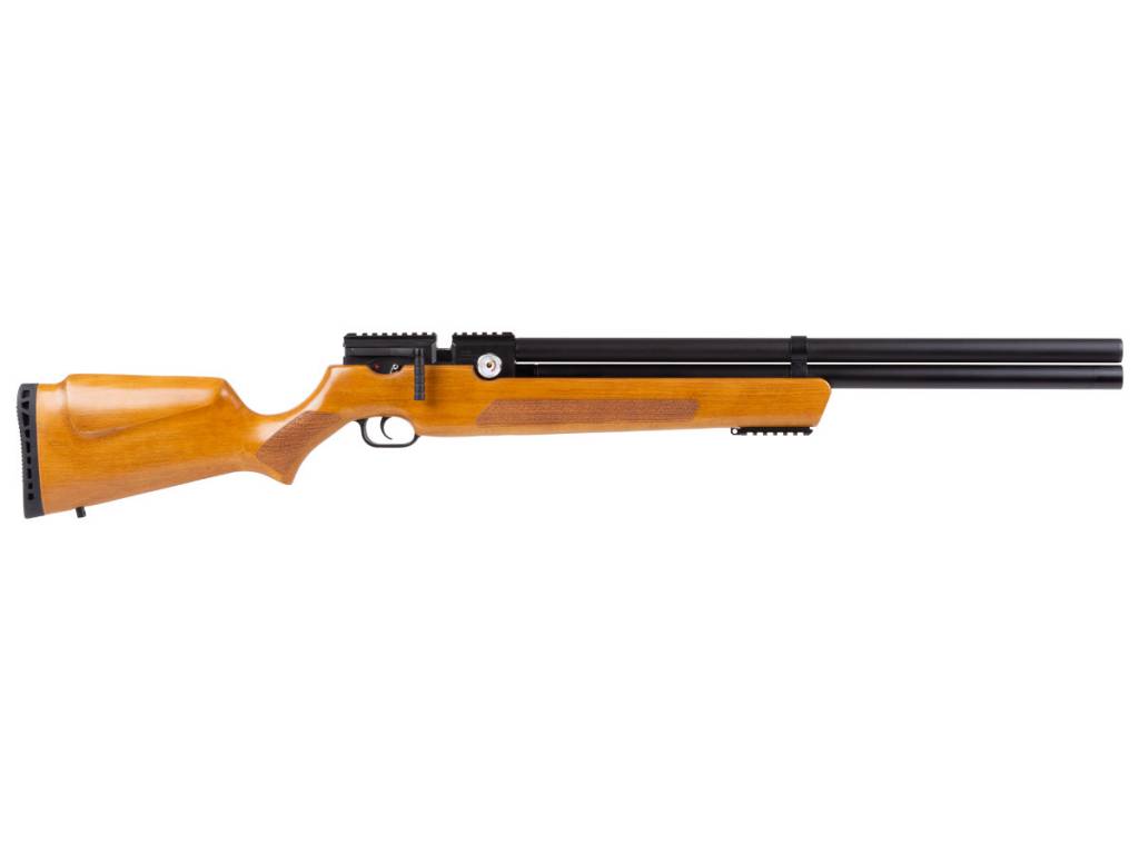

There is a wood stock version of the Avenger coming soon....
https://www.pyramydair.com/s/m/Air_Venturi_Avenger_Regulated_PCP_Air_Rifle_Wood_Stock/5307
$429.99
(Estimated in-stock date 05-24-21)
