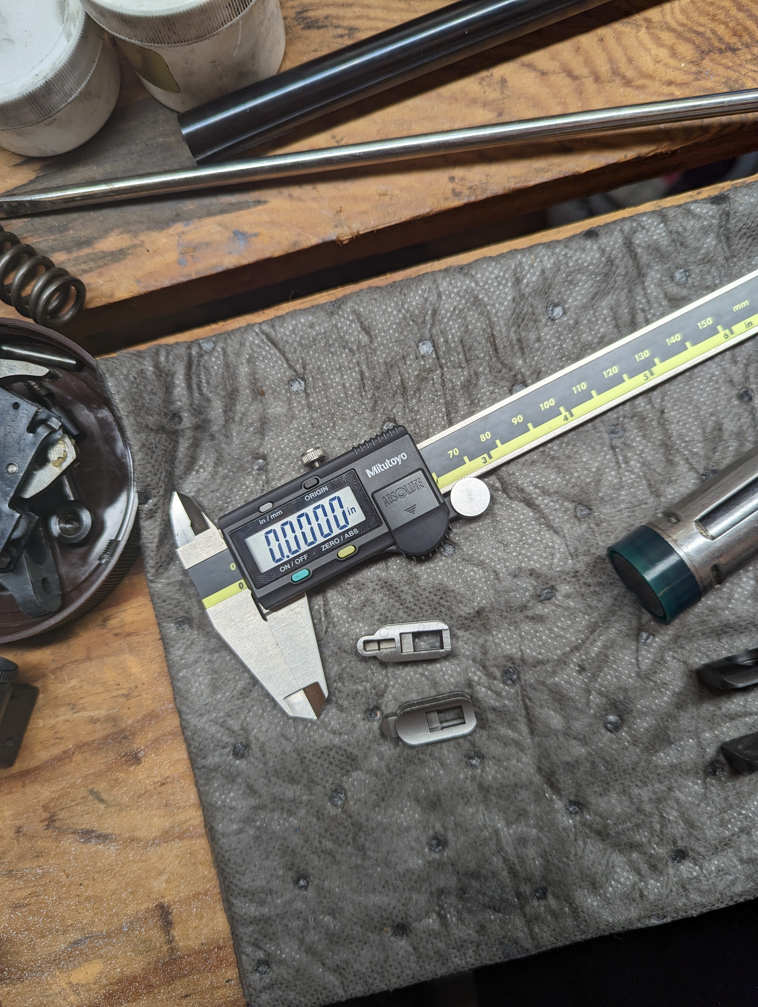

I’m building a new gun from scratch. I need the dimensions of the length of the shoe, the distance from the arm engagement to the piston slot
the width of the grooves or slot.. .. any others too
figuring if I can use or I have to make my own arm.. When building guns ,it’s always easier to use pre made parts if you can .
The HW80 and the 95 use the same cocking shoe now. There's some useful information.
I have two on the way from the UK with an order of parts now that I placed on the 18th.

Vortek sells two shoe sizes. A 26 mm shoe for the HW 35/95/85, Beeman R series R95, R35, R10. And a 30 mm shoe for the HW 80/90, Beeman R series R80, R90.
I've been trying to order a 30mm shoe for my HW 90, but Vortek is always out of stock. Who did you order yours from?

It looks like Chambers and a couple other places list one part number for both shoes.
Now that I have them in my hand, and looked at some other sources, I believe that is incorrect and there are two different shoes.
I got mine from Chambers Gun spares in the UK. Ordered on the 18th, got them today.
I'll be tearing down an R9 soon, and I can check the shoes out to see what's really what.

l am confident that you need the original shoe for the HW90 and that the new HW80 shoe will not work.
