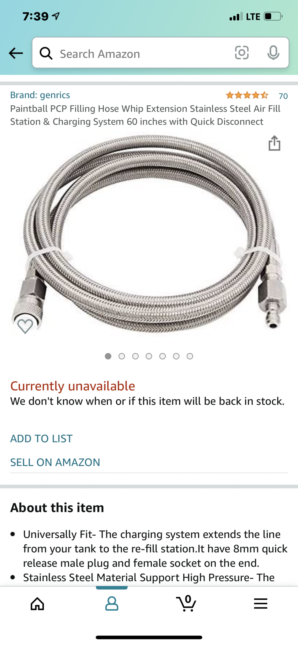

I bought this 6 foot whip on Amazon, it was $26. But like it says it is unavailable right now but they do have some more ones for around the same price. I bought it in August and it has worked fine for me just attaching it to the stock whip on my air Venturi nomad.
