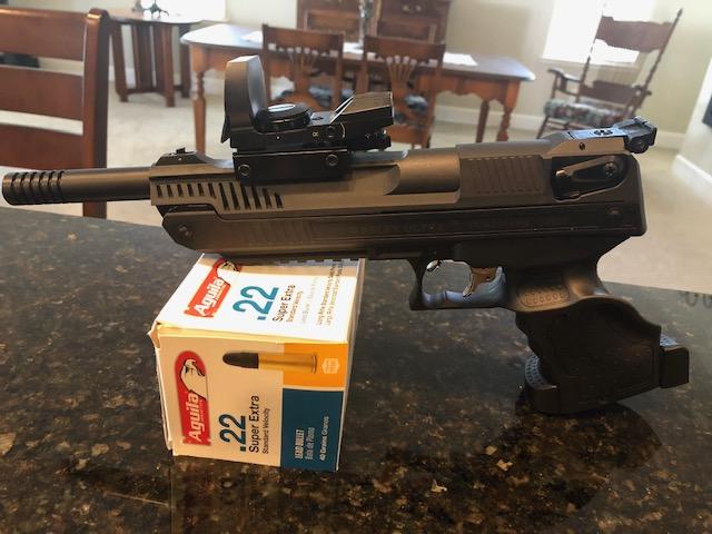

If budget is not an issue, I would go with the .22 Zoraki HP01 Ultra(AKA Webley Alecto). They are laser accurate, more powerful than 1322, target style grip that makes it easier to hold the gun steady, adjustable trigger, solid open sights. It only requires 4 pumps for full power compared to 10 pumps for the crosman 1322. Made out of rugged ballistic polymer that will last a lifetime. Hands down the best pistol on the market in the pump/ springer category. They may seem pricey but for all the features it offers they’re well worth it!

Alecto is no longer available in th US.
crosman custom shop 2400, long breech, 14" .22 LW barrel, shoulder stock, red dot. Aka rat catcher. About $165. Plus shipping.
They still are.
The last one, an Ultra, got sold about a week or so ago:
https://maxarmory.com/search?q=hp01
They replenish their inventory in very limited numbers though.
Have not seen the .177 in about a year.
Awsome!
i really enjoy shooting mine.
