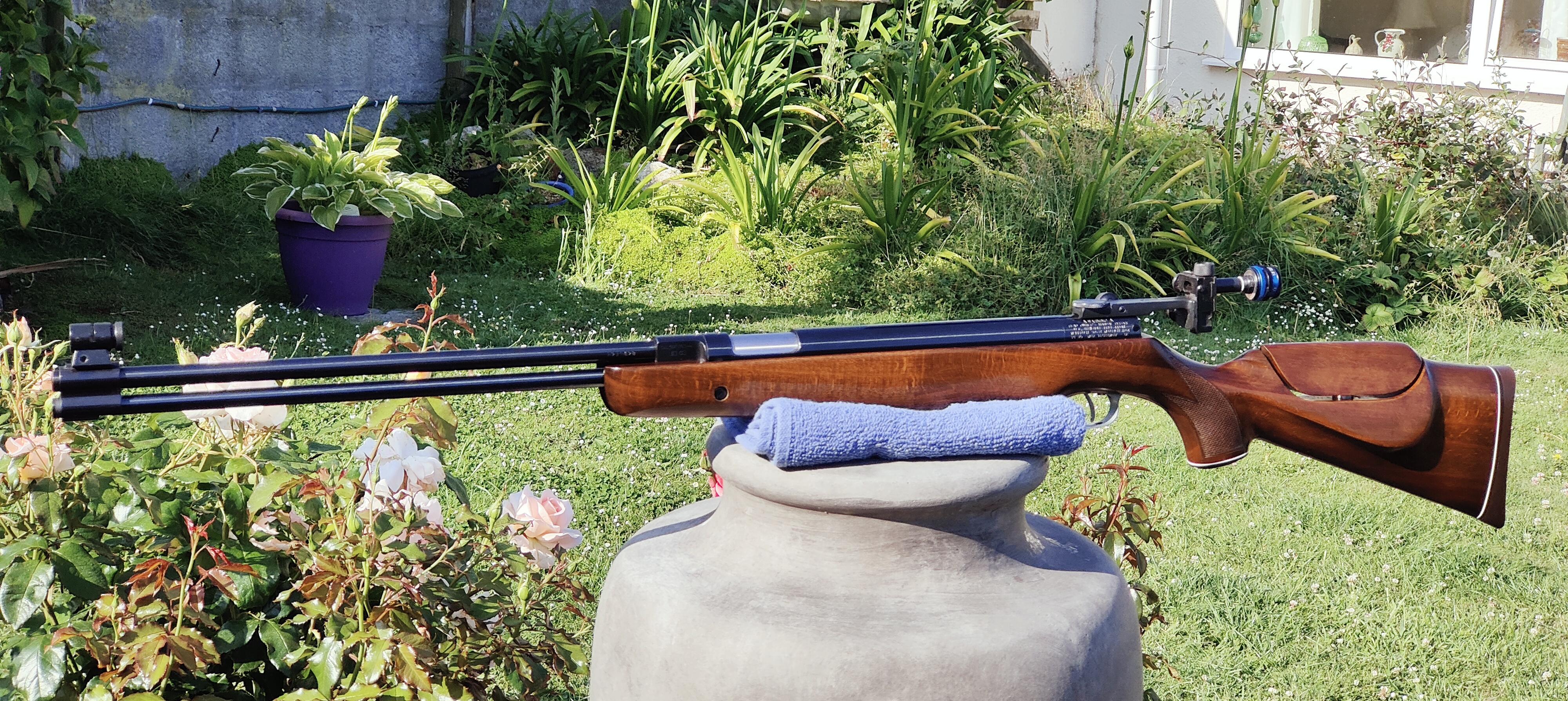

The best springer out there I think. HW77 Long. Heavily modified amazingly accurate. Presently without the stock which is away being refinished. I have only had it a week I cant wait for the stock to come back. The cards were shot one after the other not cherry picked. I have had many HW77's.
