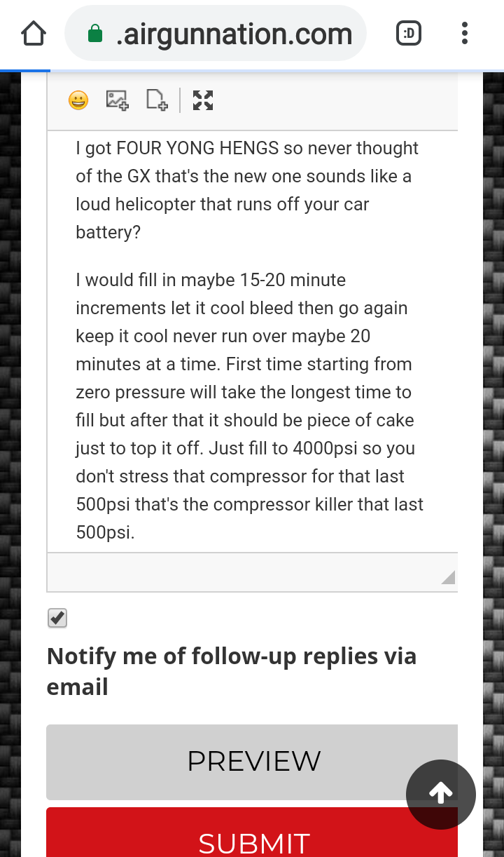

Your compressor should be able to fill any size tank as long as you don't try to fill it in one go. Just fill it in stages and give the thing a rest to cool down in-between stages. Your pump won't know the difference between filling that way and topping your gun off, using the same amount of air.
