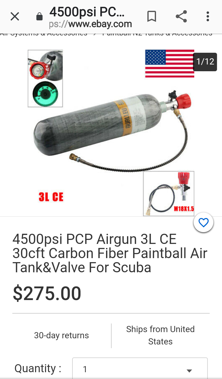

This looks like THE BEST DEAL all you need is a double foster male to plug your female quick connect to this female to. It is more than 6x capacity of the RAW Daystate and FX bottles.
https://www.ebay.com/itm/4500psi-PCP-Airgun-3L-CE-30cft-Carbon-Fiber-Paintball-Air-Tank-Valve-For-Scuba/383611851813?_trkparms=aid%3D1110006%26algo%3DHOMESPLICE.SIM%26ao%3D1%26asc%3D225080%26meid%3D184d870b502d4e55b9d16e13bbadf73d%26pid%3D100935%26rk%3D2%26rkt%3D12%26mehot%3Dpf%26sd%3D293633061969%26itm%3D383611851813%26pmt%3D1%26noa%3D0%26pg%3D2332490%26algv%3DSimplAMLv5PairwiseWebWithBBEV2bDemotion&_trksid=p2332490.c100935.m2460

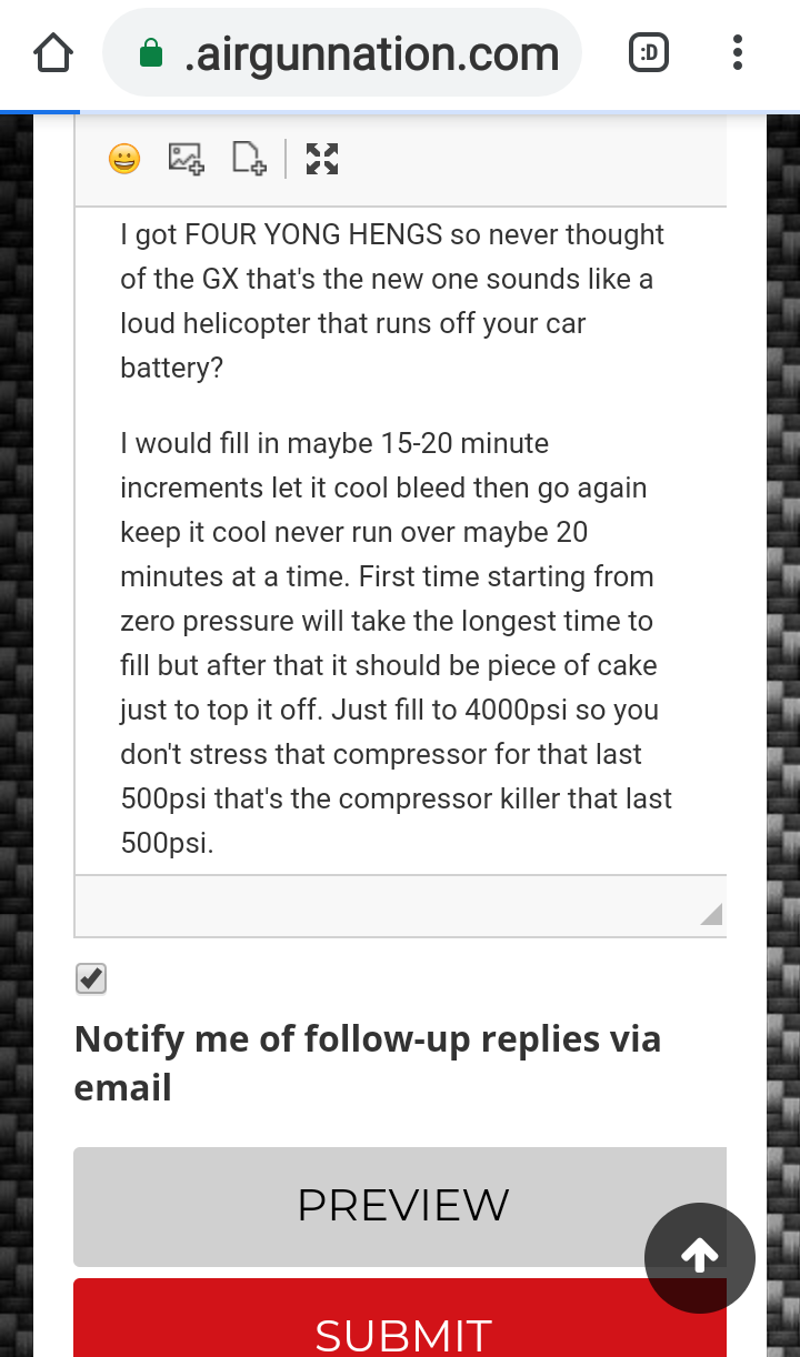

Ok thanks yo, if you have any experience with the gx compressor do you think it could fill that?
Even says make offer. There's a limited number of offers you can make till you are locked out from making any more offers with a seller maybe 3 IDK.
Maybe start at $205 offer then up $20 each decline till you get LOCKED out.
Theres auctions at like $130 - $144 for this same tank too do a search similar items eBay maybe bid?
Alright i’ll look into buying that one then, then let’s just cross our fingers my compressor can fill it. Thanks.
