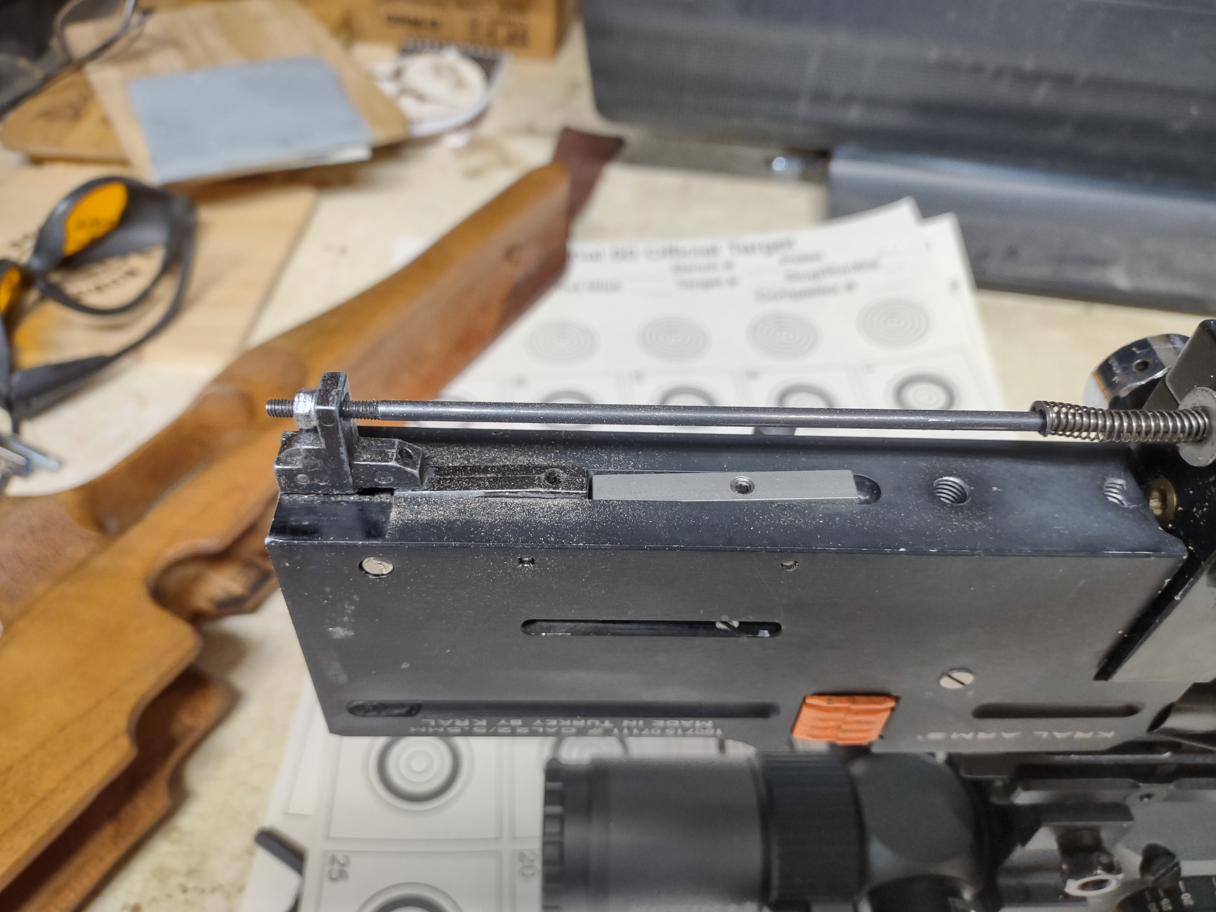

Have had my Kral for about 6 months. Like it quite a bit. Went to take it out and shoot a little this morning, and the trigger was frozen. Safe or Fire, no change. Wife then told me, 'oh, it fell over a couple days ago'. Off comes the stock, but I'm not familiar with how the safety area/bar should look (I'm pretty mechanically inclined). If someone could post a pic or two of how an operable safety looks, I'd appreciate it.
Here's how it looks currently:
Thanks in advance fellow pellet throwers.

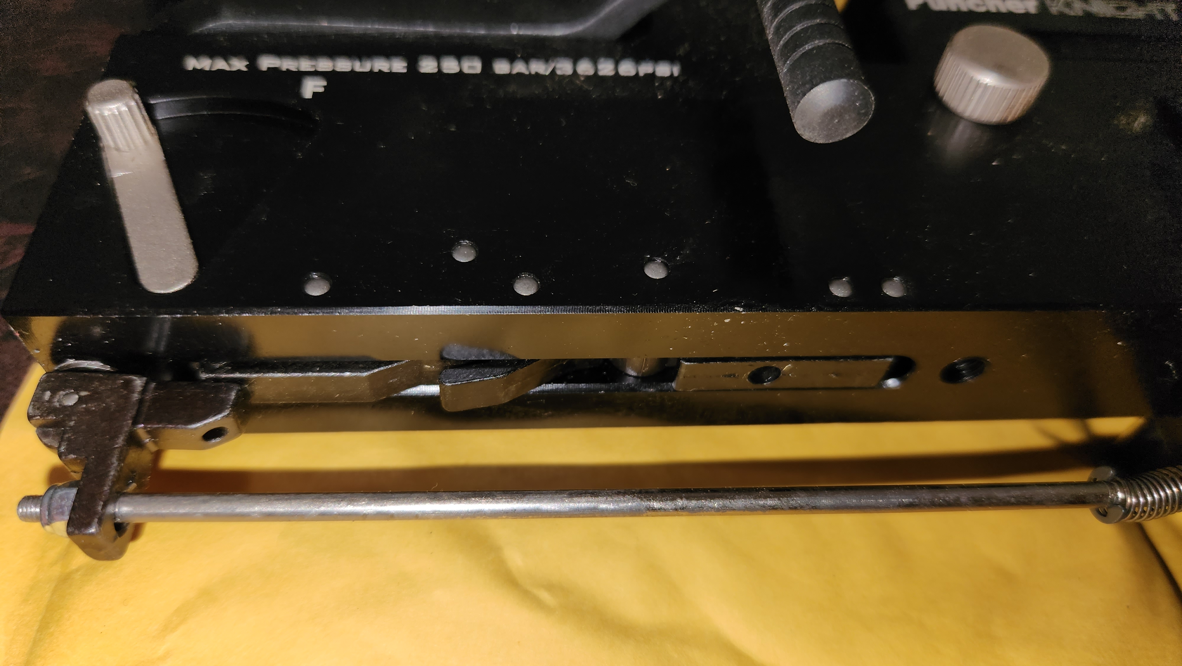

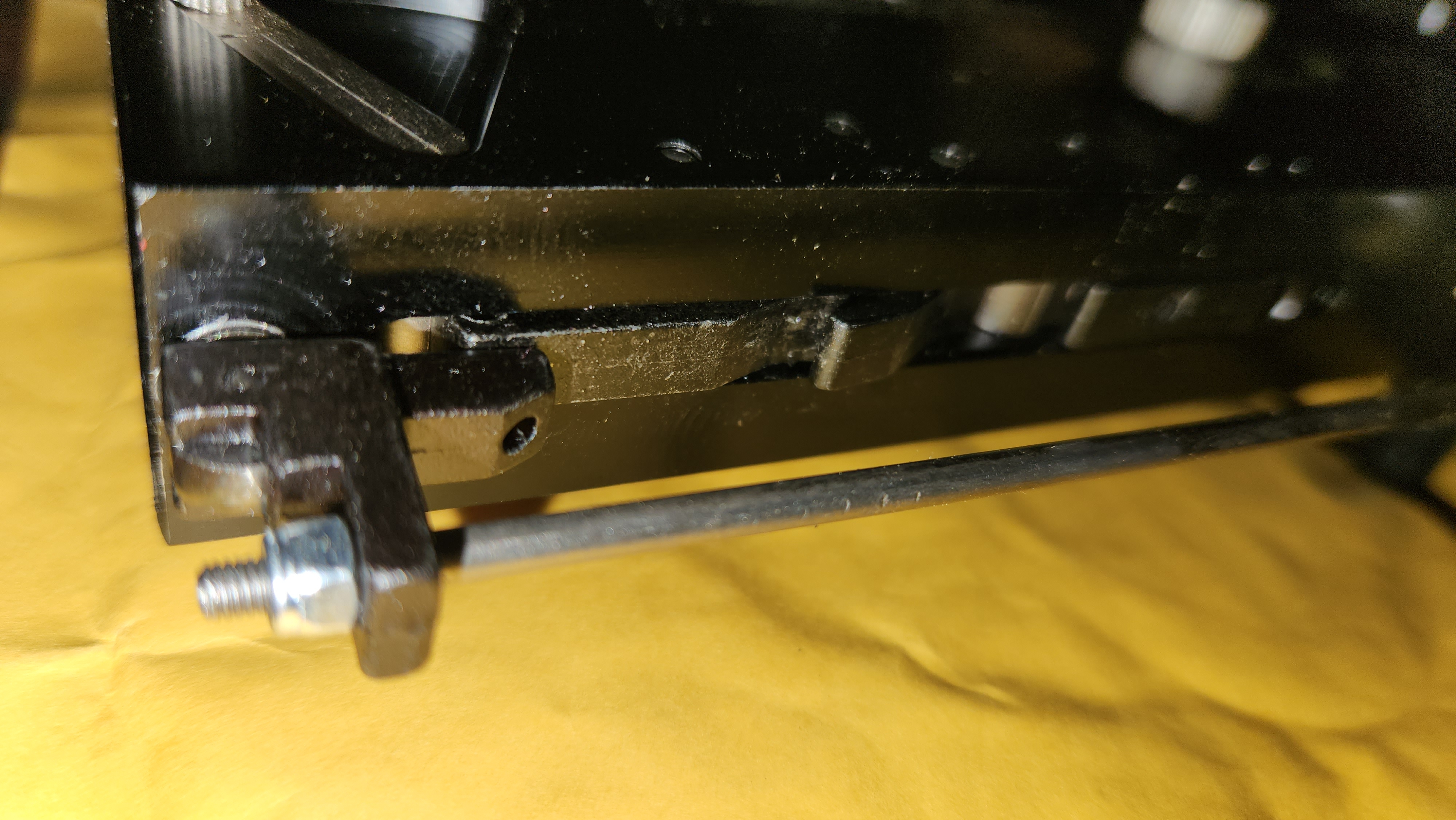

There are three rocker pieces to the action. One of yours is out of place. The middle teeter-totter does not look like mine. I have a first run, gen 2 gun...
The trigger pulls on the connection rod. The connection rod is capped by a hex nut. That hex nut pulls on the knob (technical name??). That allows the knob piece to pivot forward. That is where the safety locks the action. The knob piece pushes down on the teeter-totter piece. The other end of the totter piece pulls the sear away from the hammer. There are press fit pins that lock the pieces in place. Under the teetor totter piece, there are two different springs. Put them back like they come out. Heavier spring to the muzzle side, iirc
I've not modified the trigger at all (was happy with how it was). I'm wondering if I may have a newer variation, as the sear looks nothing like your pic. There is no evidence of any breaks or pieces, also the number of drift pins is substantially higher on mine (only see two in your pic, there are six on mine.

No worries....totally understand. I've probed around it some, checked to see if the drift pins were well captured or not (they are) and anything else I could do that I knew would be non-destructive. I've looked until I'm cross-eyed for a schematic or diagram of the trigger/sear/safety assembly, but couldn't find anything that would clue me in well. I'd prefer not to send it in for repair...but that's looking more like what I may need to do.
