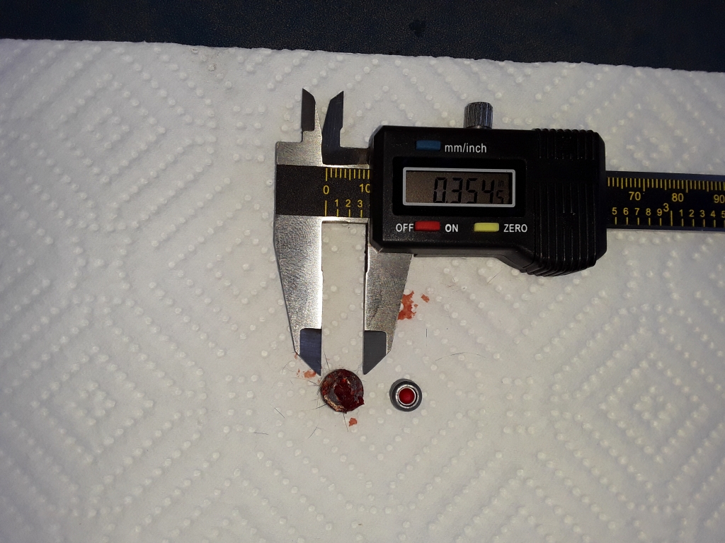

I dug this .25 polymag from under the skin, after its having dumped 40fpe into the chest of a squirrel. The damage was pure devastation.
A domed JSB 25.39 would of passed through. I like the expansion and the results.

@kkamrical
Thanks for posting the picture! Nice even expansion.
40 FPE is really whacking a squirrel! Agreed, I use the JSB 25.39s in my Royal and always get pass-thru - the squirrels go down quick though.
Do the .25 polymags shoot as well as the 25.39s for you?
