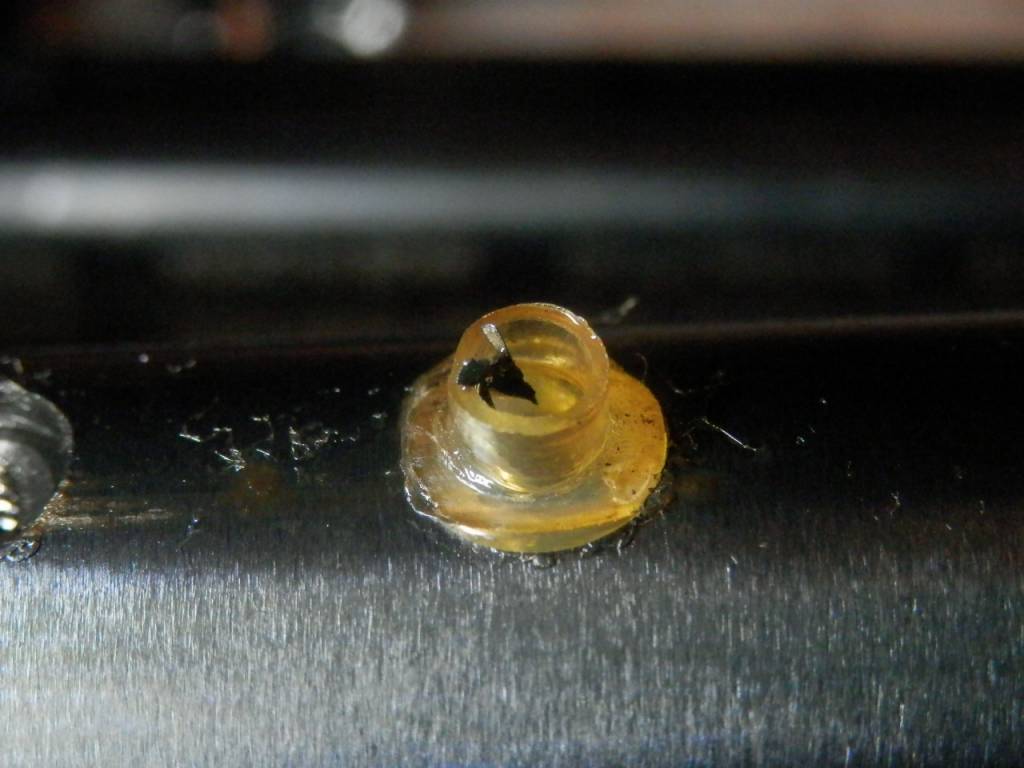

I've been going through a .177 cal QB78 SAG (standard) for a friend and it was shooting 7.9g pellets at just under 600-fps while getting a bunch of shots (over eighty) from a pair of cartridges. When I pulled the barrel off to clean and lap it, I found that the transfer port was very restricted. (See pic.) Now that the seal has been replaced with one with a larger inner diameter, it's shooting in the 660-fps range.
I imagine that you can install a transfer port seal that reduces the amount of gas like his did. The inside diameter of that port seal is .125″ and the outside is .272″. I plan to do some experimentation with my .22 cal QB in the near future to see if a balance of good accuracy and economy can be found.
His gun really likes Crosman wadcutters and Destroyers, so you might give them a try.
