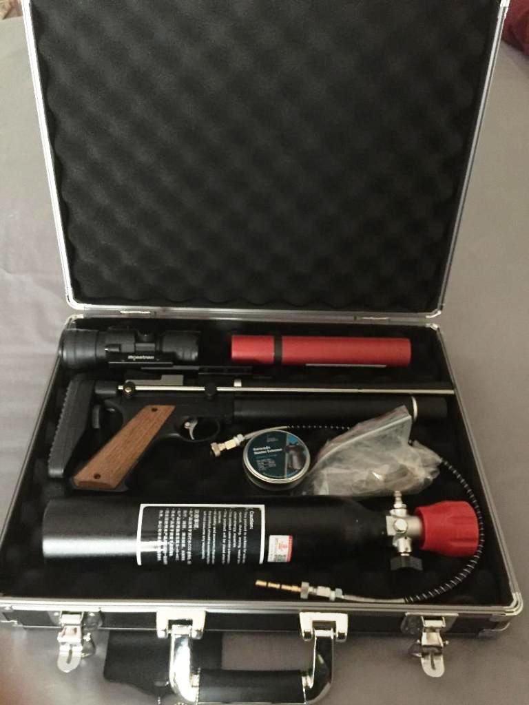

Personally, I have a .5L bottle that fits in the case with my PP750. I can expect a minimum of two refills if I fill the bottle to 4K. Naturally it won't refill my gun to 4K because it has to equalize the remaining pressure in my pistol's air cylinder while "sharing" the available pressure in the .5L cylinder.
With a 30+ full power shot capacity with the pp750, the tiny bottle is all I need for a field trip. Even with a 3K re-fill, I can still squeeze out another 30 shots.
Size of the bottle, in my humble opinion, depends entirely on how you intend to use it.
