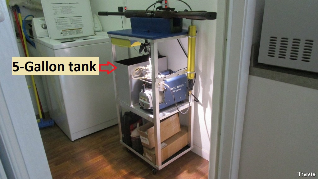

Hello everyone,
This is a follow up on the NAPA Kool “Cooling System Treatment” product. A little over one year ago I added 1/2-Pint of this product to the cooling water in the 5-gallon water tank on my Yong Heng Air Compressor roll around filling station. About 6 months later I added an additional 2-ounces to the water. In this one year time period I did add some pure water to the tank to maintain a “max” water level which is about 1-inch below the brass fittings that pump the water into the compressor and the return line to the tank.
This morning I completely drained the water tank and noticed several positive things:
1) Over the year the water has not evaporated as much
2) No algae growth or scale of any kind
3) The water has remained clean and the Treatment Color “red” has not changed
4) Inside the tank still very clean
5) The water pump clean inside and out
6) Inside the brass fittings are still bright and clean
7) I have to assume that inside the Compressor is just as clean
8) The high temperature silicone tube shows no reaction at all
Bottom line, I am really pleased with this product to help keep the Compressor cool and free of any scale within the water system.
Hope this information will help in some way.
ThomasT

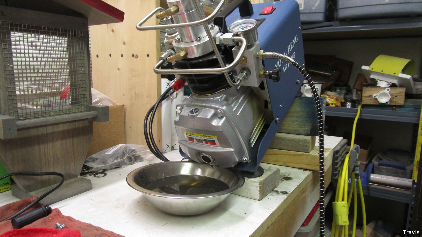

Hello @Ranchibi
Yep, you never are sure about something new until you have had success with it. I'm going to let my tank completely dry out for at least two days before refilling it with water and the NAPA stuff. I let the oil drain for several hours on the compressor. Then with the plug still out I poured just a little fresh oil in and let it run through to confirm all of the old oil had run out. Now the compressor is ready to go :p .

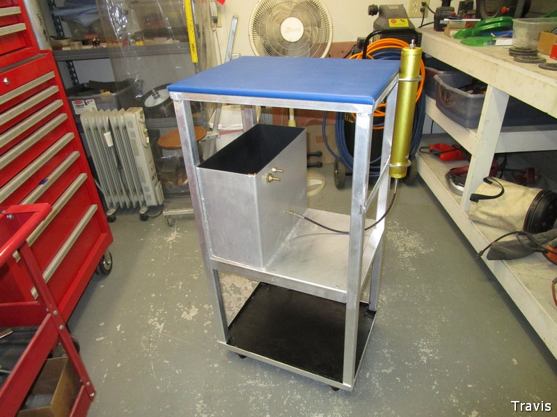

Hello again @JimD
Here is a photo showing the tank construction. One side and the bottom is one piece bent in an "L" shape. Both ends and one side is one piece bent in a "C" shape. This minimizes the number of seams to weld. This could also be made out of steel but would require a good paint job.
ThomasT
