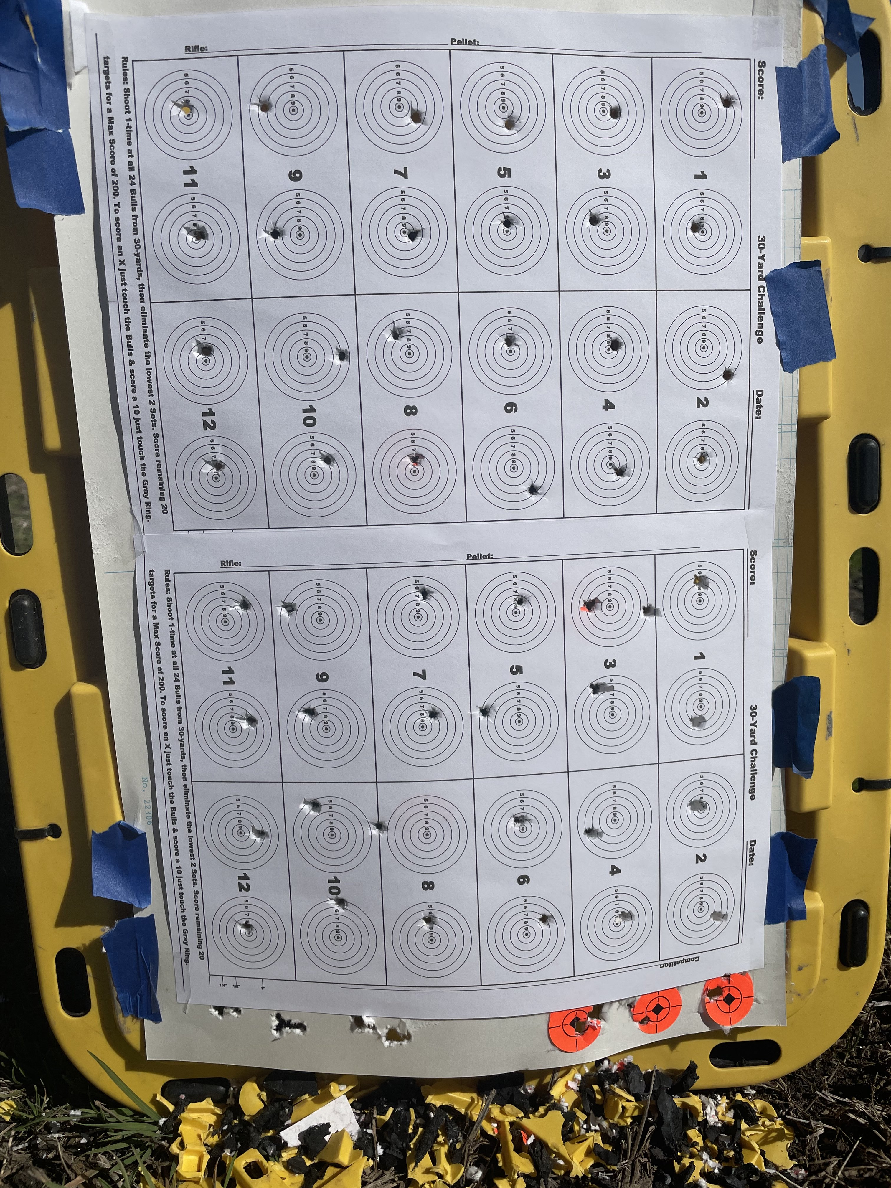

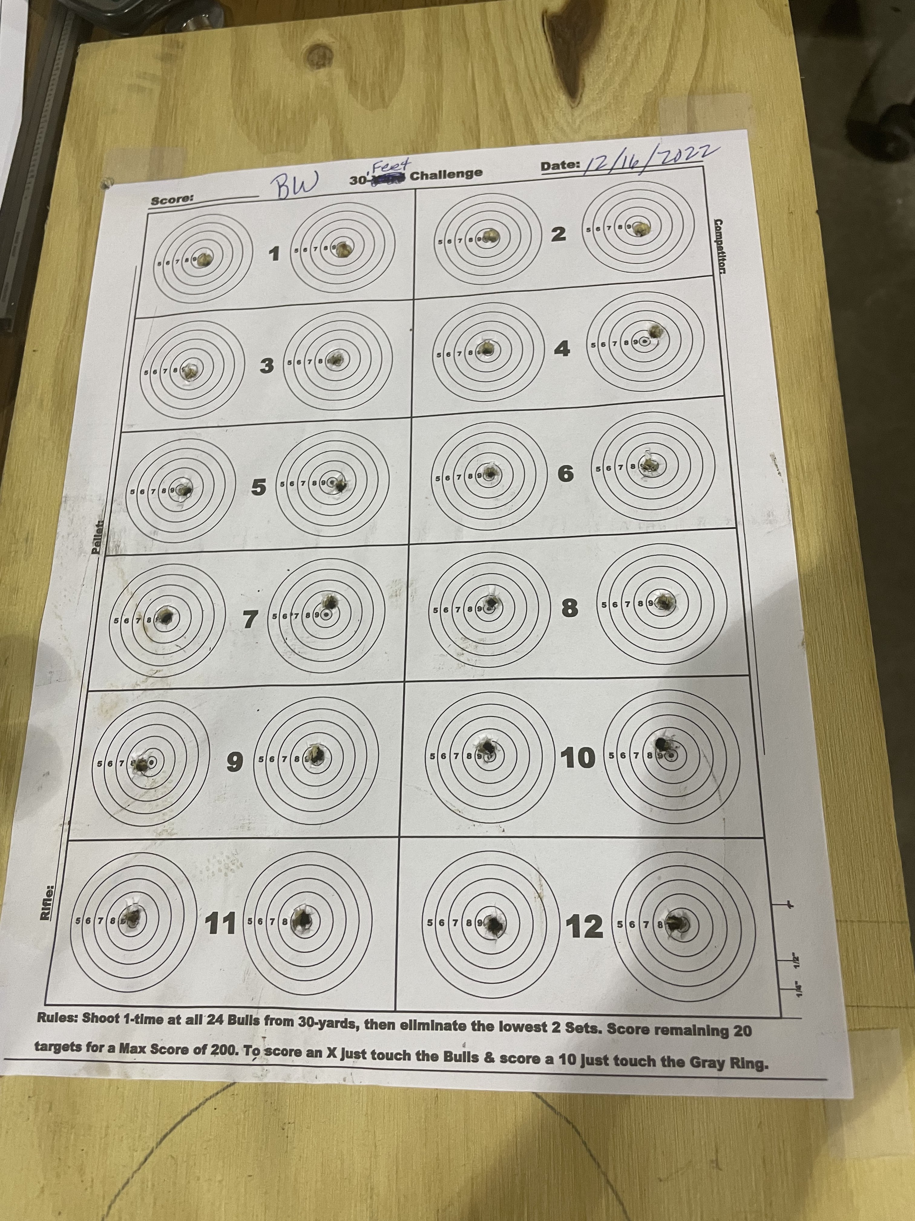

Todays 30 YC @ 50. Light wind. M3 top, V3 bottom..
At 50 yards, ThomasAir, i just dont see how you do it, ive shot and shot and shot. Top card is vulcan 3 on redesigns, bottom is m3 on 18’s. calm perfect conditions..
Which pocket do you carry your wallet and car keys in? Before you shoot your next card try switching pockets. YMMV though.

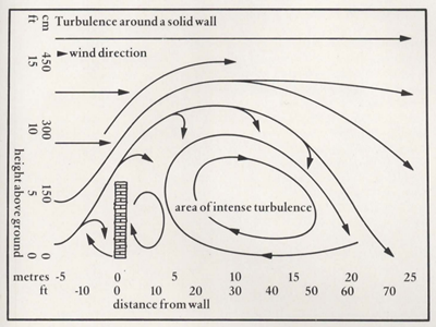

All is well as long as you dont dribble. Im just here tryin to learn. One of my biggest problems with my set up, is that im shooting down a 6’ privacy fence. It messes the wind up. Fence runs east/west, and the wind blows north\south. Today i had a light variable south wind. Flag in front of the target 10” off the ground was blowing due south, and the flag 4’ high mid range was fluttering due north. Moving from right to left, my aimpoint was usually at the left side of the outer ring, i would use my previous shot to indicate the aimpoint for my next shot, and i fired at about 4-6 second intervals… Ill keep practicing, and learning..
