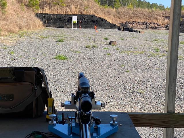

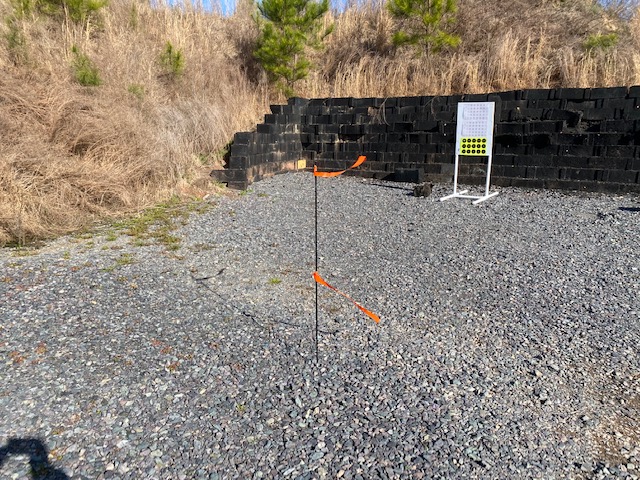

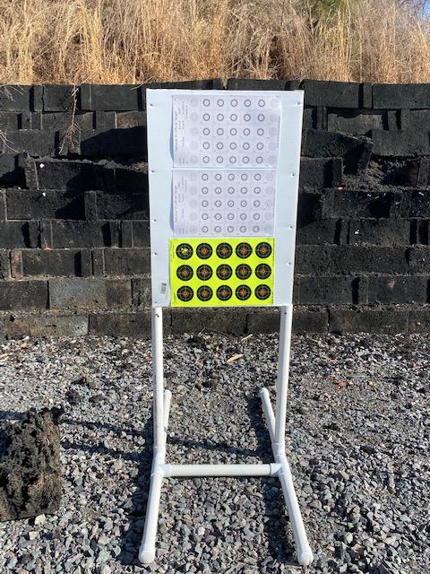

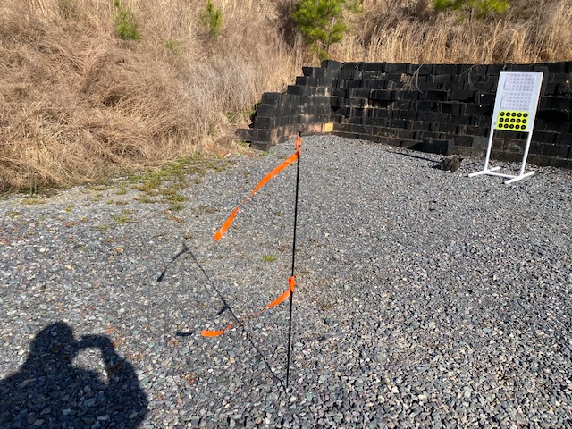

Desperate to get to the range today, even though it was calling for 5-10 MPH on Weather Channel. Shot the Anschutz 1907 .22 LR to see how she would compare against my Red Wolf Safari .22 HP. I picked the wrong day to do this, but I wanted to see how I could do reading the wind under these conditions.

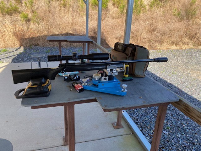

Here are some pics with my setup: Have a real solid mechanical rest as there is no bi-pod for this match rifle. I was told by ANA Custom Shop you need a mechanical rest. Feel like I am cheating with this contraption, but it is fun to play with here.
If you zoom in, I did start reading the wind correctly on some of my bulls as evidenced by hitting the 10 ring. You will also see a lot of missed wind calls, as I have to single load this rifle ( no magazine ). In any case, the RW Safari whipped the Anschutz in my first shooting competition with myself.
Target #2 needs an explanation - I needed more MOA for my 50 yard zero, so I adjusted by No Limit rings and tried to find zero on my splatterburst targets below these. You will see two shots that came from that exercise, so I 'X'd" them out. The scoring sucked anyway even with using my .224" scoring plug. Lol!
Trying to shoot both rifles with these targets under various conditions, but next time I will patiently wait for a calmer wind day before shooting the 1907.

That is not bad Tommy. A couple things to try, make sure both front rest and rear bag are aligned, being offset a little will not help. Moving rear bag placement, also front stop on rest, little changes can make a difference. There are torque settings you can try also.
The ribbons will limit your success in reading the wind, they help don't get me wrong but not the full effects.
