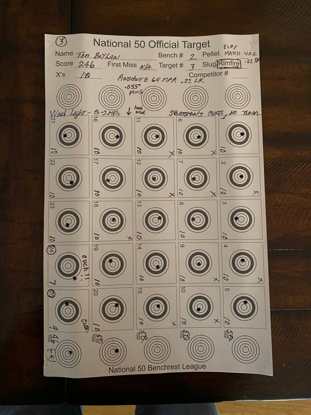

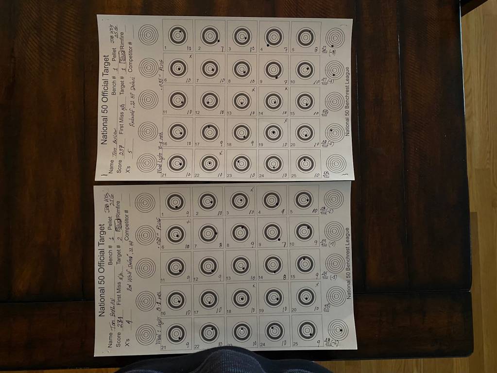

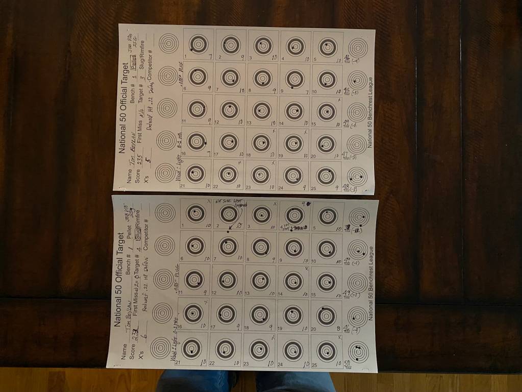

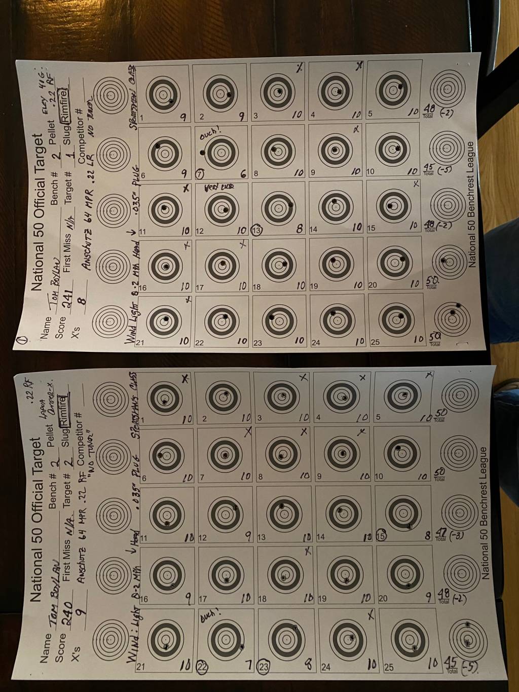

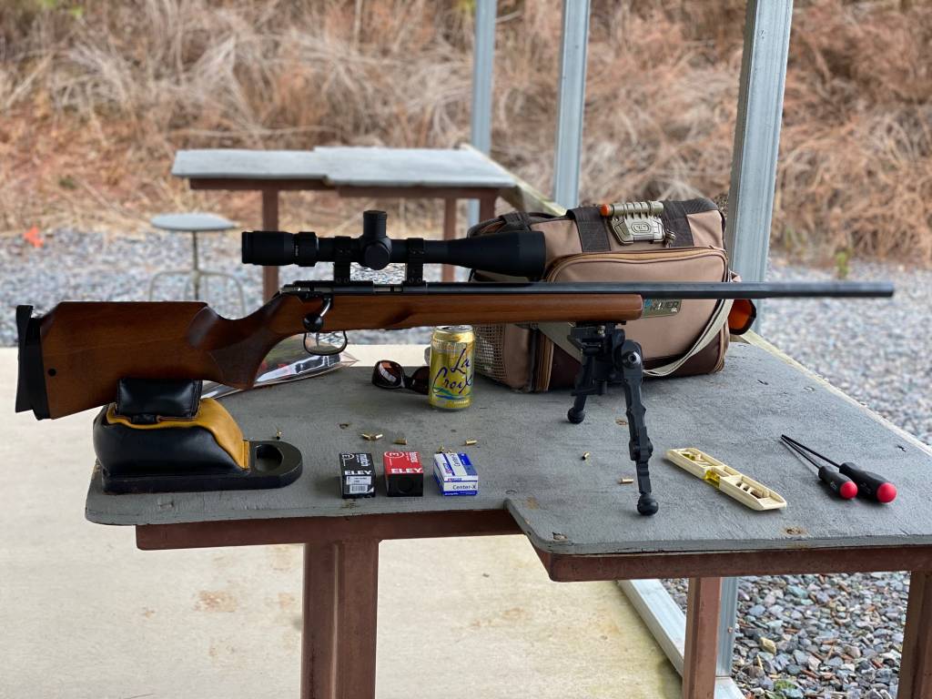

Got to my outdoor range today at 9:30, and it was cold and 40 degrees with some fog. Nobody but me at the entire range, and the wind was light at zero to 2 MPH. I had two rifles today, and wanted to test out some various .22 LR ammo with the Anschutz 64 MPR. I labeled the ammo on each of the '3' Anschutz cards that I shot, but I'm starting to like the Eley and Eley Match ammo. This rifle used to only shoot Lapua Center-X, but it did well today on all three cards.
Target Card # 3 was my best. More importantly, I discovered something that really helped my scoring. I did not realize but for a long time now, I was holding my butt stock into my shoulder much too light. I always start on the bottom row, from right to left and continue the same pattern on all rows. After a bad start with bull #'s 25, and 24; I decided to try and hold my butt stock more firmly into my shoulder. Not a death grip, just firm into my shoulder. All of a sudden, I started nailing 10's consistently. I'm not 100% sure about this being the fix, as I also used the Eley Match ammo which I know is pretty good. However, I think I am on to something here with the firm shoulder bit. I should add that I do use a good front rest and an Accu Tac BiPod. I realized that the .22 LRs do recoil a bit, and I think the light shoulder hold was hurting me.
Last card of the day was going to be with the RAW. Wind was still light, so I shot a very solid 246 with the RAW and the JSB Redesigns.

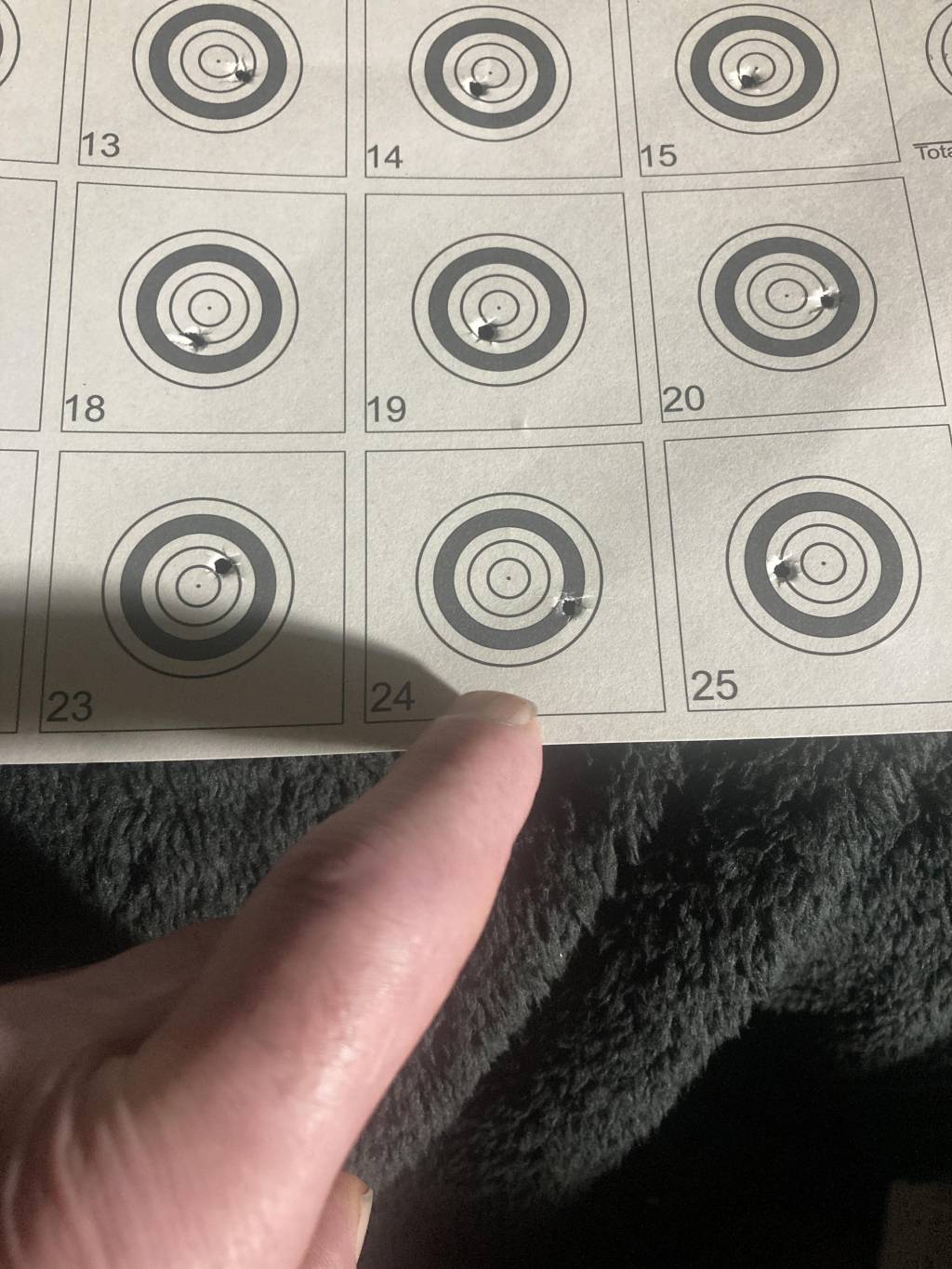

Well done Tommy! I’m also getting some random flyers that you can tell should have been better. I’ve never sorted or lubed, but stacking every advantage in your favor is a good idea, once I get more consistent at N50 I’ll definitely sort and lube. I also don’t single load and I understand that it’s more accurate to do it that way. This card was in a steady breeze that actually made it easy to read the wind. And when I shot number 24 the crosshairs were perfect and the shot was way off! Thanks for sharing your groups.

Keep in mind that 1 mph of wind will move your pellet .25 at 50y. Even with flags and a lot of experience shooting over them….it’s very difficult to see 1 mph of wind change. If you are not using flags or are not proficient in using them….you have no chance of detecting 1-2 mph wind velocity difference or angle change. You are simply shooting blind. You will get all kinds of shots that you will call flyers simply because you could not see the wind change. The game is all about seeing the wind and compensating for it. It’s also about knowing what conditions you cannot conquer consistently and having the restraint to avoid them. The latter will yield more fruit in the long run.

Some great advice given, will also add a little on the rimfire side. I let the rifle tell me what it wants as far as pressure points. You may think you have it one day and the next day not working so well so one will try another technique. What we all strive for is consistency and that's shooting a lot of rounds to get a handle of what's working.
Shoulder pressure has to be the same as well as palm swell pressure for each shot and that takes time and patience to get that feel especially in the heat of the moments. Remember you are pre-loading the bipod with how much shoulder you use. You made some great shots in a row and then wow why did that happen so the tendency is to get excited and your technique will falter by to much shoulder and to much pressure squeezed or vice versa. It is going to happen so just take a couple of deep breaths and continue on.
When I shoot factory rifles the palm swell is so critical on how you wrap your hand around it. Putting a death grip, to much downward thumb pressure all needs to be addressed. I do not wrap my thumb over that area to grip it just a nice hold, this allows the rifle to shoot nice and consistent.
