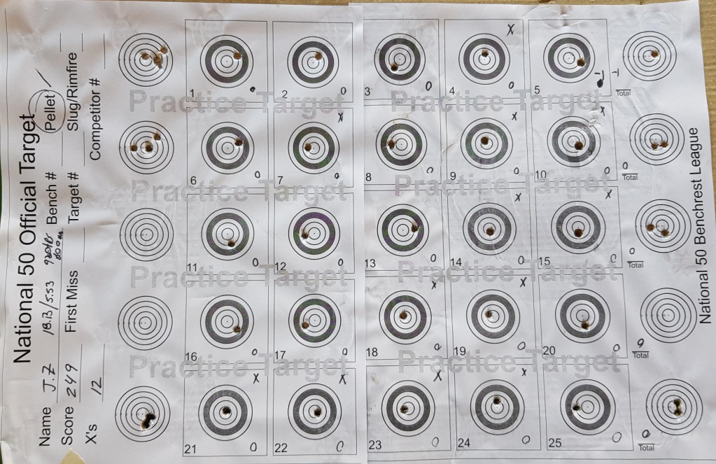

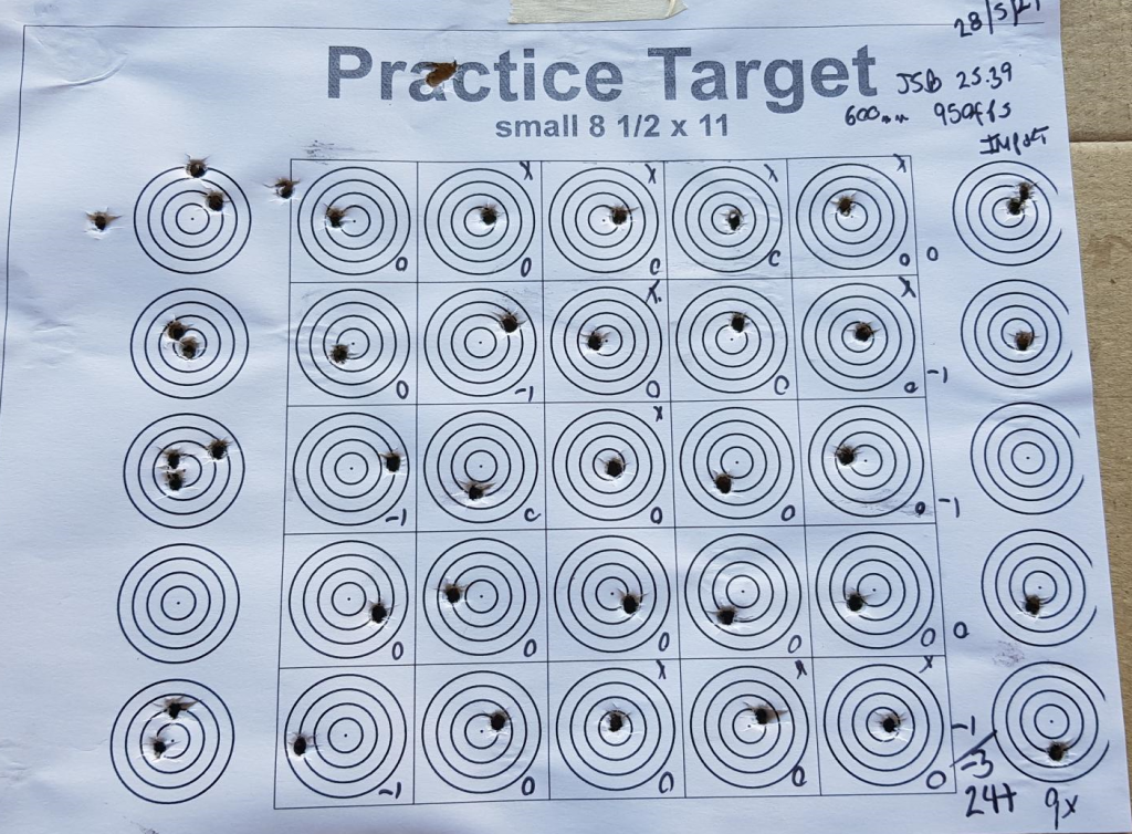

Hello:
Two targets today, one 247 with the MRD´s at 950 fps, some wind in the yard, this is my first N50 target.
The second one is 249, cero wind, with JSB 18,13 5.53 at 930 fps, same barrel, FX Superior Standar 1:24 , 600 mm
I dealt with the 23g NSA slugs, very bad with this barrel, many flyres, I didn't even hit a target anymore
I already bought a 600 mm barrel for slugs (superior Heavy liner, twist rate 1:16)
Sorry for the quality of the targuets I printed them on a very thin paper and glued them to a box of pizza .... lol
Jorge
