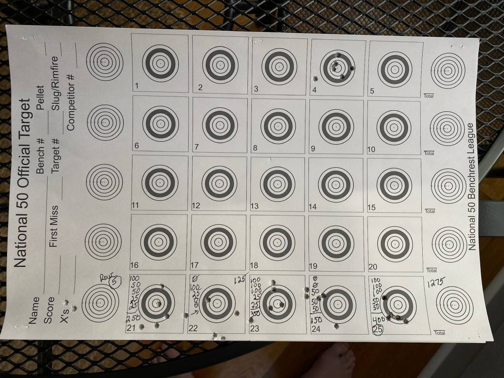

Went to the 100 yard range today. Had 2 Wicks flags deployed. Ver windy. I sucked at my first attempt at this new challenge.
If I feel brave, I may post tomorrow. I was very disappointed.
Have to gather my thoughts.
Tom
OK, scored my cards. I used the Red Wolf Safari .22 HP ( just cleaned barrel ) and with JSB 25g KO's.
I shot two rows; a 1275 and a 1300. The bottom rows on each card, and I did shoot a practice row and another row I 'forgot' to finish. Would not make a difference, very poor showing. I need to try this in a light wind day, and this was not the day. I could not get a handle on my holds, even though I did have both a near flag deployed and another flag around 75 yards. Interesting, on the GTA forum, I have shot some 50/50 3X and 4X cards before at 100 yards with the Red Wolf, but I could not hit anything today. I had one good bull with a 400 score, but everything else was awful. I like the challenge Mike, so I will try again to redeem myself.
There was a guy from Russia next to me with an AR-15 scratching his head and trying to figure out what I was doing. We made friends quickly, as he was very curious about air guns in general and we talked for about 30 minutes. He did not know Nicolai ( sp ), but I told him he is revered in the Bench Rest arena.

Thanks for posting Tommy. All in all, it’s just a lot tougher to get a high score on this….so I don’t think you did bad. To get a 500 on any box you have to be no further than about 1/2 moa from center for each shot….so basically 1 Moa centered.

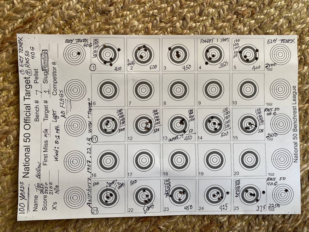

I went to my local outdoor range this morning. Weather Channel said 5 mph wind, but when I got at my bench there was nothing noticeable. Flags were still, so I got out the Kestrel for about 5 minutes a few feet in front of my bench and it was 0-.5mph or no wind. I decided to go without flags, since I was shooting the 1907 Anschutz .22 LR today. Weather was perfect; 45 degrees when I started at 9:15 and 57 degrees when I finished at 11:25am. Have two more boxes of R50 40g ammo left, so I posted my "In the rings" SLUG challenge cards at 100 yards.
I shot three rows on the card, starting at the bottom and working my way up to the top row. Bottom and middle rows were shot with RWS50 and the top row shot with Eley Tenex ( red box).
Row 21 - I shoot from right to left and could not figure out how I missed the first two bulls with one shot out of the five shots for each target bull. I did figure it out on #'s 21, 22 and 23 bulls. Shot a 2250.
Row 11 - Next row was also with RWS 50 and this time I shot a 2450. Came close to a 2500, but on bull #13 my shot touched the outer ring. No complaints, very happy.
Row 1- This was the last row I shot today, and I switched and sighted in the Eley Tenex 40G. It did shoot well, but not as good as the RWS50. Shot a 2100 on this row.
The Anschutz 1907 (54 Action )is a custom .22 LR with my Tuner dialed in the way I like it. ( Pro Class ).
I will eventually get the other Anschutz .22 LR 64 MPR ( 64 Action - Sportsman Class, no Tuner ) and shoot it at 100 yards. It will not do as well, but I expect it will be decent.
Given my two Daystate Safari .22 HP first attempts ( 1275 and 1300 ), I am pretty sure I could not get this close with either that gun or the RAW HM1000x HP .22.
I have not shot either Anschutz at 100 yards for over a year, so this was the 'pick' day of the week with little/no wind present.
